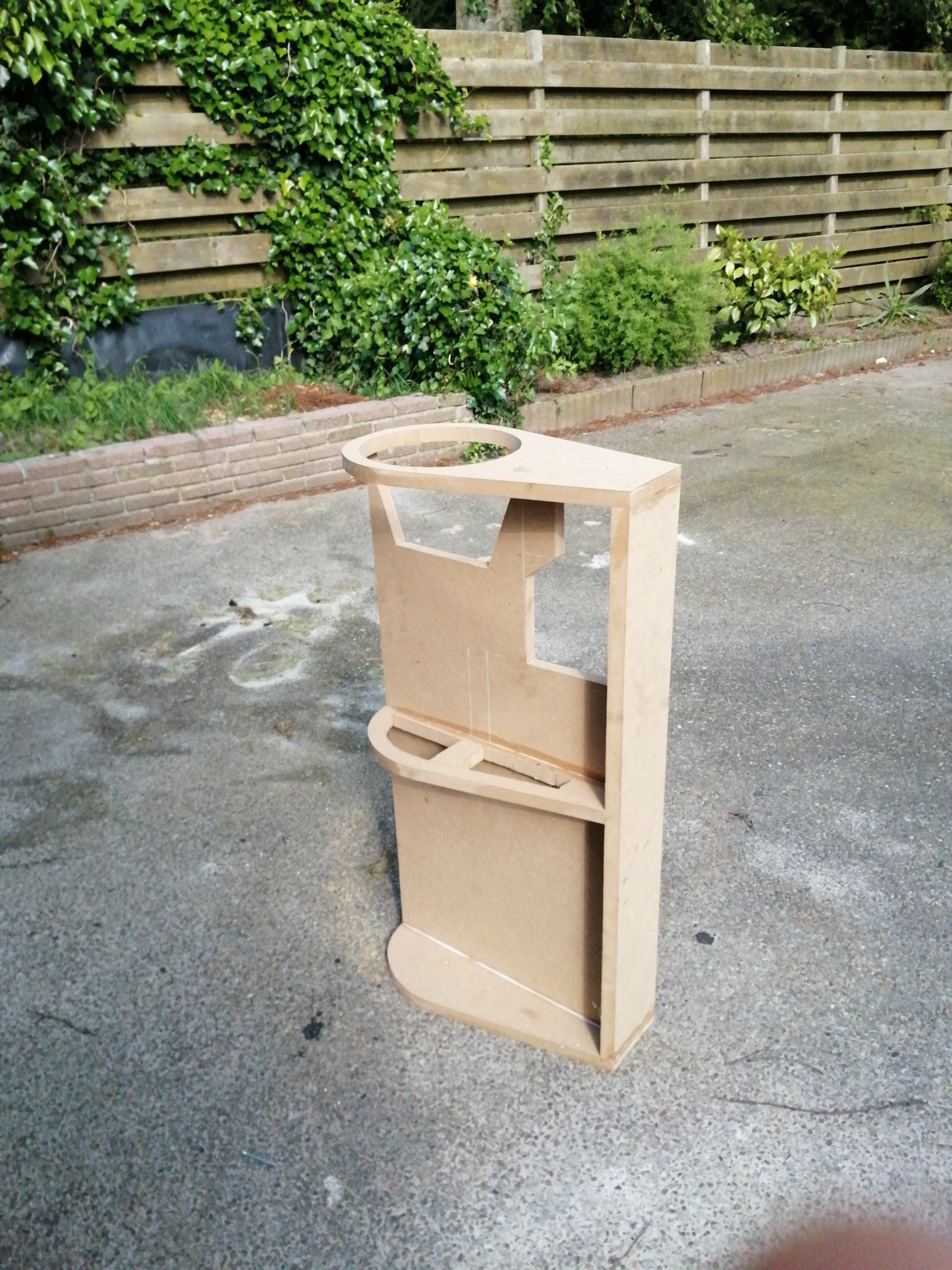

Welcome to this thread about the speakers i'm currently building.
This is my second speaker design/build that i have done.
The goals of the build are as follows:
which one should i do?
speakers from top to bottom:
Dayton Audio Reference RS225-8 Bass-midwoofer
Dayton Audio DC28F-8 1-1/8'' Silk Dome Tweeter
Dayton Audio PC105-8 4" full range woofer
- High Wife Acceptance Factor.
- Should not look like a dull ordinary box.
- Have a nice flat frequency response.
- passive crossover
- active crossover
- active system with 6 amps and DSP as a crossover

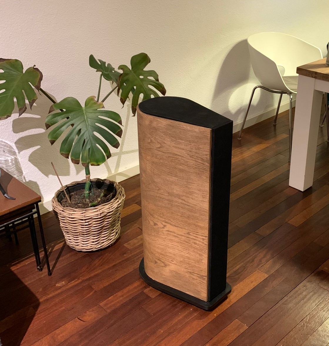

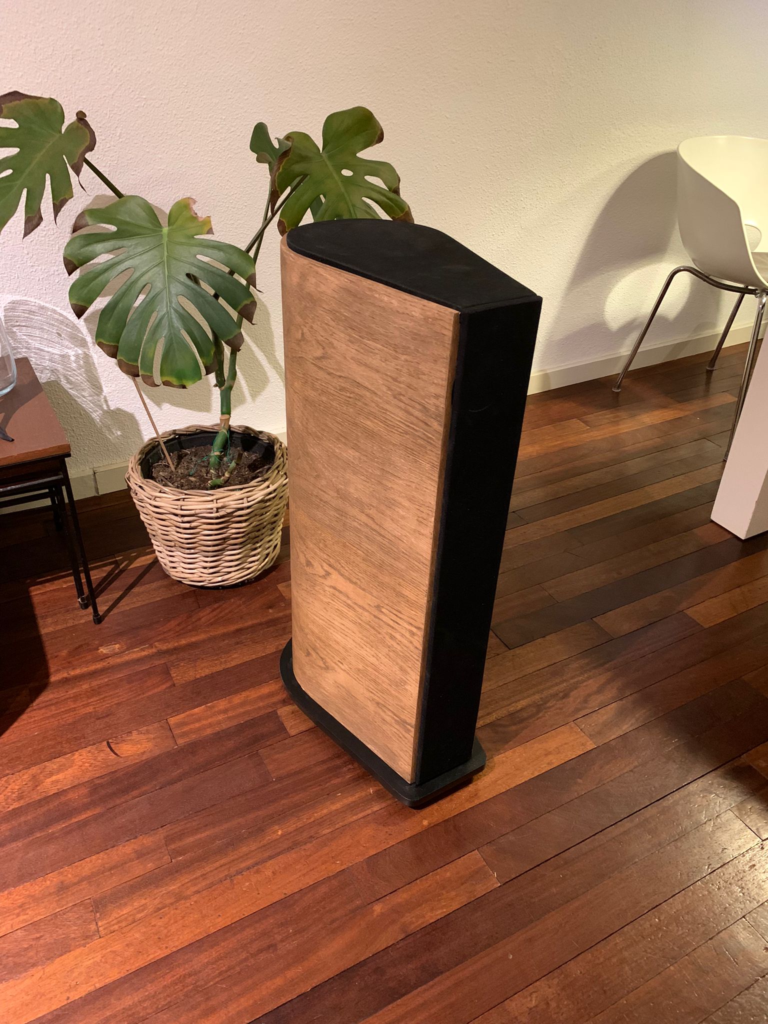

Looks great!

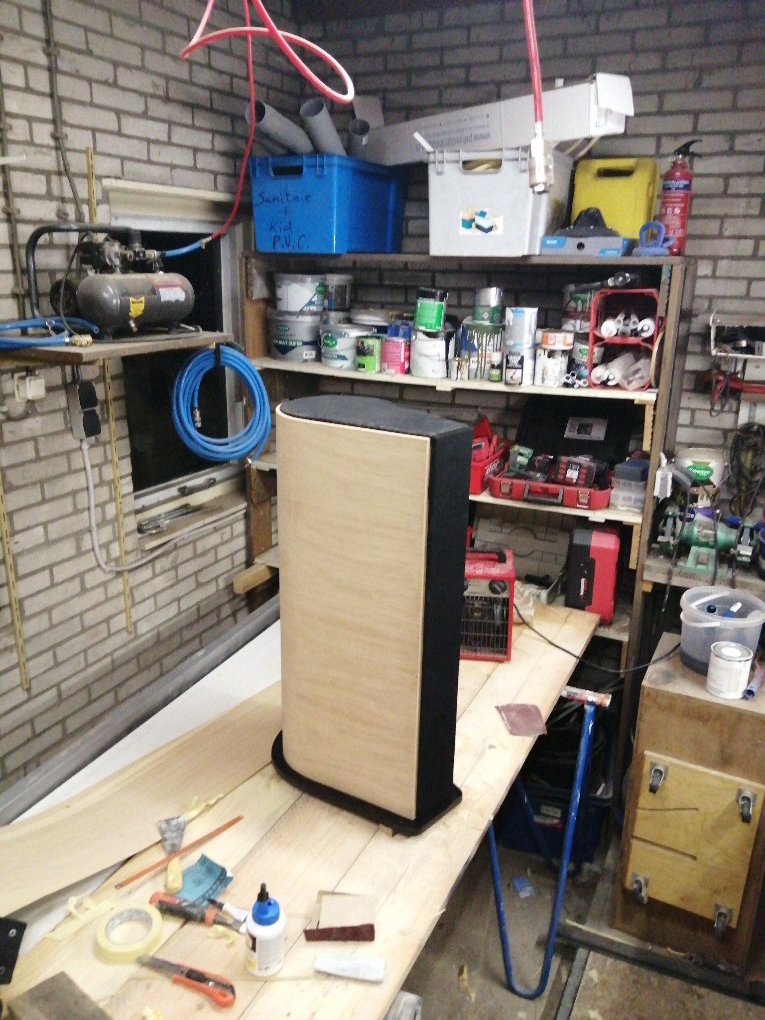

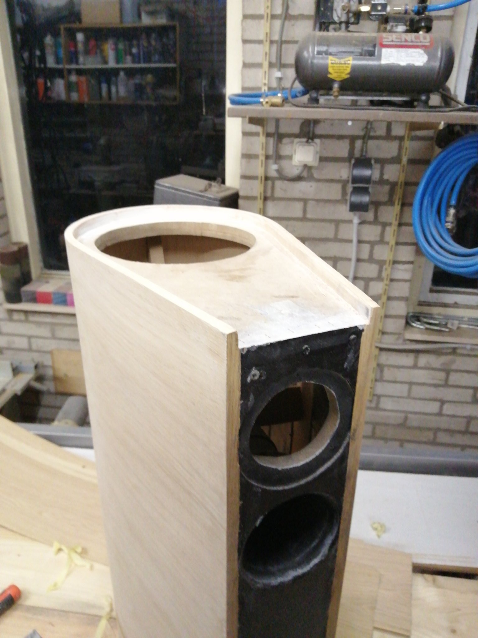

How did you bend the wood so tightly and what sort of wood did you use?
For the materials i used 3 layers of 3 mm 3-layer plywood.
The bending was the hardest part of the build. bending by hand was tough, because i only have two hands and the wood was pretty stiff.
I soaked the part that gets bend (the middels part of the plywood sheet) in hot water. Then used my moms hot iron to "steam bend" the layer around the frame with glue between the layer and the frame. I held the layer in place with a lot of screws, temporarily, so i can remove them before applying the next layer. Then i did the other two layers the same way but with wood glue in between and drying after every layer for a few days.

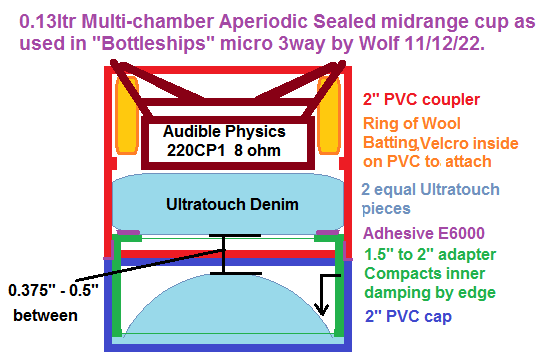

I used the PC105-4 In a build and found it benefitted from multichambered aperiodic damping. This reduced the Q at Fs, and allowed the midrange to be much improved. It was simply 1ltr per side, and vented through open cell foam between the 2 chambers. Funny enough, I used pegboard for the barriers with foam between and called it the ice cream sandwich alignment.
Not that you can easily implement that now, just thought it could be useful.

I can still implement it! the black bottom is not connected yet. But i don't know if balancing a woofer by buying another pair relative expensive woofers is the right way to go. I don't need the SPL. The only reason this build is a 3-way is that the RS225 in the top gets directional before the tweeter can play those frequencies. Maybe there is another catch that i missed.With the woofer position and cab shape, I'd have been tempted to have a matching woofer on the bottom too to isolate cabinet vibration, but likely too late for that as well.
Sounds like a great solution! Gaining some lower frequencies with a bigger box while retaining the damping from the smaller first chamber for the higher frequencies. Implementing it is probably not possible in this situation or really difficult.I used the PC105-4 In a build and found it benefitted from multichambered aperiodic damping. This reduced the Q at Fs, and allowed the midrange to be much improved. It was simply 1ltr per side, and vented through open cell foam between the 2 chambers.

Regarding the mid: now thinking of it, i'm going to do some calculations on the multichambered aperiodic damping. I don't know what the minimum chamber size is. There is a chamber of i think 600 mL in the box atm.
If that 600mL is the case, go 2/3 to 1/3 volume (400:200), placing the driver in the larger volume. Stuff driver chamber loosely, foam cover the entrance to the second. Line the rear chamber, or leave it empty. Felt lining the rear chamber would be thin and work well.
My logic here is that it is not going to play low, and you need the volume for the driver chamber. Typically 1:1 or 60%:30% works well. Any smaller the rear chamber is than this precludes too much benefit.
Lastly, take measurements of the impedance as you make changes to the setup. The one with the lowest impedance freq spike and most reduced magnitude is the most effective. It sometimes can look like a double spike as in vented systems, and the reduction over both spikes is better if possible. However, If all you can seem to reduce is the higher peak, go with that one.
Here is an example how I did one in the Bottleships build....
