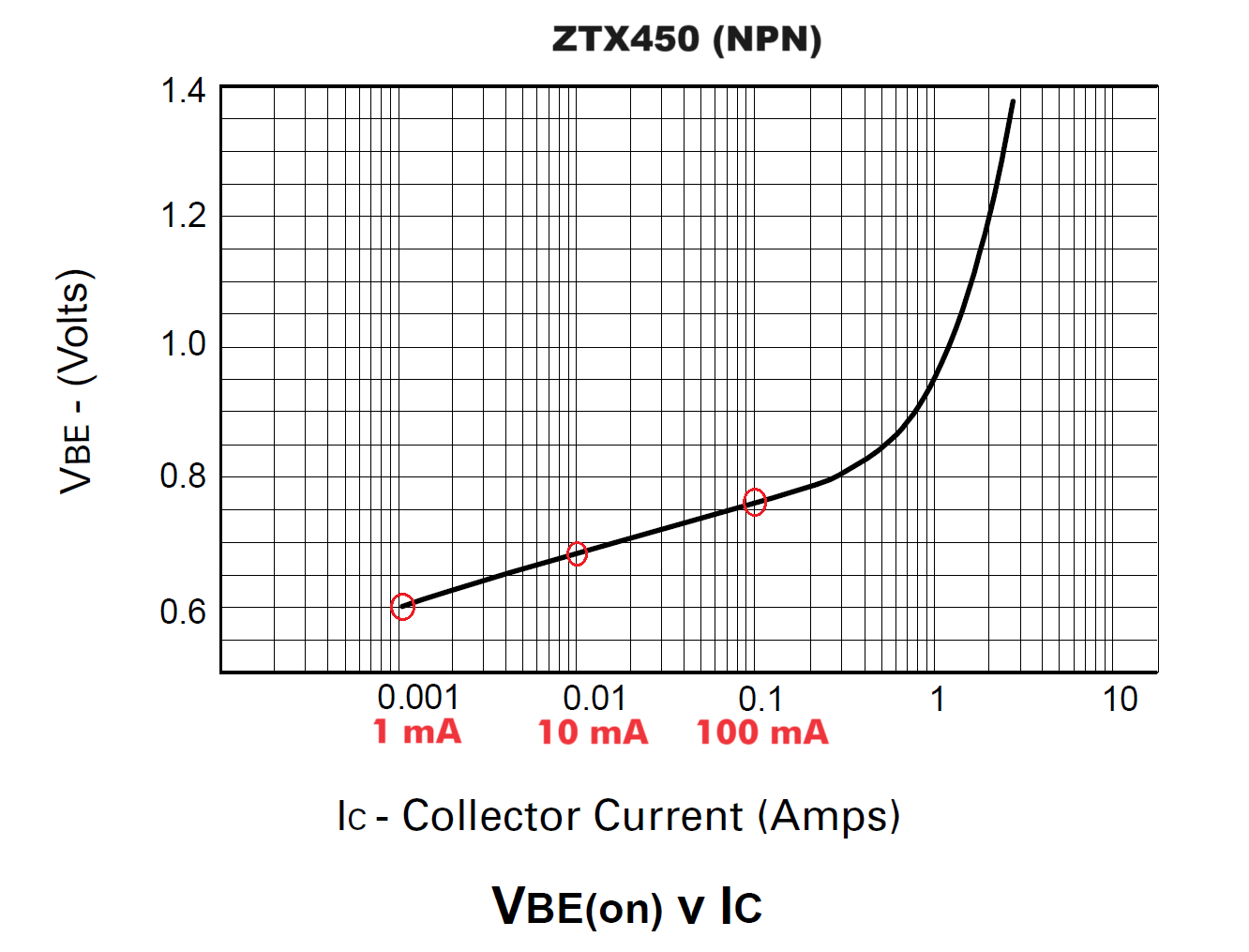

The transistor datasheet usually includes a plot of Vbe versus Icollector at room temperature.
For example, the bipolar transistor which Nelson Pass often uses in his current sources is a DiodesInc / Zetex ZTX450. I've attached the relevant curve from its datasheet, below.
As you can see, Vbe varies with Icollector. (Vbe = 0.60V @ Icollector = 1mA) and also (Vbe = 0.67V @ Icollector = 10mA) and also (Vbe = 0.76V @ Icollector = 100mA)
So the thing to do, is (A) choose your transistor type; then (B) grab the Vbe-versus-Icollector curve from its datasheet; and finally (C) read off Vbe at your desired Icollector. And Bob's your uncle.
