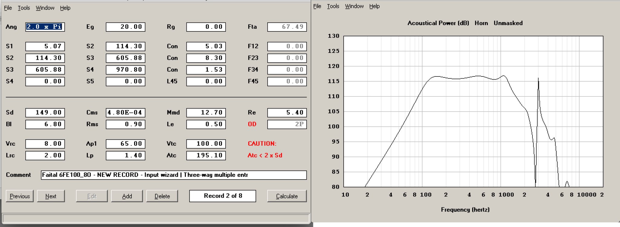

Hornresp is a fantastic tool for modeling speakers, big thanks to David McBean for his contributions! After countless evenings testing various drivers and parameters, I settled on the following components:
Compression Driver - FaitalPRO HF108 (8Ω) I chose it because it works well in short horns and wide dispersion waveguides and people seem to like it a lot. The recommended crossover is 1300 Hz, which is what I’ll go with in my design.
Midrange - 2x FaitalPRO 4FE35 (8Ω) in parallel - they simulated well in Hornresp and have been used in some MEH builds before.
Hornresp parameters

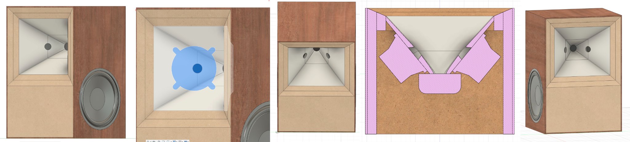

3d printed horn
The inner section of the horn (shown in light grey in the 3D rendering) will be 3D-printed, while the outer flare will be constructed from 2 sheets of 19mm MDF with a dispersion angle of 130 degrees
The HF108 compression driver has a 31-degree exit angle, so the horn starts with a matching 31-degree angle and gradually transitions to an 80-degree angle at the midrange entry point.
To minimize unexpected cancellation notches, the inner corners of the horn are smoothed with 2mm rounded edges.

However, when I model it in Hornresp, the cancellation notch appears well above 1300 Hz, and the mids start to roll off around 2000 Hz. I can increase the distances well above 6.6 cm before I get the cancelation notch near 1300 Hz. I’m not sure if I’ve missed something in my calculations and the measurements may differ when I measure the build speakers.

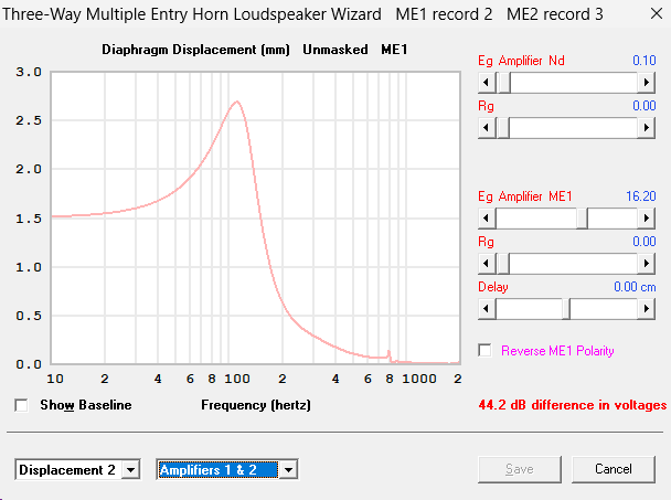

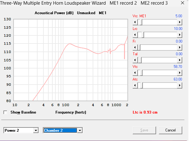

Mid driver Vrc:
I made the Vrc (closed rear chamber volume) fairly small 2 L in total (1L per driver). I still haven’t figured out how I will limit the chamber volume. Using tubes like those in the Cosynes would be challenging due to the distance between the mids and the compression driver.
Mid driver Vtc:
I didn’t feel like I needed to minimize the Vtc (throat chamber volume) as the mids can play high enough frequency already. Making it smaller using cone plugs seems more beneficial with bigger woofers (like on the SynTripPs) and also the B&C 4NDF34 which have been used in some designs. For now I’ve estimated 50cc per driver, but will measure the volume when I receive them. I might adjust the sizing after doing the final calculations with the correct volume.

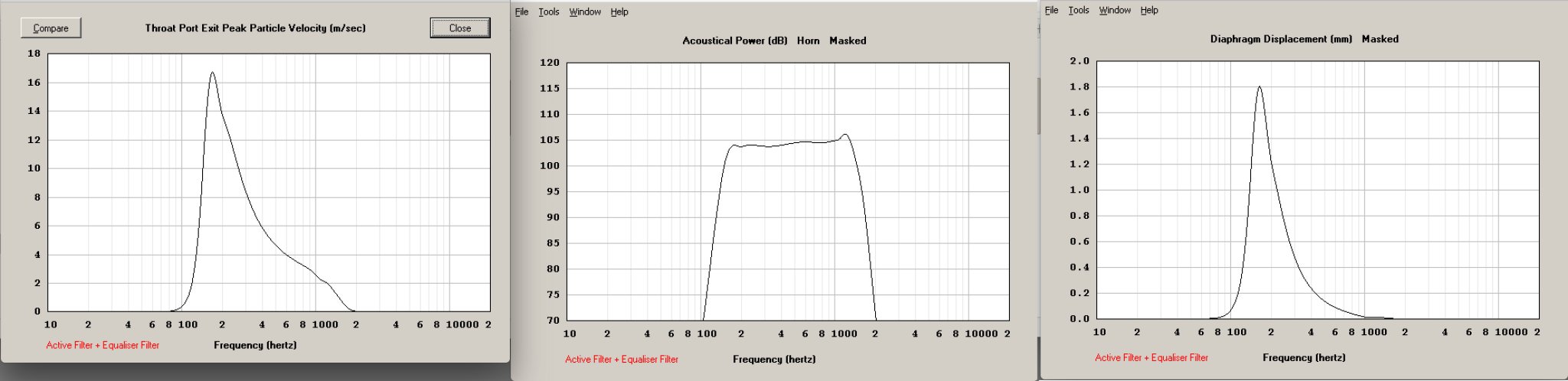

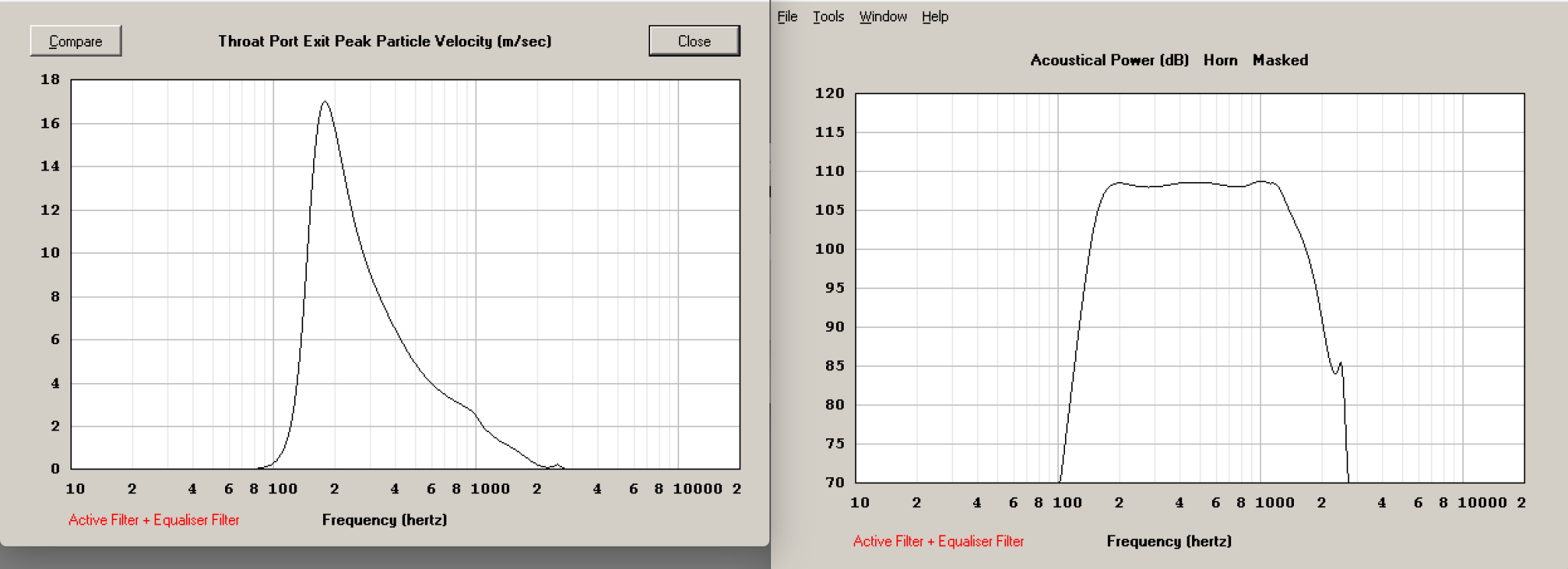

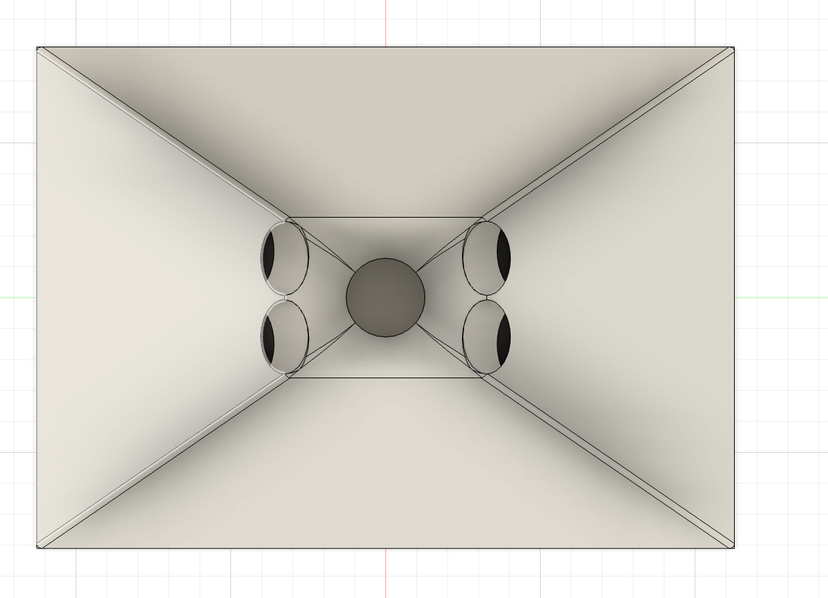

Mid driver port size:
There are 2 entry ports per driver, 4 in total. The entry points are frustrumised, 2.76 cm in diameter closest to the driver and 1.95 on the inside of the horn, which translate to Ap1 of 24 cm² and Ap2 of 12 cm².
The ports are relatively small, with port velocity exceeding 17 m/s when played above 105 dB below 200 Hz. These are meant for home hi-fi use, so I don’t plan to play them too loud. I also don’t want to make them too big, so they affect the CD’s output. The ports are placed next to the corners to minimise the effect they have on the CD.
Vertical drivers:
This is something I haven’t seen mentioned often, and it seems to be overlooked in many MEH designs. I will place all the drivers vertically, on the side walls of the horn, to avoid driver sag.

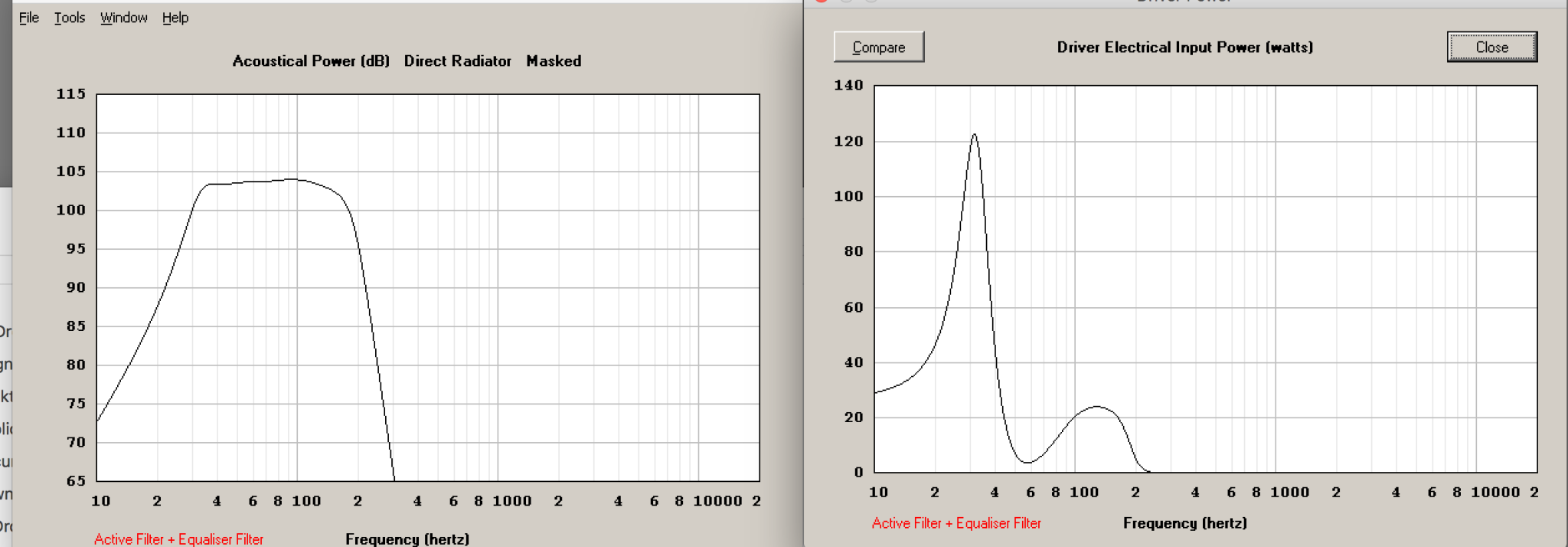

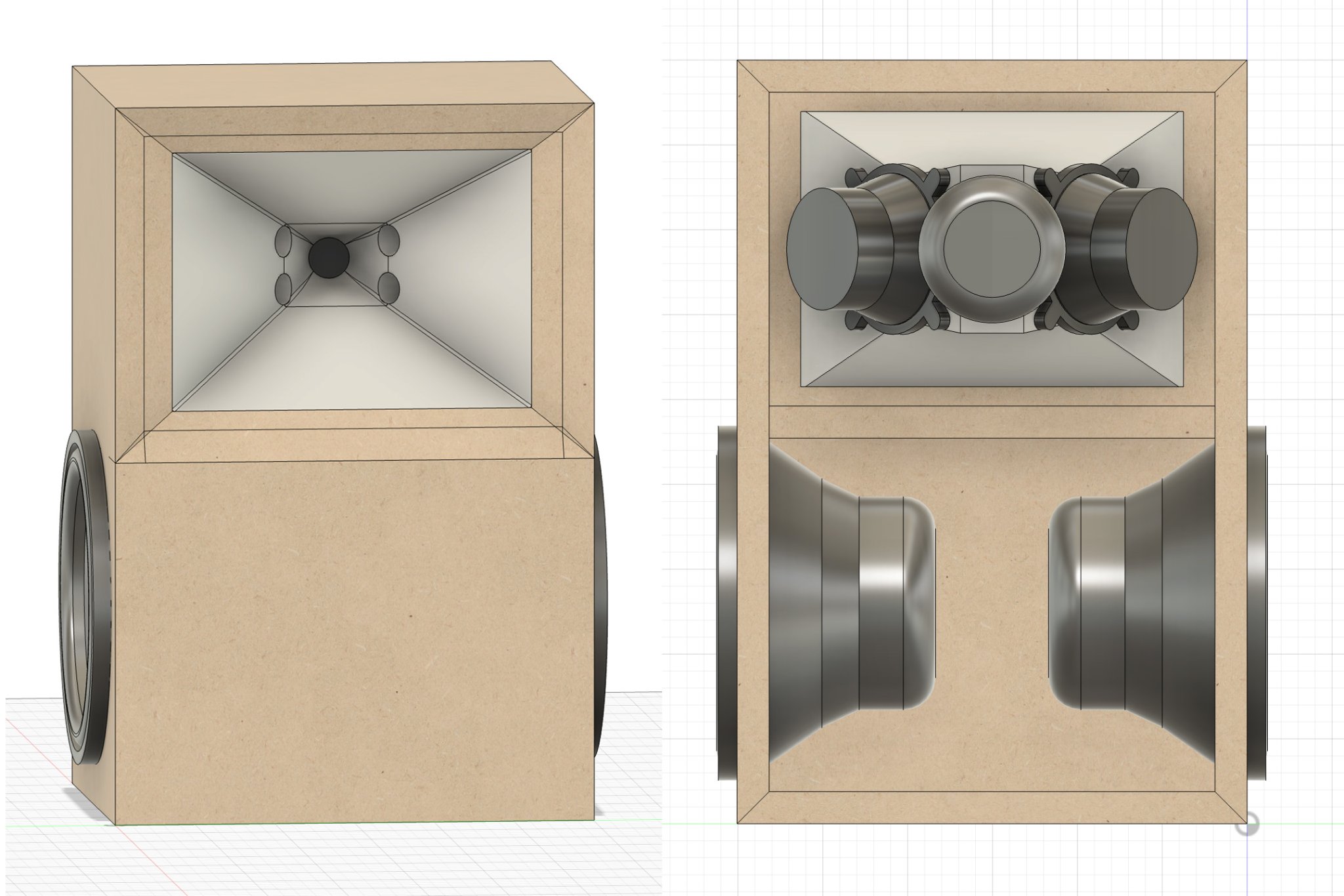

I’ve been exploring the idea of side-firing 8” subwoofers.
I’ve sketched a design that fits the size requirements. The outer dimensions of the cabinet are 45 x 30 x 26 cm. The internal box volume is ca 15L, which is around 1/2 to 1/3 of the recommended box size for the subs.
As I understand it (please correct me if I’m wrong), it’s okay to make a sealed subwoofer smaller than the recommended size, but the sub will need more EQ and power to handle the lows. That shouldn’t be a big issue since I’ll be using an active crossover. The subwoofer requires 120W at 2 ohms to reach its Xmax at ca 30hz at ca 100 dB, so an amp like Fosi ZA3 should be able to drive them
At the moment, I’m considering the GRS 8SW-4HE-8 subwoofer but I am open to other suggestions.
Will this subwoofer implementation work or will it sound bad? Are there any other options I should consider for better results?

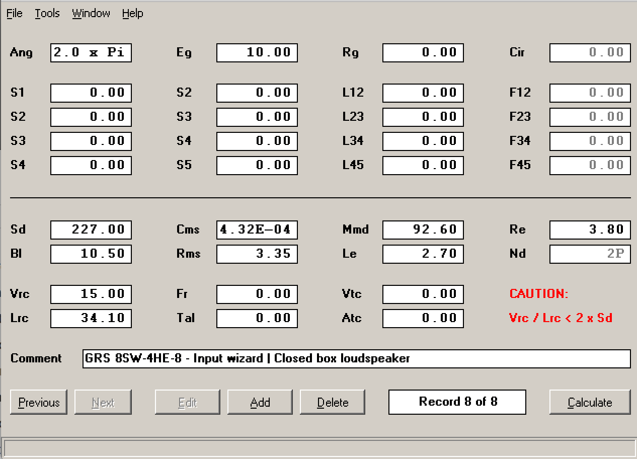

Here is the Hornresp simulation where the driver reaches xmax at ca 30hz, with some EQ and a low-pass filter:
The gradual transition will decrease the Fc compared to the usual conical expansion, but will limit the dispersion to the horn wall angle above around the wavelength of the transition length, making a "beamy" horn.The HF108 compression driver has a 31-degree exit angle, so the horn starts with a matching 31-degree angle and gradually transitions to an 80-degree angle at the midrange entry point.
Basically, the point you can visually see the center of the HF driver's throat is around the -6dB off axis point.
It should sound OK if you can keep the acoustical crossover at or below 200Hz, and the box is not too close to the room side walls.Will this subwoofer implementation work or will it sound bad? Are there any other options I should consider for better results?
At only 45 centimeters tall, the cabinets will require stands to get them up near ear-level.
I'd think you'd want to use the volume below to increase the enclosure volume, requiring less power to reach Xmax and lowering the box resonance.

I think using just two 4fe35's is going to leave the design a bit out of balance. I think that is going to leave your mid range weak, and make it difficult to reach down to your subs adequately.
My vote would be to either use 4 of them, or size up to two 5"s or something.
(Also wouldn't worry at all about horizontal mounting or drivers this small. I don't think cone sag is a real issue until about 15" or greater.)
I know you're planning on lowish SPL...but even with that, I think just two of the 4" are going to disappoint...

Considering the two 4" could play ~10 dB louder at 190 Hz than the 2x 8" at 30Hz, does not sound like it would disappoint.I know you're planning on lowish SPL...but even with that, I think just two of the 4" are going to disappoint...
I listened to my single one cubic foot MEH "boat horn" crossed at 165Hz using four 4” BC 4NDF34-8 with three 4x18" EV MTL-4 outdoors at 20meters away and it sounded OK.
That said, going to a pair of 5" would add around 4dB headroom, even at the same excursion as the 4FE345, and 5" can be had with a lot more excursion.

As part of my own planning, I simulated a single 4fe35 as midrange in a MEH. In my situation (which may not be yours) the excursion chart showed it hitting x-max below about 150Hz:
limiting it to this maximum axoustical power:
However, I personally plan to cross the 4FE35s over at about 300hz so they would never see that excursion peak, and I could in theory play them much louder (assuming thermal limits or power compression don't interfere). Your situation my differ in crossover frequency if you have no bass drivers though; as you can see it is the lower frequencies where small cones need large xmax.

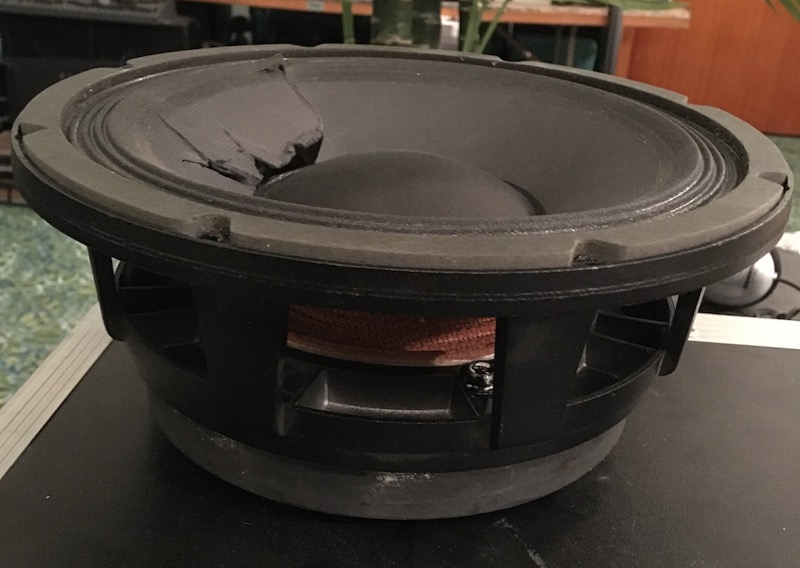

I've noticed at least 2mm cone sag on a lightweight 8" horizontally woofer, probably half it's Xmax.
Cone sag definitely was a problem on the upper EVDL10X 10" mid drivers used horizontally in Craig Hauber's EV MTH cabinets:
The sagging cone was torn after it hammered the phase plug.
https://forums.prosoundweb.com/index.php/topic,176835.0.html
Anyway, if enough clearance for Xlim is allowed for, cone destruction won't follow cone sag, but distortion will.

First of all, thank you for the responses, I really appreciate the input! I’m a bit in awe getting feedback from all of you MEH experts.
Good point! A beamy horn might not be ideal. So I guess it's best to adjust the gradual transition to a conical one, the standard conical MEH horn seems like the best option.
In the previous design, the distance between the CD’s exit and the plane of the mid-entry ports (L12), is 4.28 cm. If I make it 2.55 cm, like the Synergy Spreadsheet suggests, then the horn has a constant angle of 80 degrees from the throat to the beginning of the 2nd flare. It’ll also have a gradual transition from circle to rectangle between the horn throat and S2 (mid-entry point plane).
My question is, will the transition from circular to rectangular over the entire 2.55 cm distance have any negative effect? Would it be better to make a shorter transition, similar to the throat adapter in the SynTripP (which I believe is 1/2")?
The cabinets are meant to be placed on a TV bench which is 68 cm tall. A floor-standing design would be much more ideal but then would go into the category of "big speakers" which my partner wouldn't be too happy about.
The nearest side wall is 1.6m away. And the tv bench is close to the wall behind the TV. Is this going to cause an issue?

Here is hornresp sim with some EQ, highpass att 150hz and lowpass filter at 1300hz. SPL at around 103 dB, the port velocity at 17m/s, displacement at 1.8 (xmax is 2.7). This matches the sub output from the previous post pretty well.
If I increase the port area to 18mm I can reach xmax of 2.7 without exceeding 17m/s port velocity. However, that's pretty big and the circular ports take up almost all the space of the side walls. I could make the port elongated like the SynTripP and Scott Hinsons MEH, but not sure what I gain or loose by doing that.
the horn with 18mm port area

Writing this got me curious to do some more Hornresp sims. So I tried a quick sim with the 2x6FE100 placed further out the horn so it would crossover to CD like BMS4550 around 800hz. This is output at xmax and 17m/s mid tap port velocity. The question is, is this going to be any better? I still have chance to return the drivers and order different ones. Again this is for home hifi use so I don't need this much SPL.

If the transition from circle to rectangle is only ~25.5mm, it probably won't "beam".My question is, will the transition from circular to rectangular over the entire 2.55 cm distance have any negative effect? Would it be better to make a shorter transition, similar to the throat adapter in the SynTripP (which I believe is 1/2")?
It would be easier to answer that if you could provide a picture of the throat transition.

Looks like those ports are overly large.Here is hornresp sim with some EQ, highpass att 150hz and lowpass filter at 1300hz. SPL at around 103 dB, the port velocity at 17m/s, displacement at 1.8 (xmax is 2.7).
I don't think you need to worry about port velocity as much as their throat disturbance to the HF.

It's a trade off.So I tried a quick sim with the 2x6FE100 ...The question is, is this going to be any better? I still have chance to return the drivers and order different ones. Again this is for home hifi use so I don't need this much SPL.
The higher crossover the 4" would allow may sound slightly better and reduce IM distortion in the HF, while the 6" lower crossover would reduce IM distortion in the LF, but increase it in HF.
That said, with the SPL of your woofers being fairly low, I'd use what you have.

I’ve made some changes to the design based on your suggestions. Now, there is only one midport per woofer, which I’m positioning as close to the center of the woofer as possible (woofer in blue on the picture below). I’ve stopped worrying about port velocity, so I made it smaller (8 cm² in total area). The port holes are now further away from each other, 90mm. I'm open to using a lower crossover than 1300hz, aiming for ca 1000hz.
The horn currently has an 85x75 dispersion, with a slightly lengthened L12—4.2 cm instead of the 3.68 cm recommended by the Synergy spreadsheet.
I feel like I still have so much to learn about horn design. I’m curious to explore ATH and ABEC AKABAK, but unfortunately, it doesn’t work with Wine on macOS, and I don’t have access to a Windows computer at the moment. Hornresp however, works fine with Wine on mac. I’m not sure what I’d gain by doing more work on the horn design, or if I should wing it, build the first test cabinet, and refine it from there.
I’m also working on the aesthetic side, adding a 4mm layer of mahogany plywood to the sides of the cabinet. The MDF and the 3D-printed horn will be painted, but I haven’t decided on the color yet.
