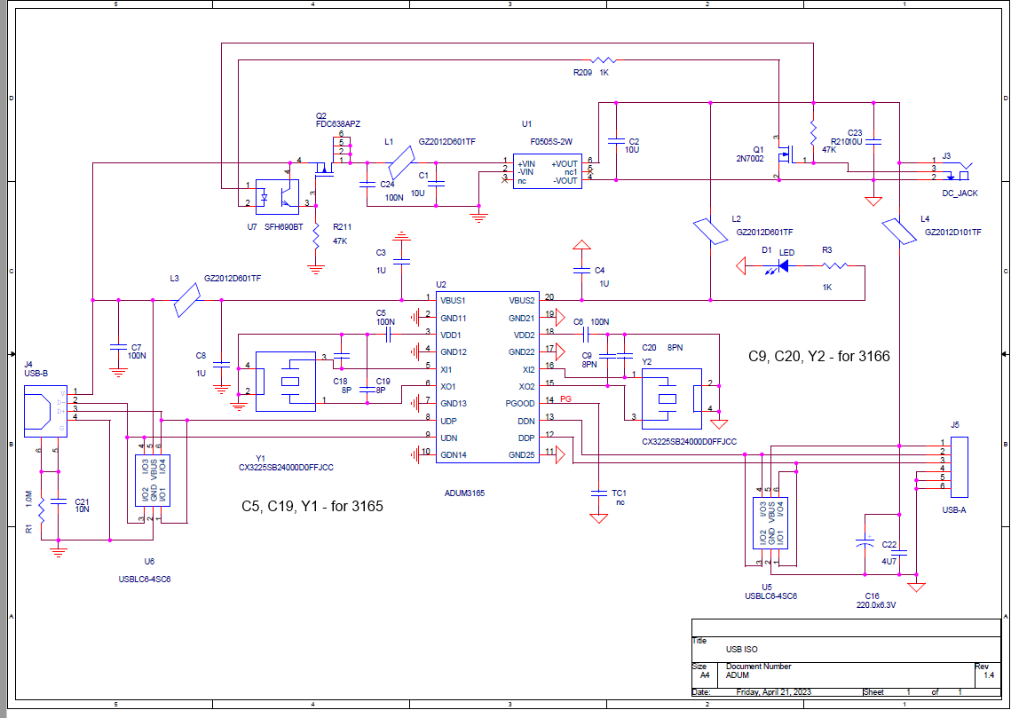

Schematic? Or is this a commercial product?
My product is also commercial, but I can share schematic 🙂
It is with 3165/66, but for 4165/66 it will be the same (just the crystal position).

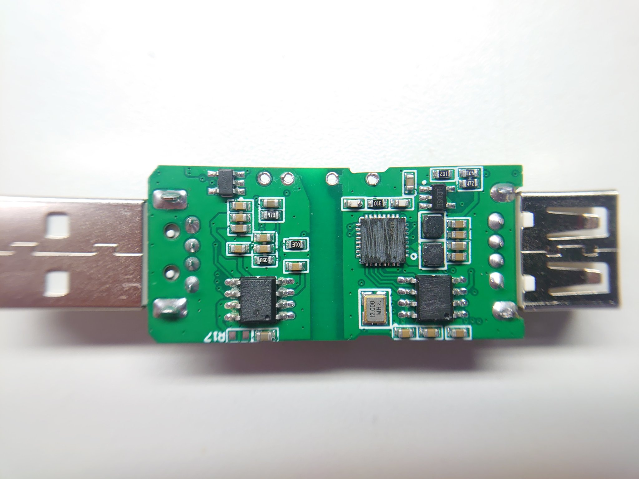

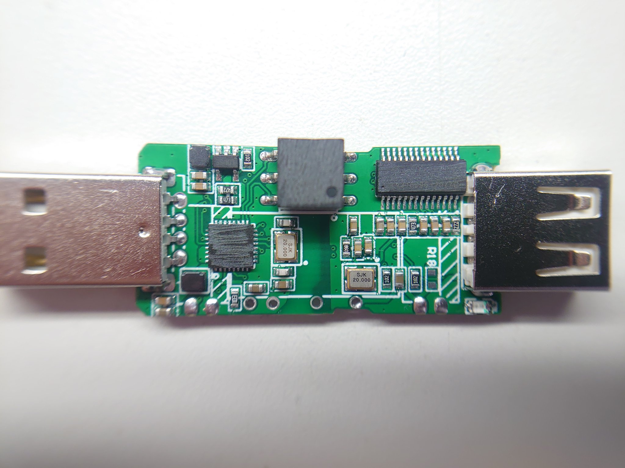

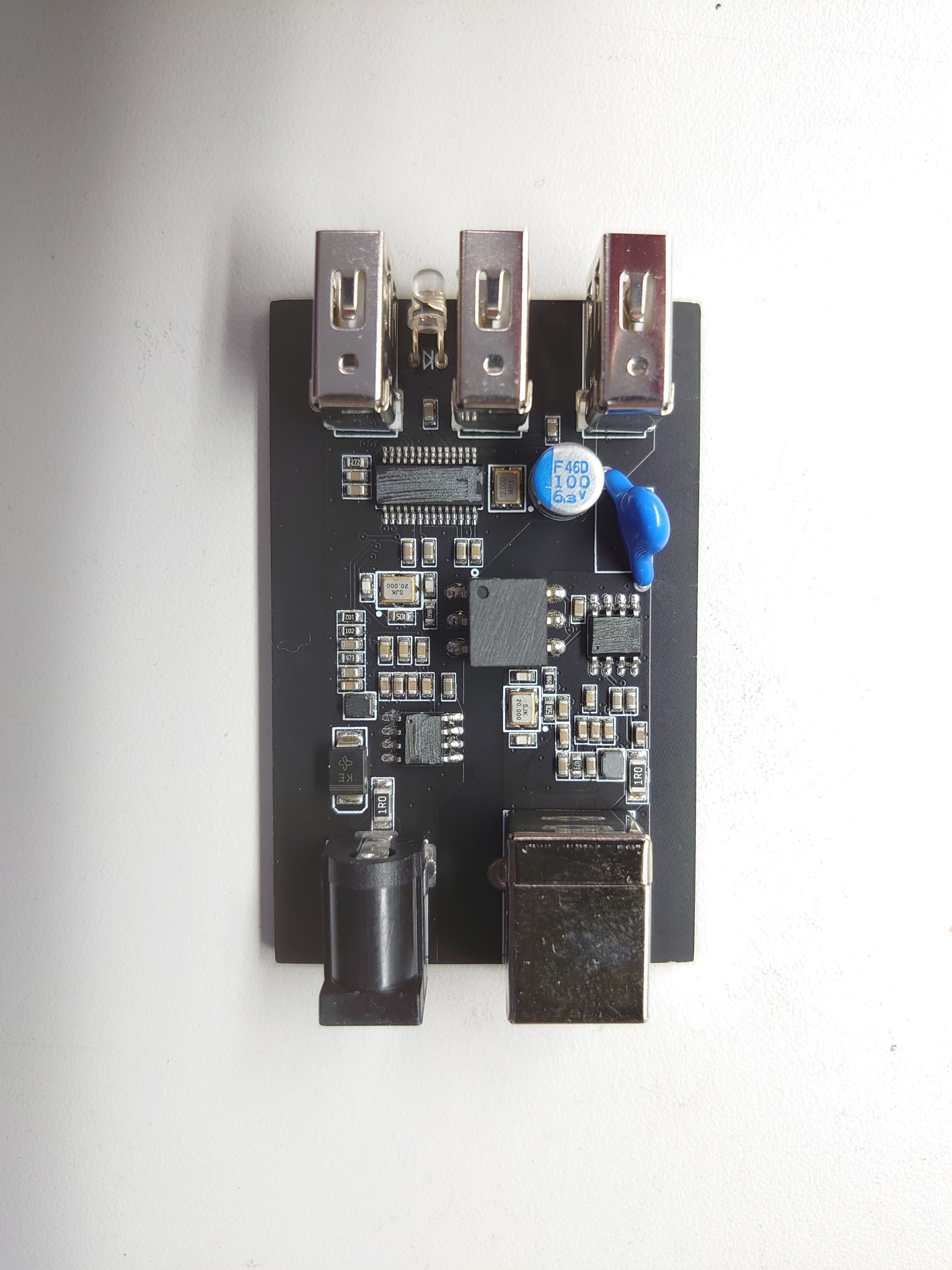

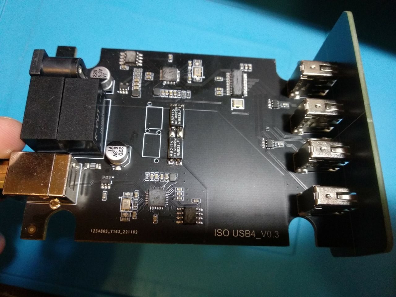

The two last are made on discretes components.
Schematics are pretty the same. FPGA - transformer - FPGA - USB hub. Hub always run at hi speed (480 mbps) so this is simple to communicate with it via isolator.
With best regards.
Hellо!Hello!
With best regards.

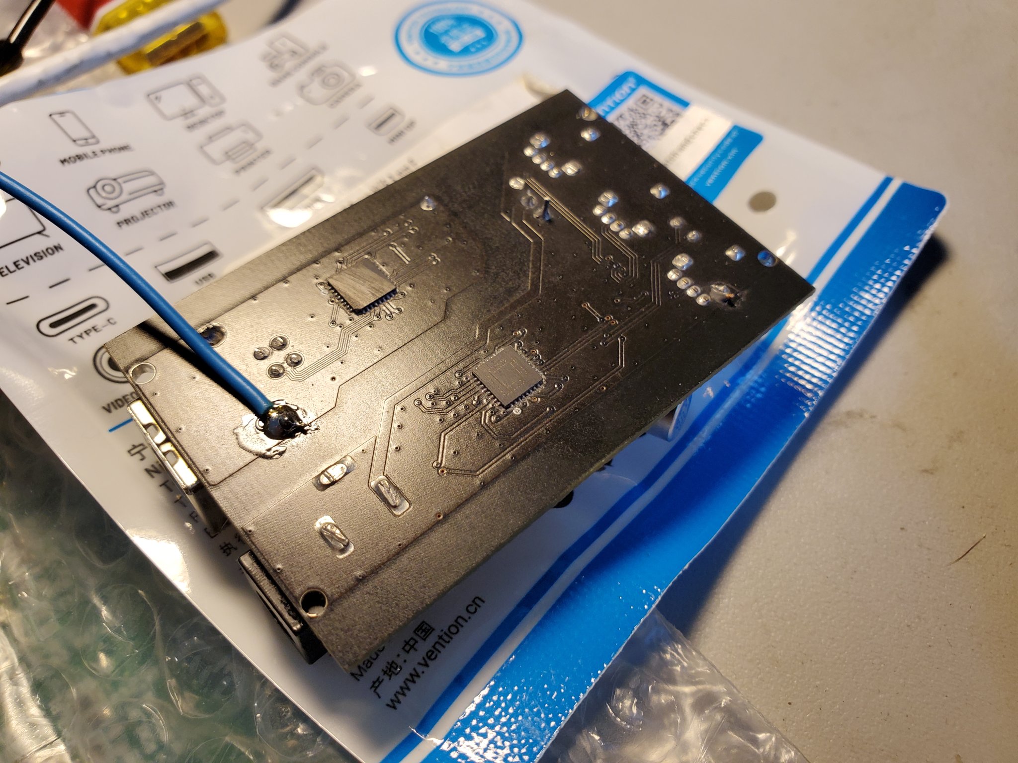

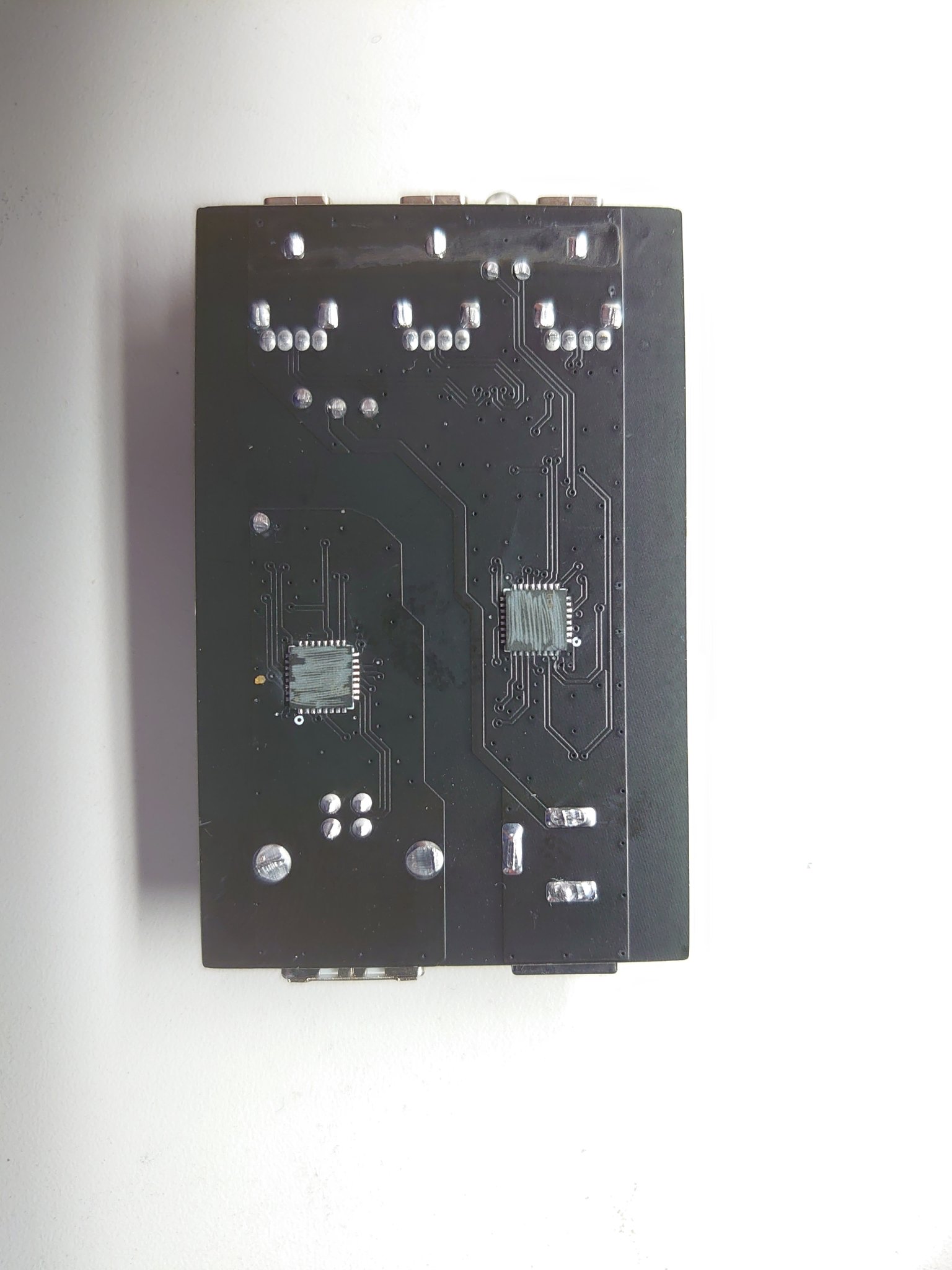

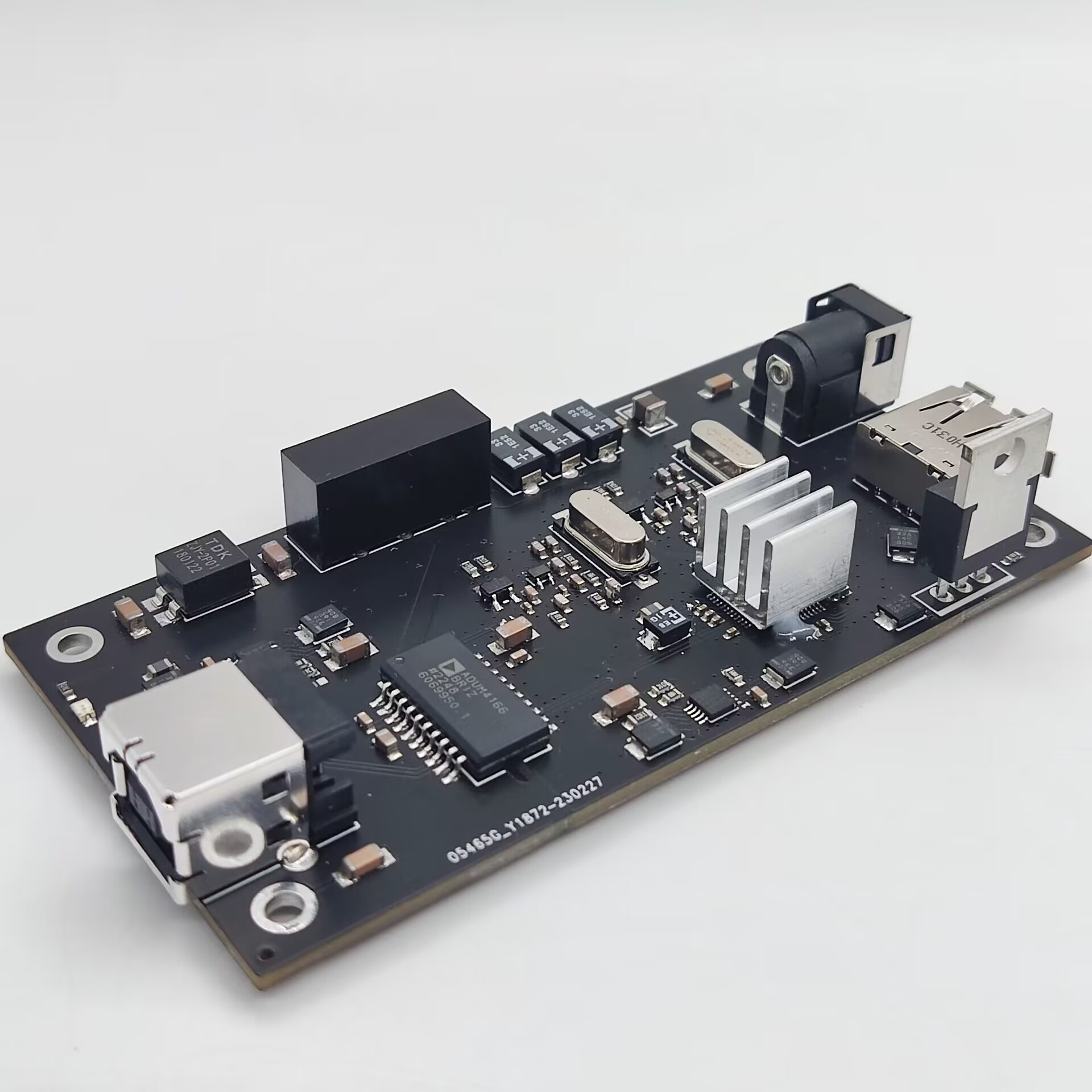

I have a problem with this USB isolator. I found it necessary to install the copper radiator plates on the FPGA-driver, but due to the mechanical removal of the marking, the surface of the chips was very uneven. I tried to sand the surface and broke one chip.
Maybe you know where I can buy such an FPGA chip, even with erased markings, so that I can replace it?

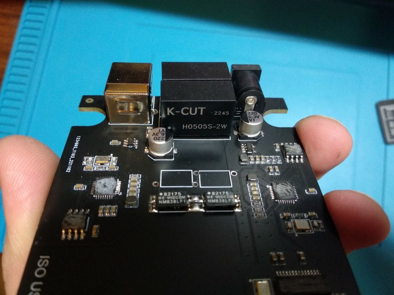

This isolator is based on adum4166,It can be used on USB 2.0 audio,Support to dsd1024.

Why exactly 4166 and not 4165?I should point out that I'm only looking for an isolator with version 4166 of the ADuM.
Or 3165/3166?
Alex.
P.S. It was discussion about x165 or x166, but as I remember - w/o conclusion
I prefer
I understood, but it is interesting 2 things:
1) why 41 and not 31? 3750 Vt isolation is not enough, you need 5700 V? Chips are the same.
2) why 66 and not 65?
Both have 24MHz clock.
Alex.

I'm interested with this isolator. It turns out that the 66 differs from 65 in that peripheral side with clock can be powered from clean supply. In 65 chip we can also do it, but then we need additional isolated 5V source for PC side to cut VBUS from PC. But it mentioned in DS that "When isolating a downstream facing USB port for a USB host, choose the ADuM3165 rather than ADuM3166 to have the clock source on the controller side". Why ?
It seemed to me that a downstream clock was ultimately more favorable
As I said, it was a discussion of this, w/o conclusion.
I made a universal PCB that can accept either 65 or 66, and used both. I didn't notice much of a difference.
P.S. But to be honest, I only used the AD3165/66 for a short time when the Texas 211 chip was temporarily unavailable.
