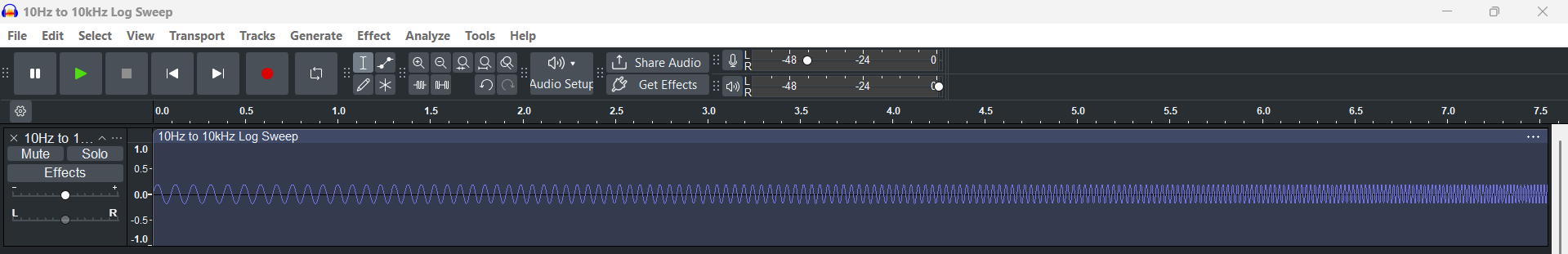

You need a simple test tone to begin with such as 1kHz tone to get the idea of what it does. Attached is a Mono MP3 File that plays for 30 seconds and goes from 10Hz to 10kHz. If you play the file on something suitable and look at the output on the scope you should begin to make sense of what happens and what the scope shows. You can use the scope to look at the output from the amp playing the tone and see what really happens.
The scope should show something like this and the amplitude (from top to bottom) should be constant.

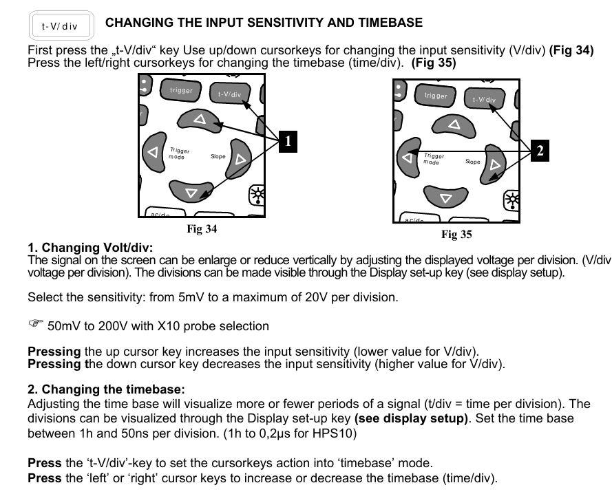

https://cdn.velleman.eu/downloads/0/user/manual_hps40_10-uk.pdf

The important settings are these:
The input sensitivity determines how far the trace moves up and down for a given input voltage. At this stage you just want something in the right ballpark such as 2 volts per/division. The Timebase set how long the 'spot' tracing the waveform out takes to move across the screen.
A 1kHz sine takes 1ms (1 millisecond) for 1 cycle and so a setting of say 1ms/division would trace out 10 cycles if the screen has 10 divisions on the horizontal axis.
The frequency sweep will look a bit like this but my file has the frequency increasing smoothly rather than in jumps like this one. Notice how the amplitude (top to bottom) remains the same. That is what you want to see.
I would recommend that to begin with you set the scope input to AC coupling and use the X1 setting on the probe.

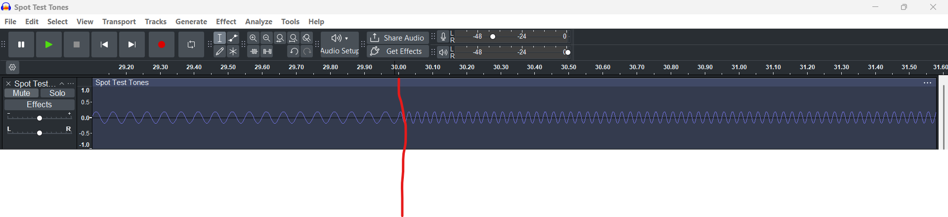

This shows the change at 30 seconds in as it goes from 20Hz to 40Hz.

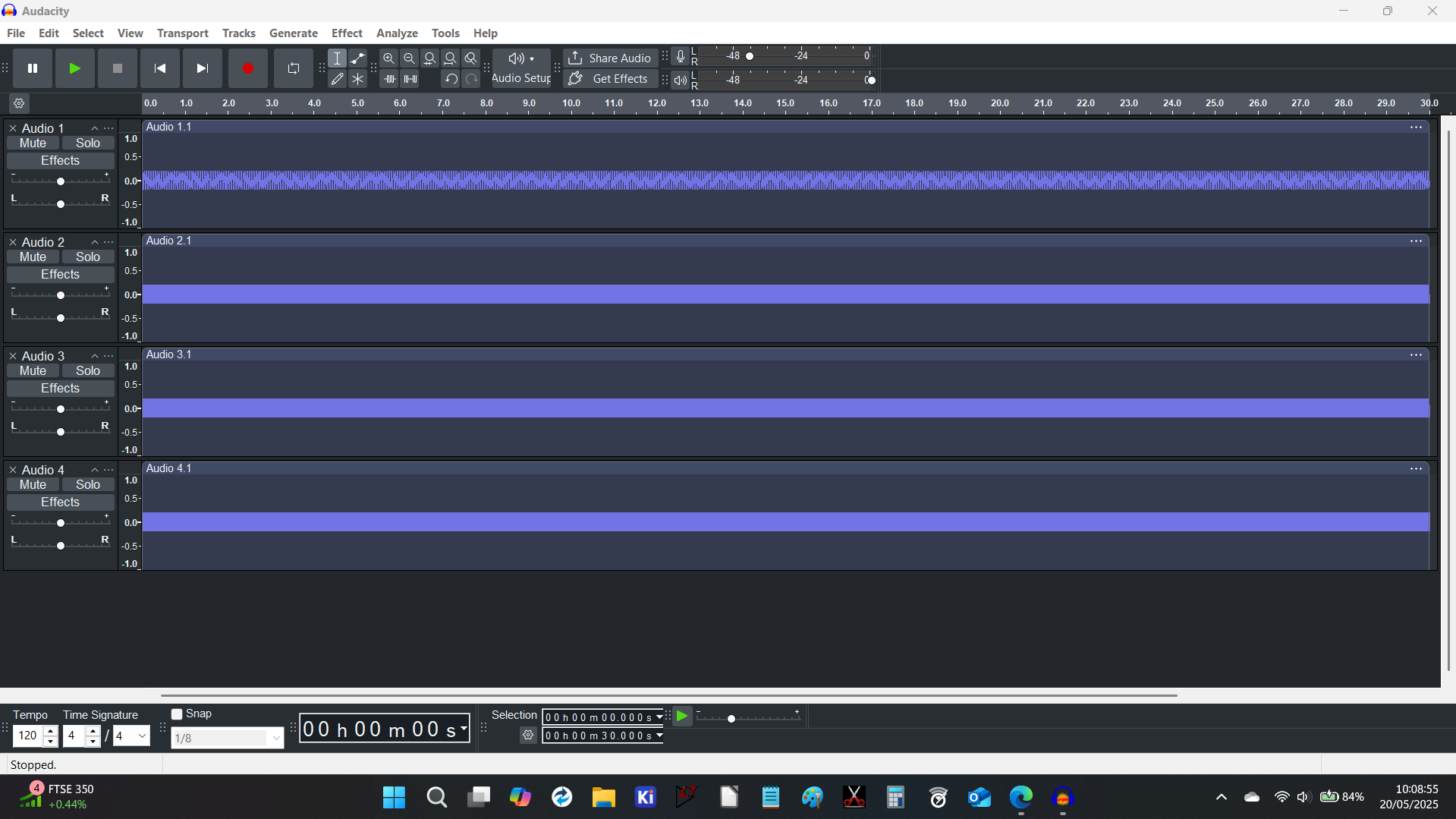

The spot frequencies are 20Hz, 40Hz, 100Hz and 400Hz. Your scope should show equal amplitude for all four and it will show whatever frequency is playing. You will not see the changeover point stationary on the screen like this on your scope.
