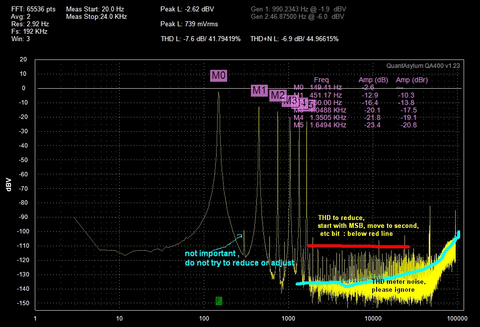

%%% Adjust the first bit (MSB) at -80dbv for lowest 2nd harmonics, then second bit to lower 3rd harmonics. It will give you the most dynamic sound and fidelity. The frequency can be 100hz but use a high resolution THD meter, or raise the frequency.

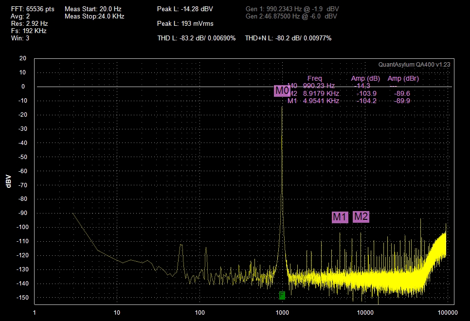

I try to readjust with the 4 trimpots at different volumes, the problem is to get it right at all volume levels.
I have around -52 db 4th, and 1-3 harmonics are -56.... AT max volume this gives around -105db , which is exceptional and can only be attained with the trimpots.
