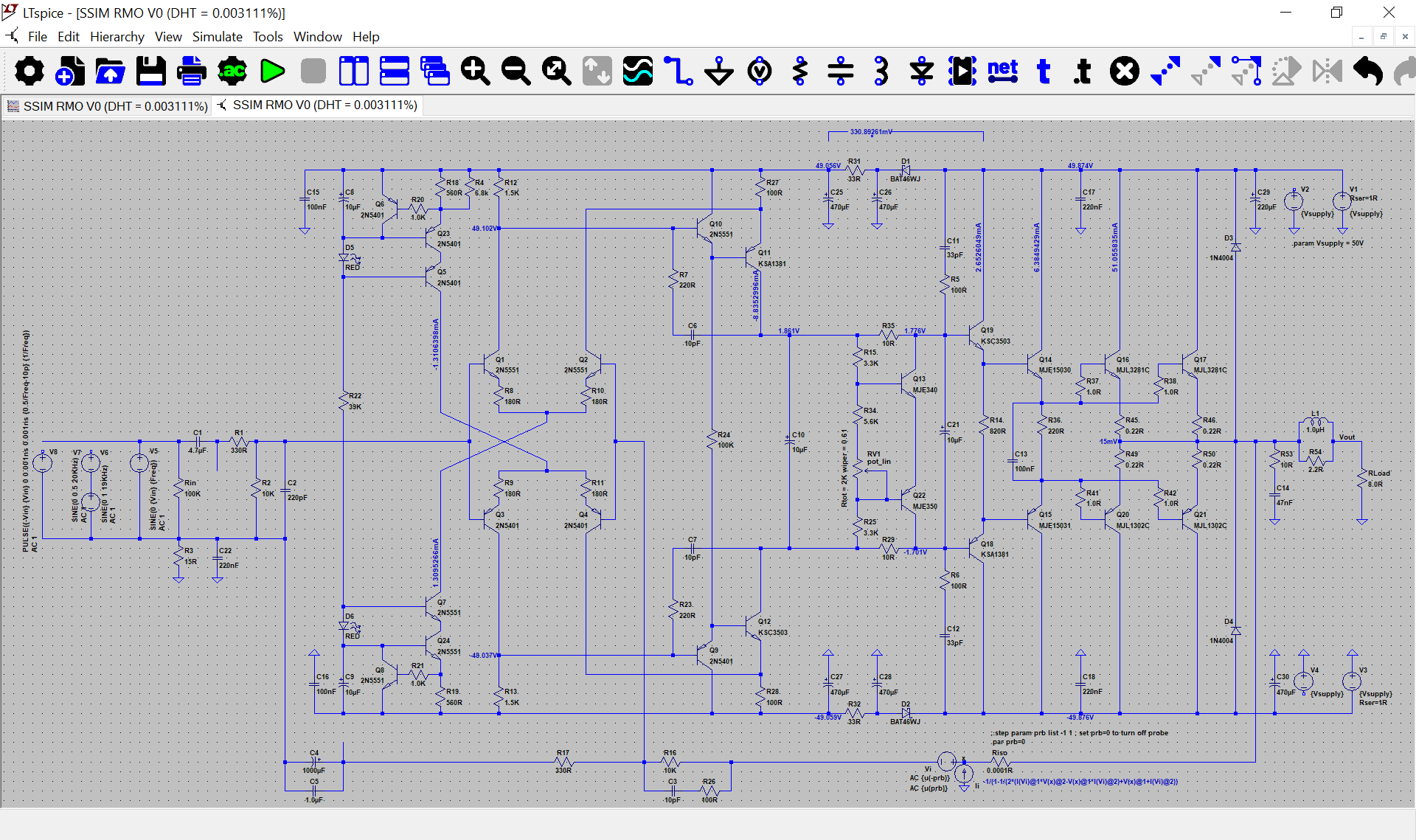

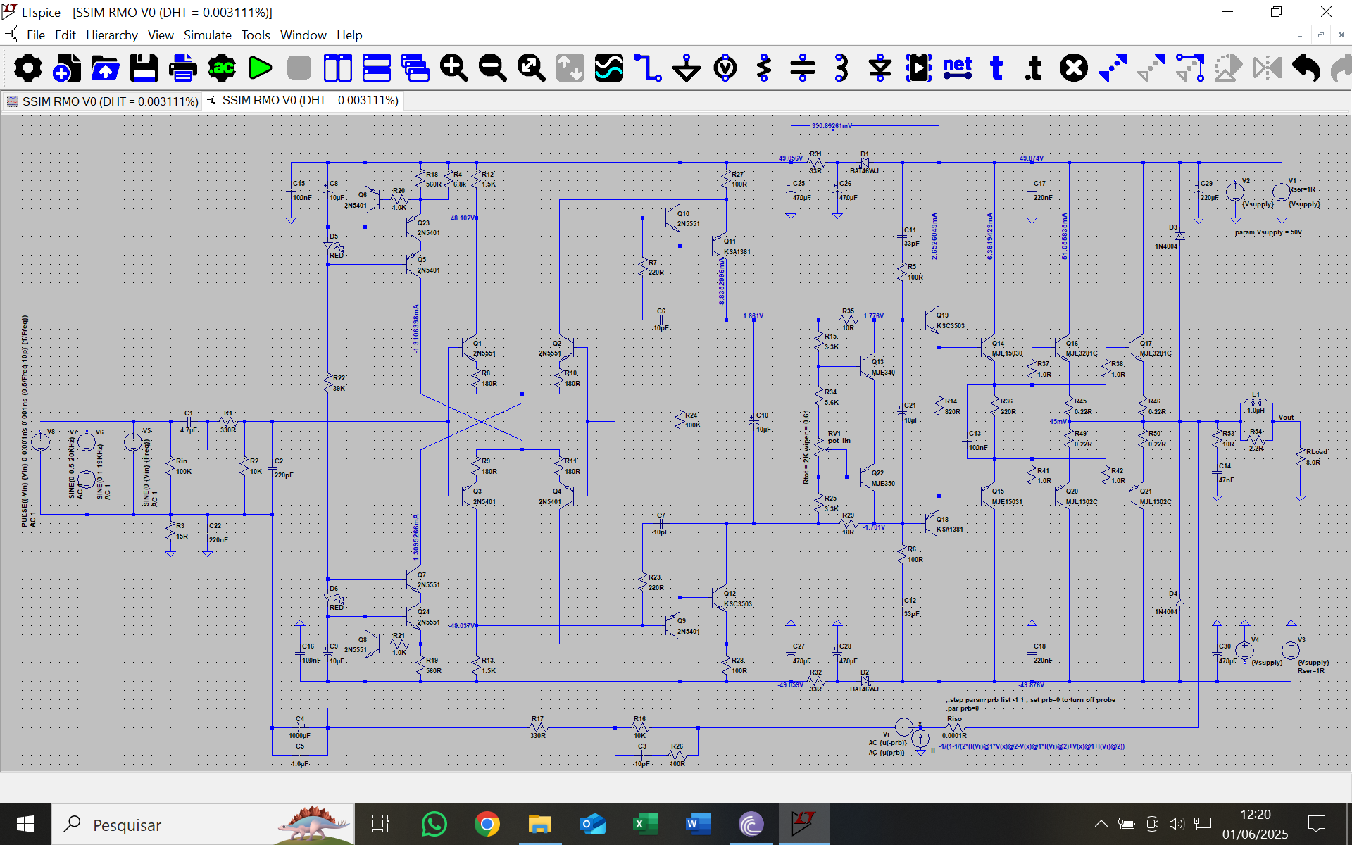

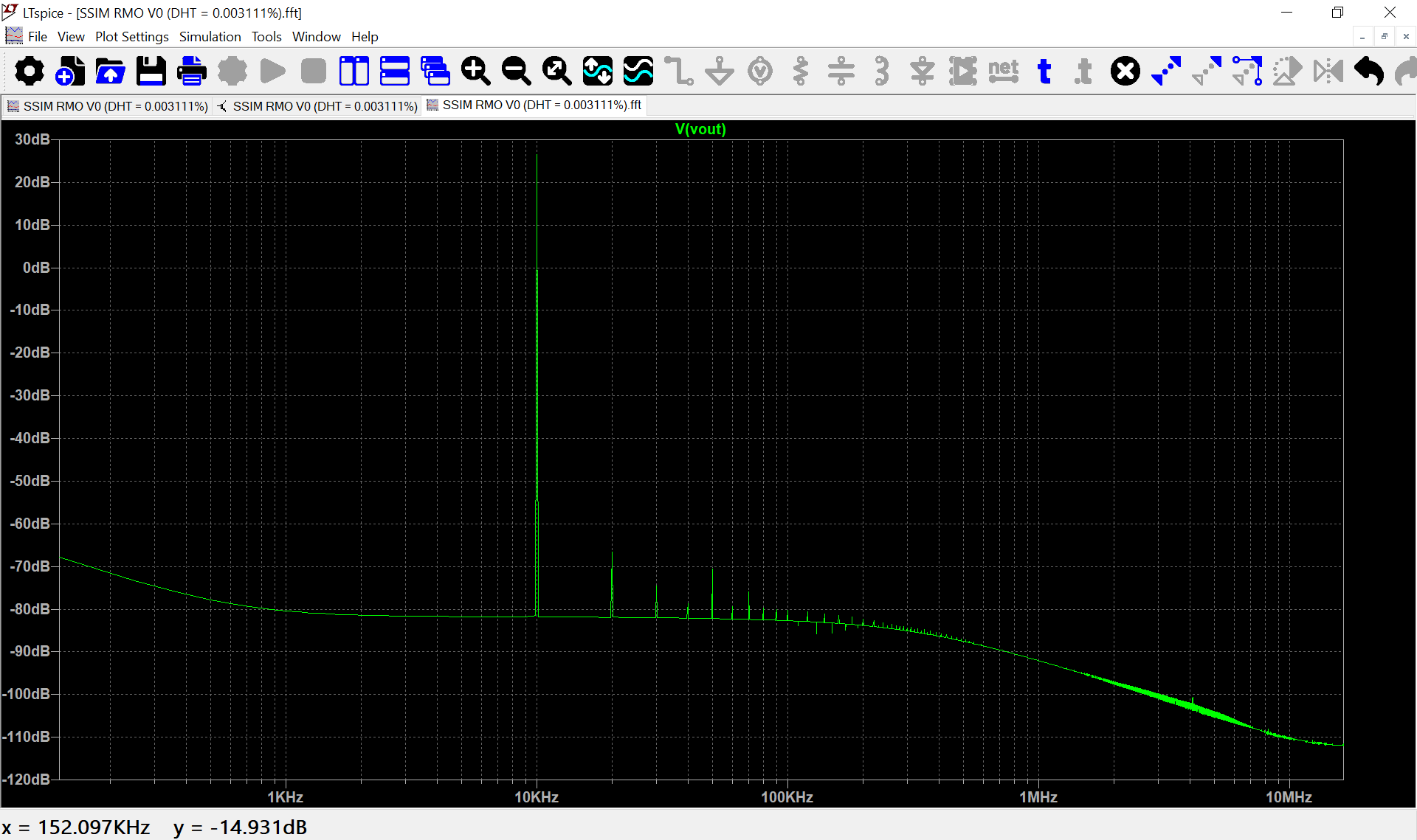

Super Symmetrical Amplifier with THD = 0.003111% for 8 Ohms load
Esse circuito de amplificador super simétrico aplica boas técnicas discutidas aqui no forum.
Essa topologia de circuito é a mesma aplicada na tese de mestrado do Professor Leach.
McIntoch, Rotel e outros aplicam a mesma topologia de circuito em seus amplificadores de estado sólido.
Agradeço por comentários relacionados com melhorias nesse amplificador. Corrente de bias é um parametro que pode ser escolhido pelo montador.
(Comentários em ingles pelas regras do forum).
This amplifier idea uses good technical ideas discussed here.
The circuit toppology is the same used by Leach in this master tesis.
McIntoch, Rotel and others makes uses the same circuito topologies in his solid state amplifiers.
I appreciate comments concerning improvements of this amplifier. Bias current is a parameter each one can choose and it wil not improve this amplifier as it is a option of the amplifier maker.
Regards
Hi Ed.
Your doc is just a point of view. I preffer minimum bias to avoid crossover distortion with low idle heating. High bias tend to create more distortion in OS and it can be confirmed with good and real DHT tester with resistive load.
Thank you for your comment.
I also got improvements adding offset adjustment. I will also add over current protection to avoid a big money loss in case of accident in output as a short circuit (of course with no performance loss).
Ronaldo
The optimal bias is what the simulator says it is. 🙂
The problem with underbias is that distortion is increasing very rapidly. In contrast, overbias leads to only moderate increases in distortion. Since the bias current will vary with temperature, it is better to be on the less steep part of the graph.
Ed
The optimal bias isn’t what the simulator says it is - it’s what the spectrum analyzer says it is. May or may not be the same.
EF3’s are somewhat tolerant of underbias, though. Takes hardly any current at all for gross distortion to go away. It will keep getting better till it hits an optimum, but you may get where you don’t care anymore before that happens.

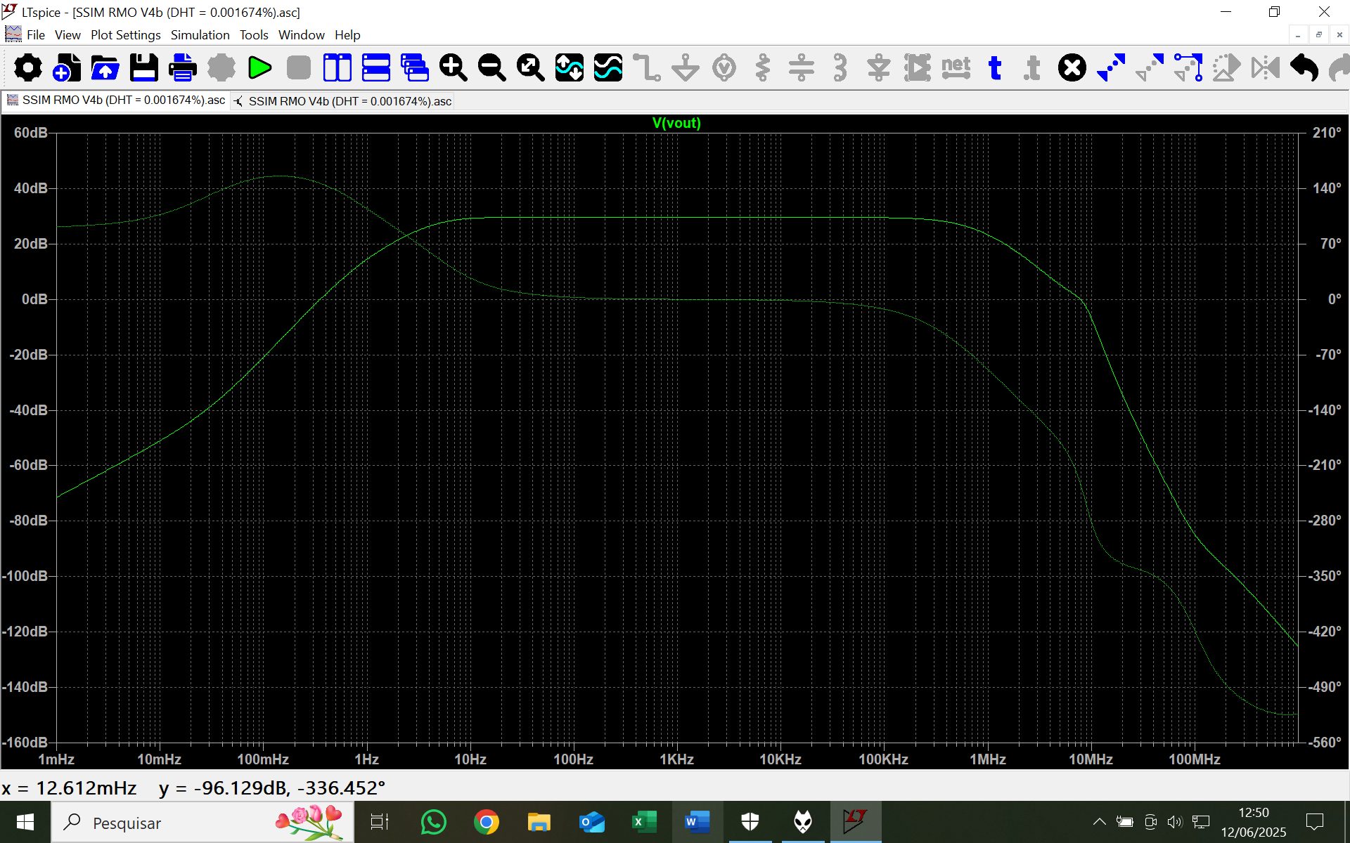

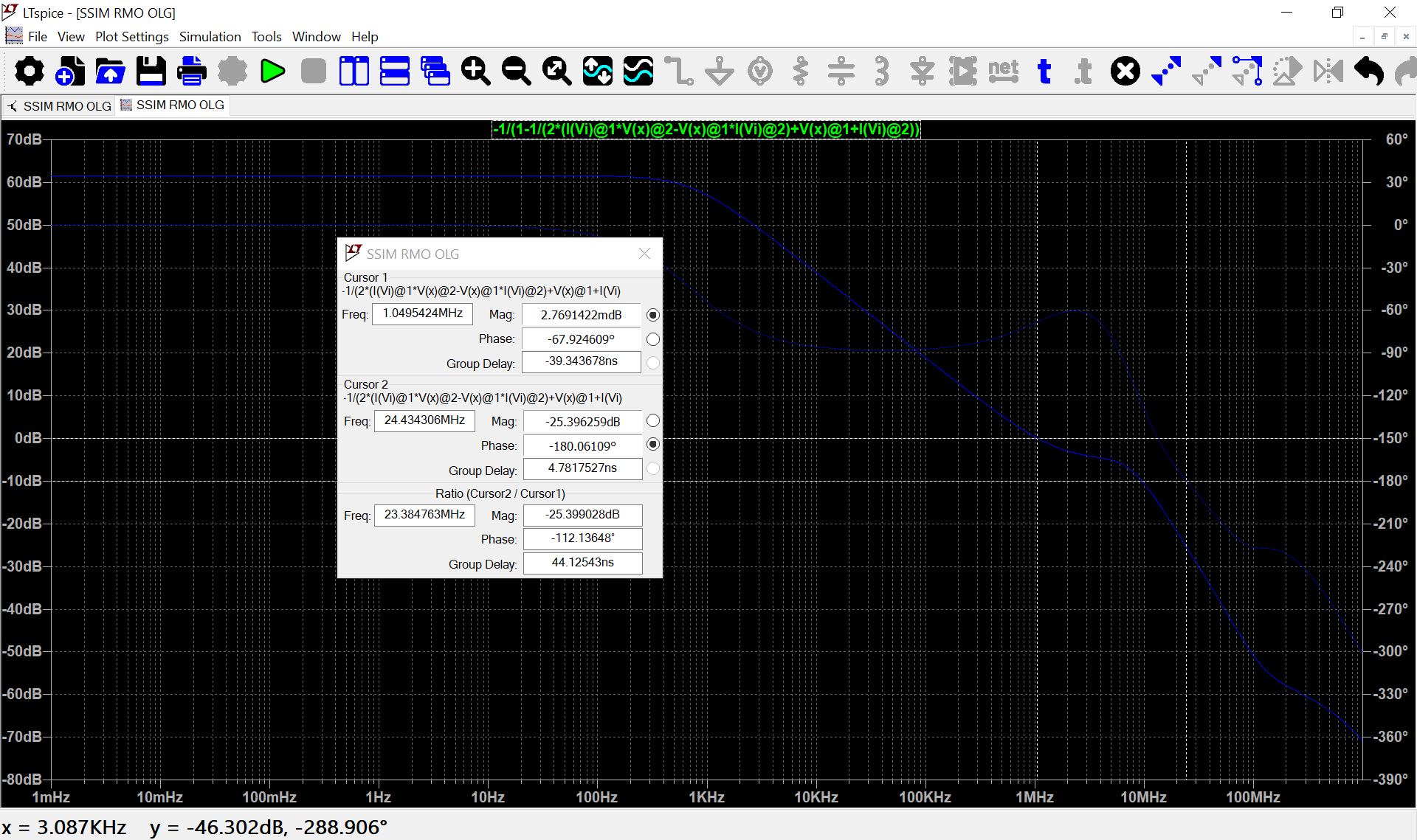

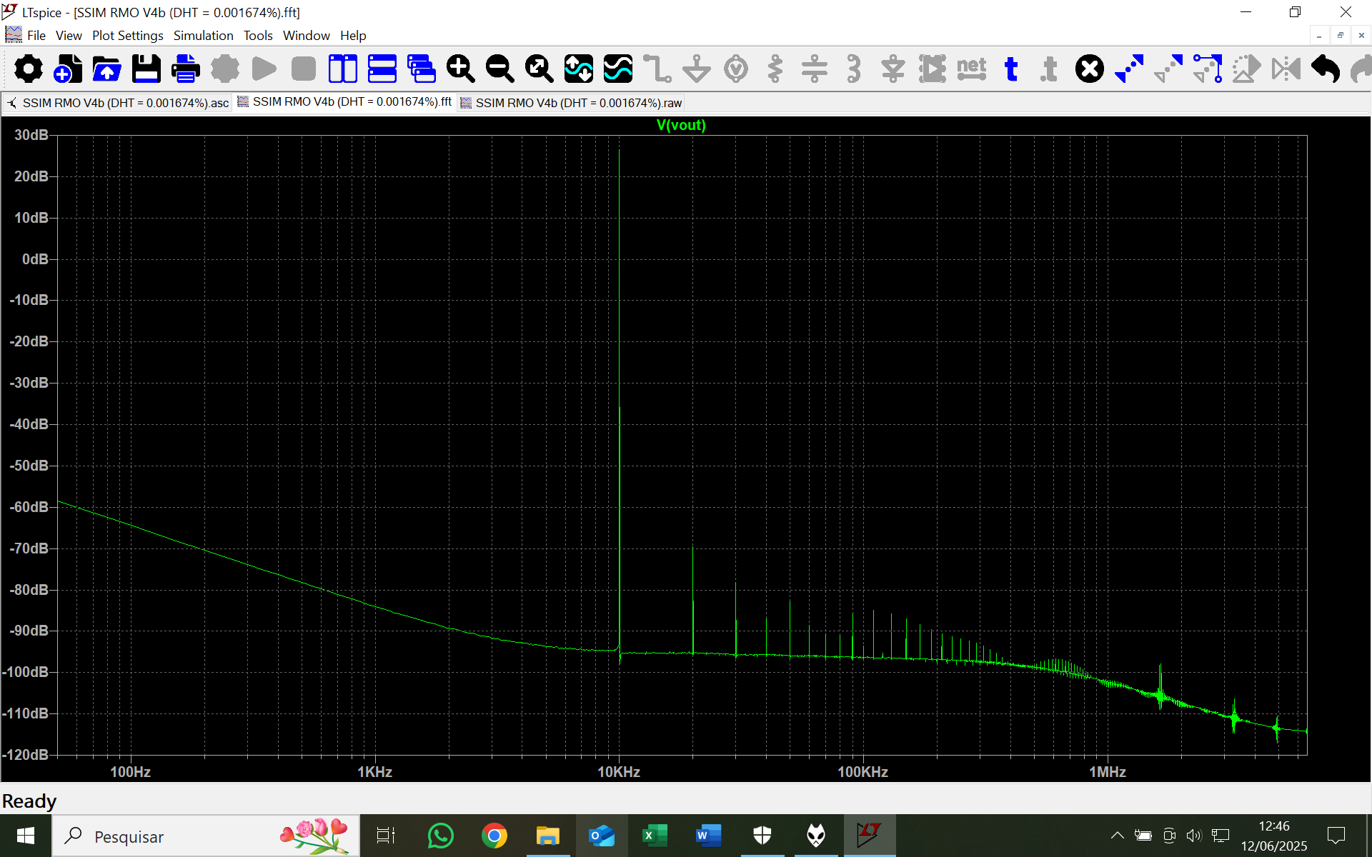

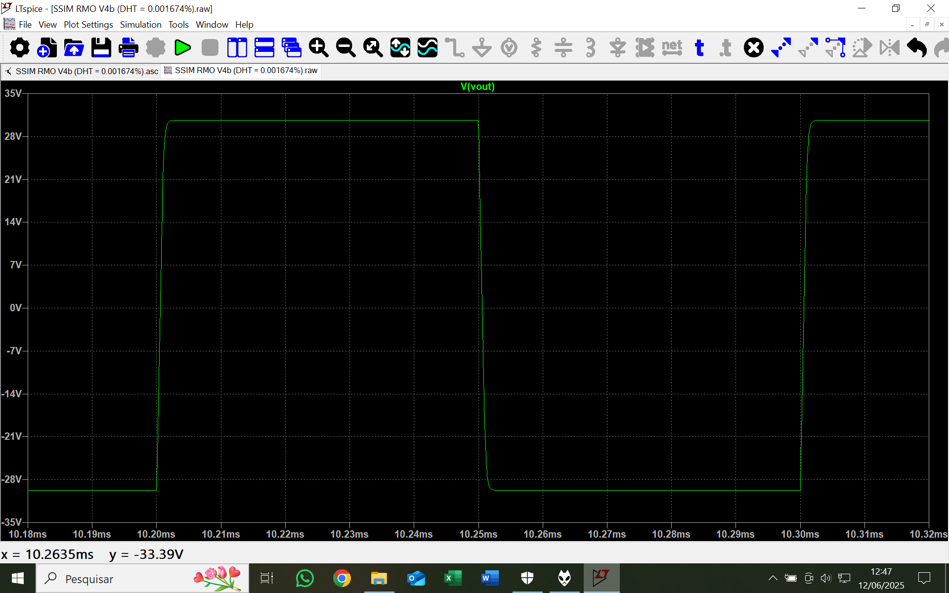

More informations to conclude the first part of this amplifier project.
Next step is add offset corrections and over current protection.
Here we have step response and phase margin result of open loop gain of amplifier.

51mA is too low for 0.22ohm emitter resistors. See my article on Class AB biasing.
Ed
No, that statement is not correct.
Depending on how many transistors you parallell in your output stage that optimal bias point you are hunting for will vary.
The more you parallell, the lower the optimal bias point will be.
Then it also is a matter what the designer of the amplifier think is the best sound of distortion components and character.
You can tune bipolar transistors for odd order preference and a more linear distortion preference and you need to find the right amount of mixing amount of parallell pairs, amount of bias and the value of the resistor itself.
There is no "perfect" or "optimal".
Depends on what you are looking for as a designer and what sound character you want.

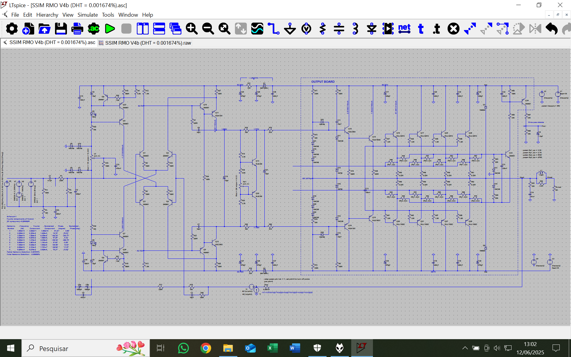

You don't need to cascode the tail of the long tail pair.
The constant current source from Q6, Q23 has very high output impedance, thanks to its local NFB.
I suggest putting 100 Ohm base stopper resistors to Q14, Q15. EF3 tends to oscillate.
One can add more degeneration to the current sources instead of cascoding, if higher Z is desired.
Decoupling just needs to be very close the the Q18,Q19, Q14, Q15 quad for EF3 to be stable. If not, collector-base capacitors might need to be quite large, and that tends to scrub off performance fast. Might not need 470 uF, but you will need 100. Adding the smaller film cap in parallel is sometimes self-defeating. Depends on their self-resonances. Simulator doesn’t take things like that into account, unless they are modeled.
Dear wg_ski and jxdking
Thank you very much for your suggestions.
Cascodes was aplied in current sources to reduce internal resistence which appear as temperature dependence. The point here is to get the best possible performance. You noted I match the current values with fixed resistor as I used to do in Telecom Industry. I considered use of current source (jFET + Resistor) to polarize the main current sources, but it was not necessary in my SIMs.
I tried resistors as proposed and I choose to apply RC (C11-R5 & C12-R6) in the base of the first transistor pair of the EF3. It is to solve the EF3 instability probem. I will check it again when I assembly the first prototype.
I also choose the C-R-C-D (C25-R31-C26-D1) in supply rails as I got best results with this arragement instead the use of capacitance multiplier.
Now I am working in output current protection. An I hope to conclude the SIM part of the project until the next week.

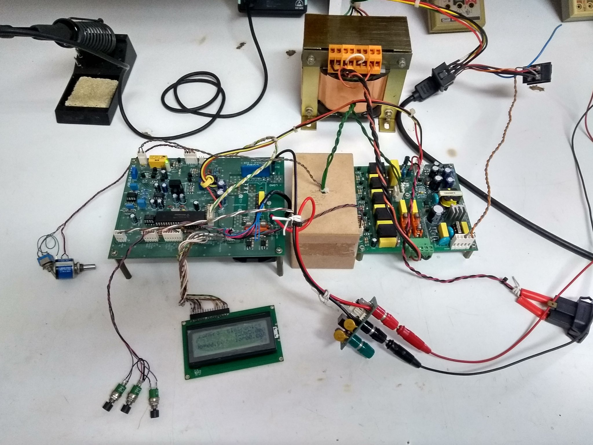

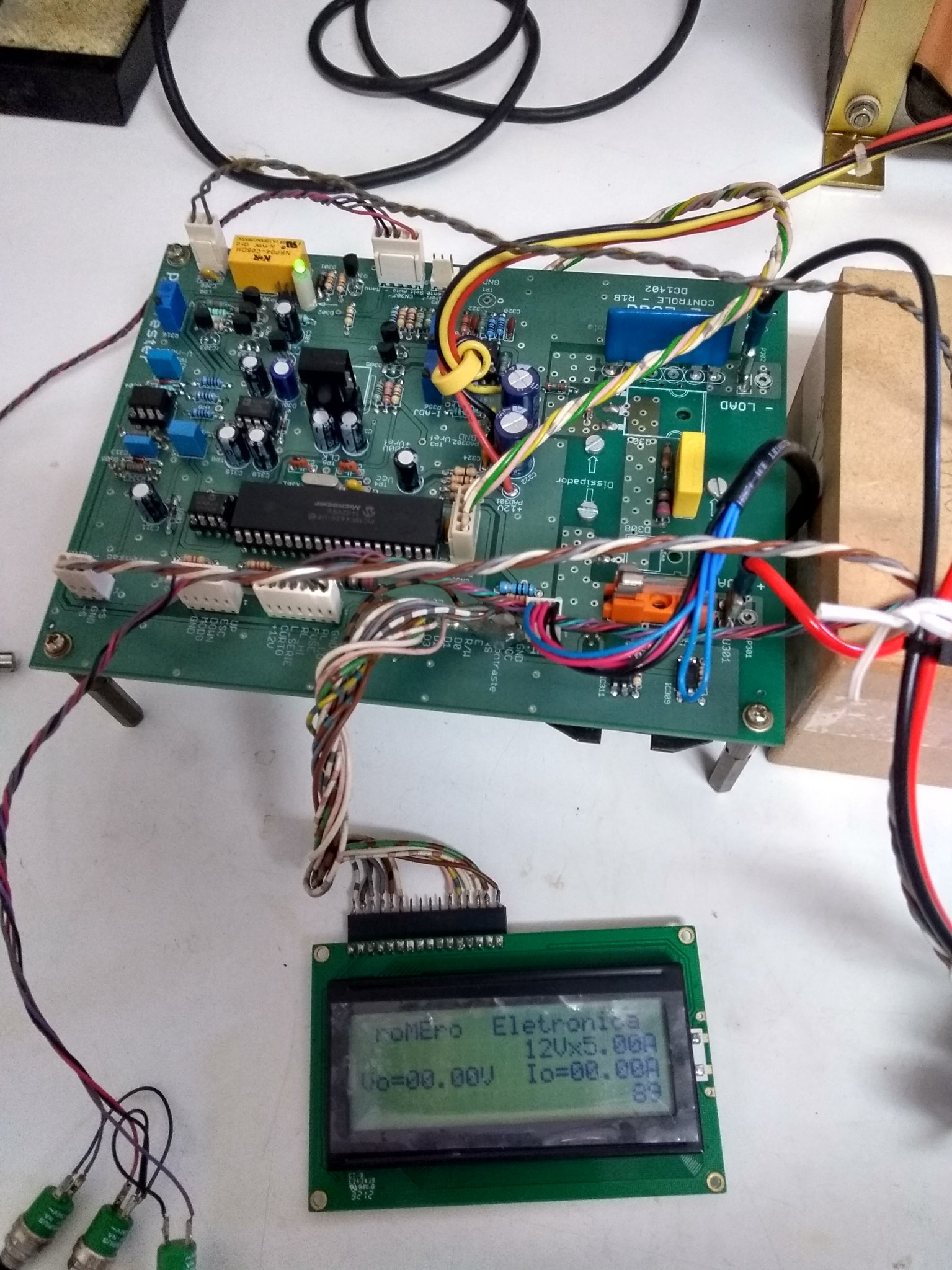

Last professional project (I am retired Electronic Enginer). It was a PSU Telecom Tester. It can test more than 50 wall types PSU (Diferents Voltages and Power) doing several tests including output voltage noise in 120Vac and 240Vac lines. This test is based in a programmable by DAC electronic load. It was the only project I got prototype. I did lots of thinks for electronic industry in more than 30 years work.
