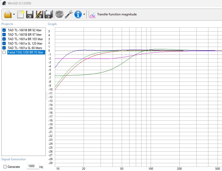

I played around with some simulations in Winisd to maybe help you understand what can be expected from TL-1601a.
I also included a pair of simulations with it's successor TL-1601b that is better suited for a ported design.
I think TL-1601a can be used in a ported design, but would better of in a passive radiator system or in a sealed enclosed with a sub as you are planning.
All these simulation have the gain of a 30 m2 room added so this is estimated in-room responses.
Ranged from the top at the 30Hz vertical line:
Dark blue: TL-1601a in 105 liter ported enclosure.
Light green: TL-1601b in 97 liter ported enclosure
Red: TL-1601b in 92 liter ported enclosure
Purple: TL-1601a in 120 liter sealed box
Dark green: TL-1601a in 60 liter sealed box
Personally I would select 60 before 120 liter sealed box when combining with a sub.
You will exite less room resonances and get a little peak at 100-200 Hz that will help to compensate for the dip that often occur in 100-200 Hz because of floor reflection if bass driver are placed with some distance above the floor. I assume you want to do that to not have a too low position of midrange in the soundstage.

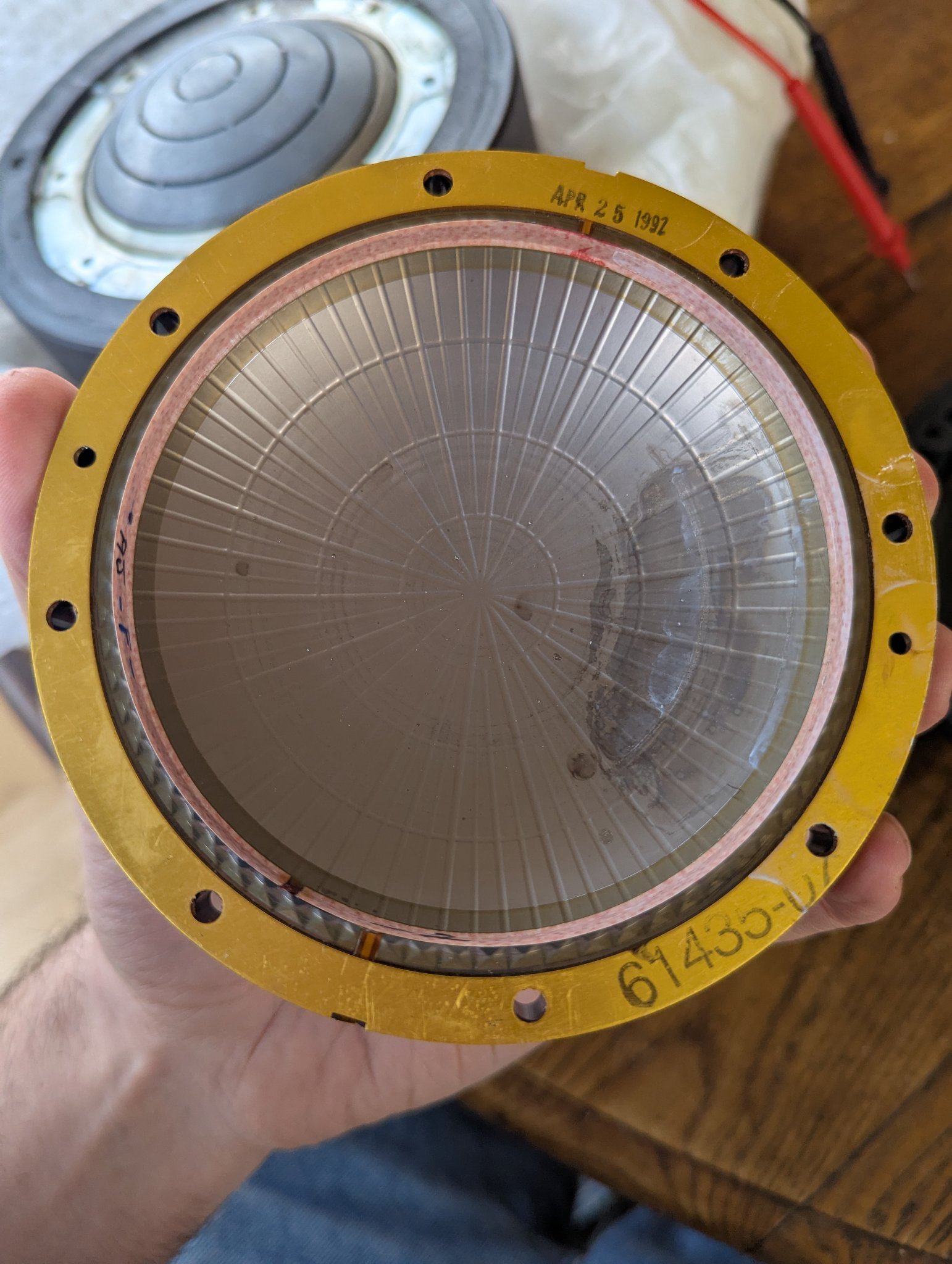

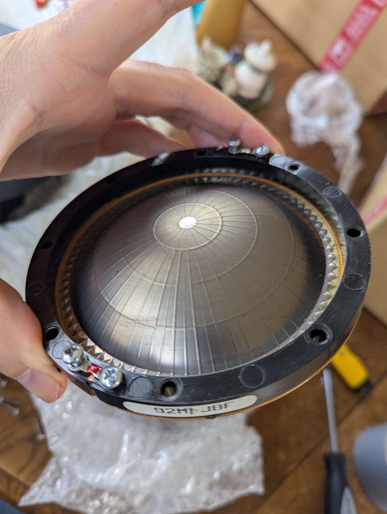

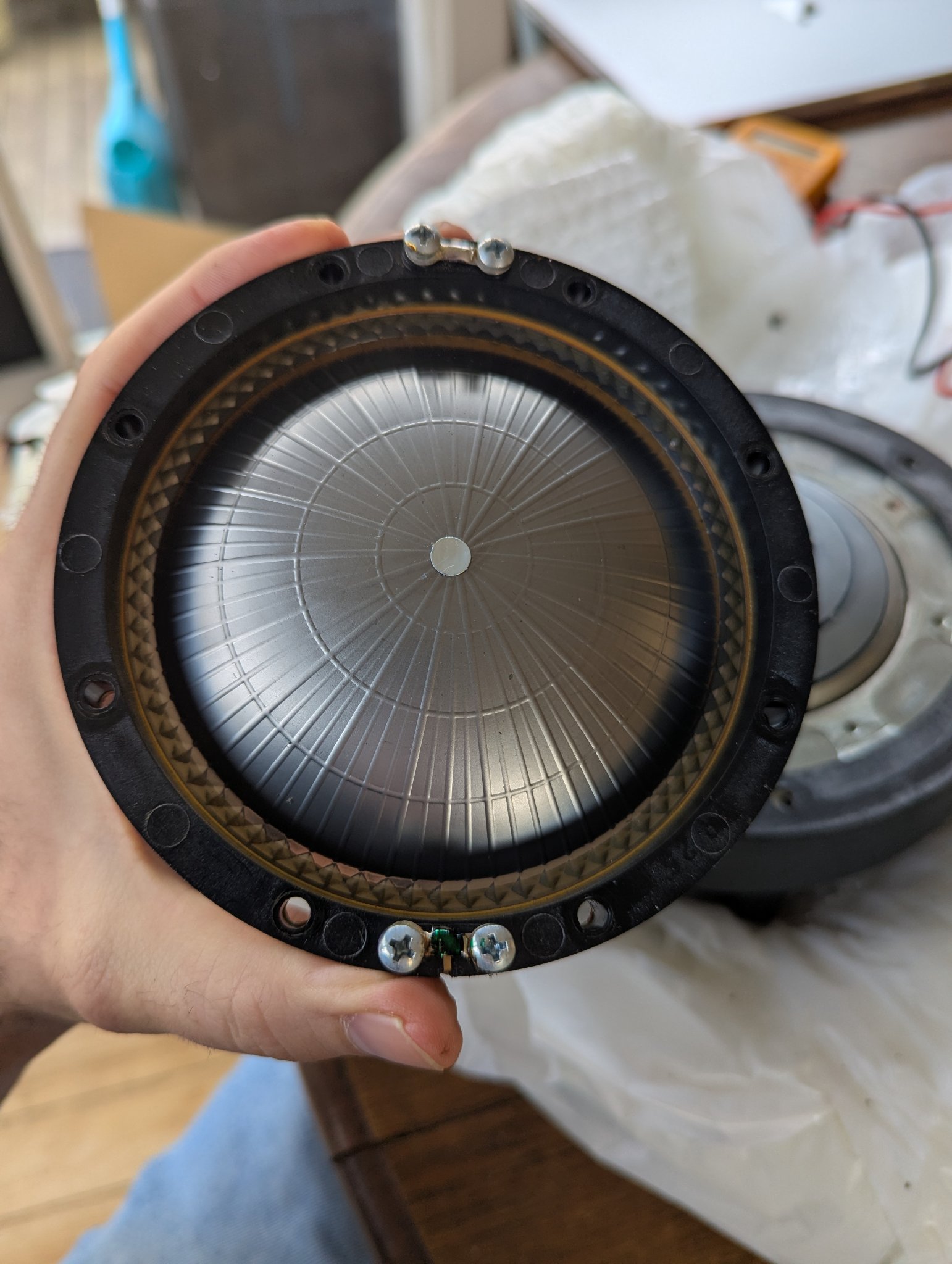

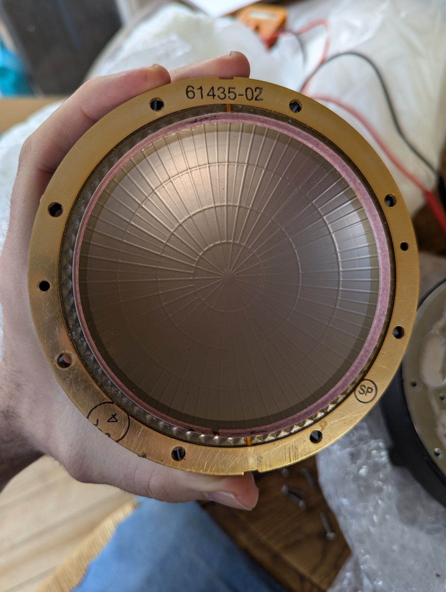

Hi All,
So received the TAD TL-1601a's today - good news, they measure 7.0 and 7.1 ohms each, so resistance seems to be within spec.
The JBL 2450H's not so much luck - one measures 4.5 and one measures 8.2 ohms. The one measuring 8.2 looks a bit rougher inside, and they seem to have mismatched diaphragms. I thought perhaps one of them was fitted with a 16ohm diaphragm and that could explain the large discrepancy?
From what I understand an 8 ohm diaphragm should have 4ohm DCR, and a 16 should be 8.
Here is the one measuring 4.5ohms:
Here is the one measuring 8.2ohms:
Not quite sure what to make of the part numbers. But I guess the plan now is to buy replacement diaphragms. It's safe bet to say they would be the only part to have a fault right? Just hesitant to pour too much more money into them if they might be cooked..

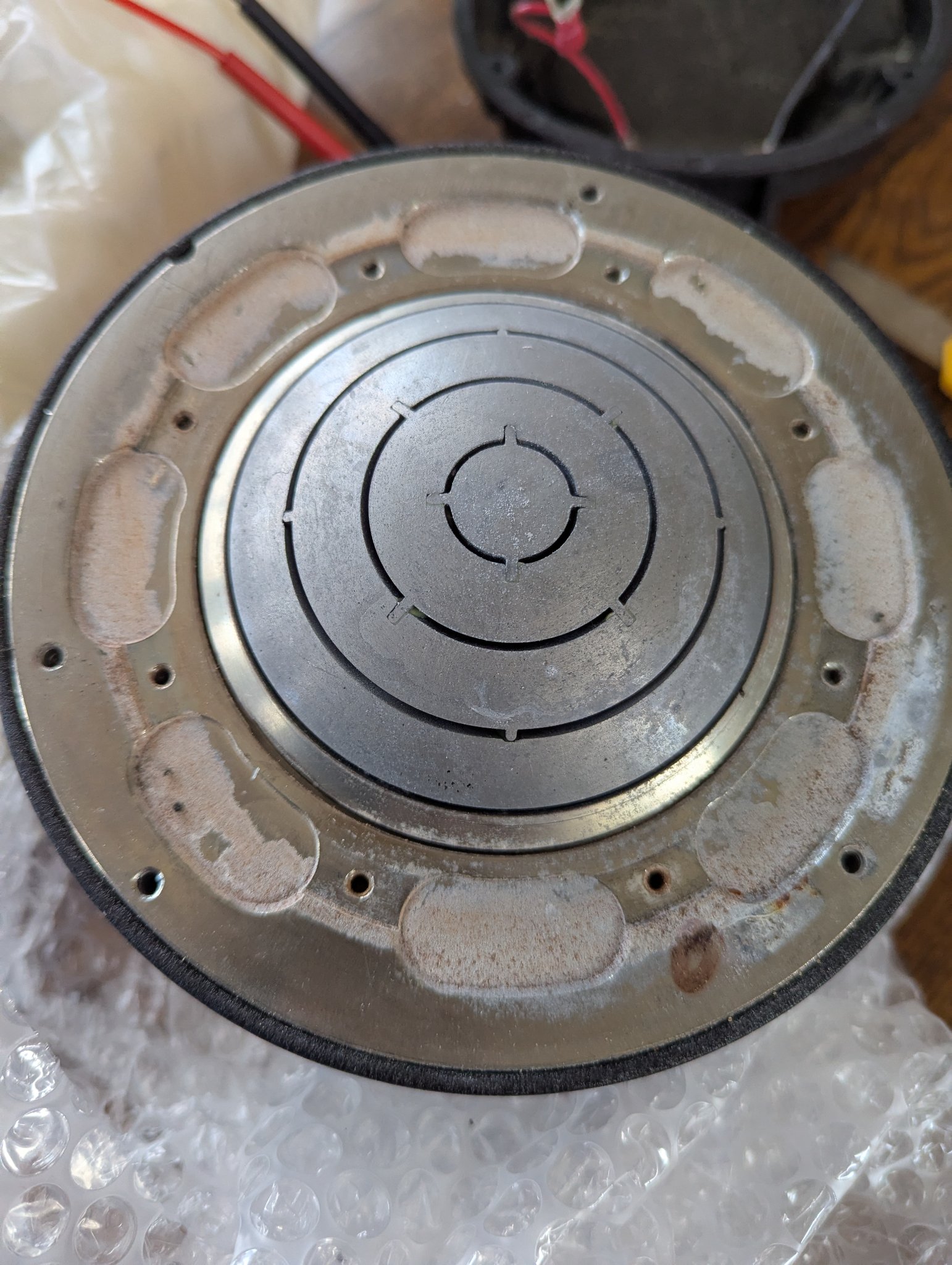

The lower driver is missing a gasket?
And looks like it has been exposed to some moisture.
Cover the gap with masking tape, and scurb off the corrosion with solvent etc.
Anf after clean the VC gaps with som folded over tape etc.
You can find some basic videos on how on youtube.
Fx satria speaker on YT, or one of the american repair shops( name escapes me right now).
And yes you likely have 1x 8 and 1x 16 ohm diaphragm.
For use all the way up, you will be much better off with a pair of Aquaplased JBl (2450sl /2452hsl), or Radian AL diaphragms as explained.

@Arez - Fantastic thanks very much for the info.
Apologies it does have the gasket, but I removed it when inspecting.
Yeah that one has some pretty bad corrosion - thanks for the tips, I'll give that a try.
Is light sanding and then vaccuming or blasting some air through ok? Looks like there could be a bit rough in the voice coil gap also.
Obviously some care needs to be taken when centring the voice coil - but not sure how in depth I need to get. On the channel you mentioned he seems to be using a signal sweep when centring - is that to listen for any noticeable distortion?
Then there's this thread where he's using a depth gauge jig https://www.audioheritage.org/vbull...-2451-D8R2450SL-diaphragm-installation-method
Just to confirm, this is the aquaplas version you're referring to? The radian does look good also, but if I have that right it's quite a bit more expensive so may start with these.
