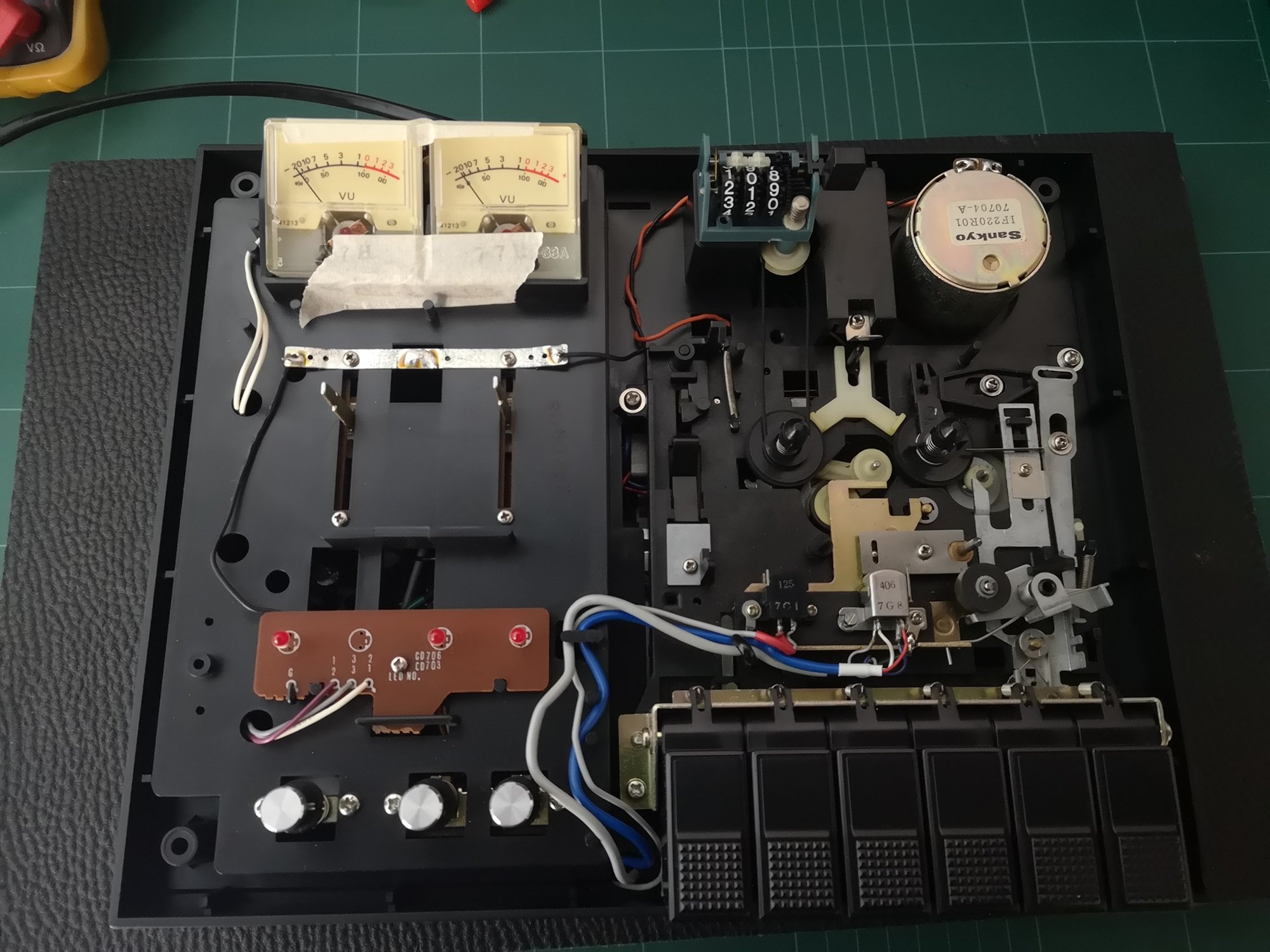

Here’s a nightmare repair which seems not to have an end. To date, I’ve been struggling with this device for months.
It’s Transylvania (?) Cassette Deck, Model GR-18,I think is dated somewhere between mid/late 70s not beyond early 80s, sure hasn't been used for a long time. Searching the web, I found out that Transylvania was part of Asahi Corp. further information are nowhere to be found. I only found a single picture of this model, and of course no schematics at all.
The problem is: dead left ch. I mean totally dead, no Rec., no Play, not even on the phones. The other channel is ok.
Things I already did:
1. Cleaned and demagnetized the heads
2. Thoroughly cleaned the rec/play multiple switch by disassembling it and cleaning every single contact.
4. Checked all the channel components on board and all the semiconductors also off board.
3. Replaced the Dolby IC, based on what someone said to be “common fault”
4. On Mooly’s suggestion I also verified continuity between the cables coming from the heads and their respective connection on the PCB.

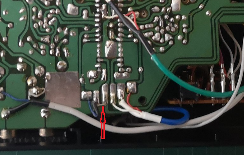

I'm sure someone has already put his hands on it, the signal cable coming from that channel head was soldered on the same pad of the ground. So it could be the same thing for one or more of the many cables attached under the PCB.

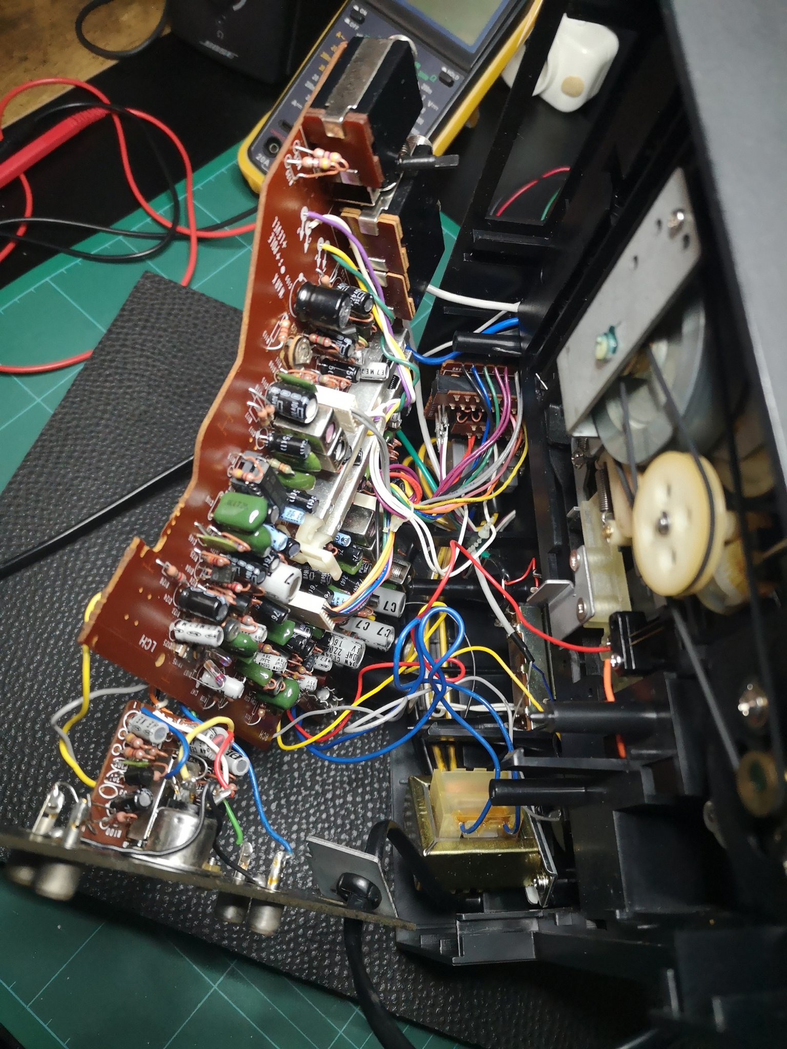

The problem with this unit is the top side of the PCB is hard to access, unless desoldering 20+ wires attached to random zones of the PCB itself (top & bottom side). Any move of the board can lead to wires disconnection, it actually happened several times, and you can go crazy finding out where they came from. Very bad design and construction: cable mess, no silkscreen etc.
All in all, quite a challenge for a hobbyist like myself. Hope you guys can help, thank you.

Just very quickly...
Firstly what is this:
And I was going to say if you desolder the white and red wires and put it into play mode and then touch the pads where the wires go then the meters should go nutz as you should get loads of hum and noise through stray pickup.
Use phone camera to take photos before doing any work on soldering etc., it is very handy when you are trying to work on the circuit, particularly without silk screen to guide you.
Are the motor and belts okay?

NaresBrd, Mooly, thanks for your replies.
I checked the heads for coil continuity and they are OK, slight difference in resistance value but I don't think is a problem, considering i didn't disconnect them. I also tried the other thing NareshBrd suggested: I fed the record input with an external audio (no cassette, just manually activated the tab-switch) and for the first time I heard both the channels!
Please consider that, when I tried to record a stereo source, the Left ch. recorded nothing.
@Mooly - Not sure to understand, red and white wires are from the right ch., the working one. The six PCB pads, L to R, are:
Left ch head (blue), Shield, Left head (grey),
Right ch. head (white), Shield, Right ch. head (red).
Shields and white/gray wires are connected (shorted).
@NareshBrd - Yes I took pics of everything before to begin. Belts are a bit loose but working, I'll measure them for possible future replacement.
Sorry, it's me misreading the pictures.
Disconnect the head to the faulty channel at the PCB and with the deck in play mode just 'buzz' the isolated pads and see if the meters respond. Its a really crude test but shows if there is signal gain and that at least something is getting through. Compare with the other channel if needed.
If you still have no signal then try and locate visually the transistors in each front end stage on a channel by channel basis and compare voltages on the transistors in each channel with the deck in play mode.
Spray all the switches with CRC 2-26 or equivalent contact cleaner, work them and leave overnight.
Chek next day...could be simply tarnished contacts in switches, and corrosion at wire joints.
Then start with bad electrolytic capacitors and so on, electronic issues.
Check supply volts to both channels, could be no supply to one channel...

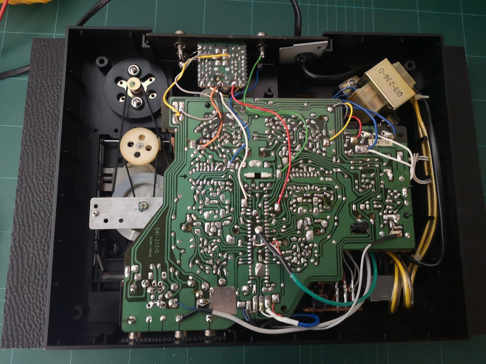

PS: I found out that the PCB actually has the silkscreen, it was hard to see cause the PCB's top side was close to the chassis. More, the components practically cover the text.

a little update about this neverending repair. I replaced all the transistors with the alternatives Mooly suggested, leaving out just the C1335. Nothing changed. I tested the C1335 off board and the tester says it's ok.
I also did the buzz test again, disconnecting the head cable and touching the pad on the PCB, and I could hear the buzz as in the previous test.
Just to definitely rule out the heads from the suspects list, I inverted their connections on the PCB, nothing changed, that left channel is dead.
That said, if I put the unit in record mode and inject some audio signal into the RCA inputs, it works fine (I did this test days ago, and reported in one of my previous messages). So I think the problem is somewhere else. I'm afraid somebody messed up things before me (I initially found the signal wire from the head soldered to the ground pad).
With lots of wires going onto PCB (top & bottom), there's a lot of room for messing things up. If that is the case, it would be impossible to fix the deck without a schematics.
The fact is: you can't hear nothing, not even a basic output noise, nothing at all, like if the signal was shorted to ground before to reach the output jacks. The VU Meter doesn't move, not even at the startup (the other one does).
