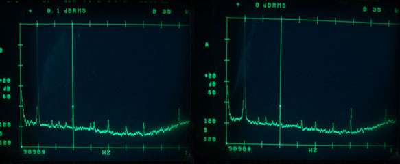

I also think that 16 bit is enough because higher linearity isn't possible anyway.
It only increases dynamic or in other words lowers noise floor, but then distortion is more noticeable.
Manufacturers claim to have 20 or more bit but my test of PCM63 and PCM1702 show other result.
PCM1702J, differential mode, left and right channel.
PCM56
You can see noise floor of PCM1702 is better because of more bits, but distortion is worse.
You can directly compare pictures with left side y scale.
Noise floor is -60 dB both DACs @ 1 kHz.
For PCM56 it is flat for 1702 noise gets better to 7kHz.
Hi bernhard , i'm using 2 PCM 56 per channel with a common 750 ohms I/V resistor , but when I was with 1 DAC per channel and a resistor of 1k2 (=Zout) , i found the sound OK .
