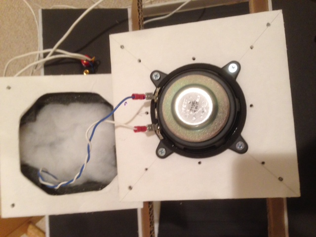

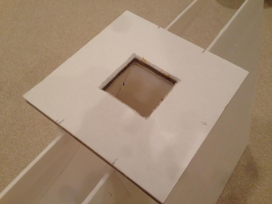

Some build photos from earlier
Just thought these might be useful for folks to see the interim stages of the build showing a closeup of the the throat flange where the driver bolts onto, and the rear chambers and how terminal binding posts are attached as well as how they are lined with foam.
Throat flange (note sandwich construction of FC-3-layer cardboard-FC):
Throat flange with 3FE22 installed and rear sealed chamber removed showing foam and polyfill damping material:
Rear view of Trynergy showing all three rear chambers in place:
