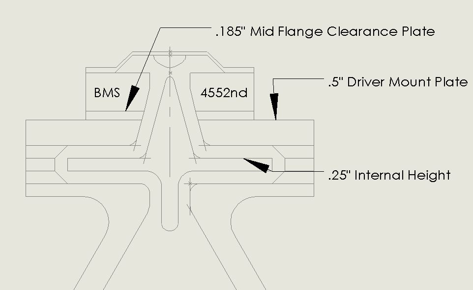

Not to pollute the LeCleac'h thread, but the BMS drivers aren't perfect either, at least not the 4552nd which I have and have taken apart. Here's a drawing I made a while back.......disregard all the weird bending business after the CD throat
![343567d1366386340-square-pegs-improved-paraline-throat.jpg](https://www.diyaudio.com/forums/attachments/multi-way/343567d1366386340-square-pegs-improved-paraline-throat.jpg)
That's about a 26° exit angle. You can see where the throat is straight then sharply changes angle? The straight part of the throat is a guide where a thin wall cylinder attached to the diaphragm/back plate slides in to center the vc in the gap. The "u" shape at the top of the drawing is the phase plug, along with a bunch of radial slots that I didn't draw.....

The throat should start at the phase plug adjacent to the cone. At the points you've marked the pressure from each of the slits should be in phase. The cross sectional area at this point on the horn should be appropriate for the combined pressures from the phase plug, and it afterwards continues the same expansion.http://www.jblpro.com/BackOffice/ProductAttachments/tn_v1n08.pdf
I have highlighted the points where the exit to the driver begins. Will there not be diffraction at those points?
You are assuming that the horn starts where the phase plug ends. I may be wrong but this is almost never the case. In the JBL diagram, and in the drivers I have seen, this is not the case. The phase plug ends inside the driver and there is an opening with finite length before the exit. The device with no throat would have a 0 degree exit angle, correct?

I'd have called it the beginning, not the end but could be a simple misunderstanding. I was idealising, sure, but the point I was making is that the bends you pointed out (WRT diffraction) don't necessarily appear as bends to the wavefront.You are assuming that the horn starts where the phase plug ends.
Hasn't Earl said that the OS waveguide is intended to make use of a plane wave? With a phase plug designed to give a spherical wave at the driver exit, wouldn't you want a conical horn?Phase plug.
