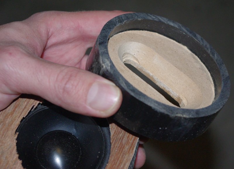

If I were you, I wouldn't use holes. The design of the ducts on the Synergy horn and the Yorkville Unity horn is superior. This makes a BIG and measurable difference on the performance. If you *must* use a hole, put it at a location that's 1/4 wavelength from the upper limit of the midrange. So if you want to run the midrange to 2000hz, put the center of the hole 1.6875 inches from the throat. (13500 inches per second / 2000hz / 4)

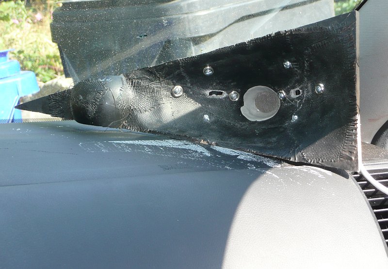

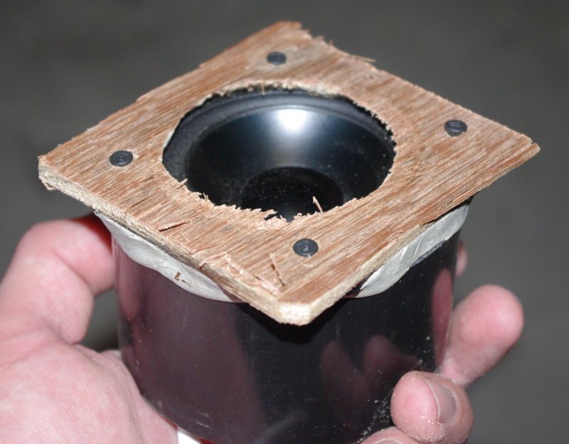

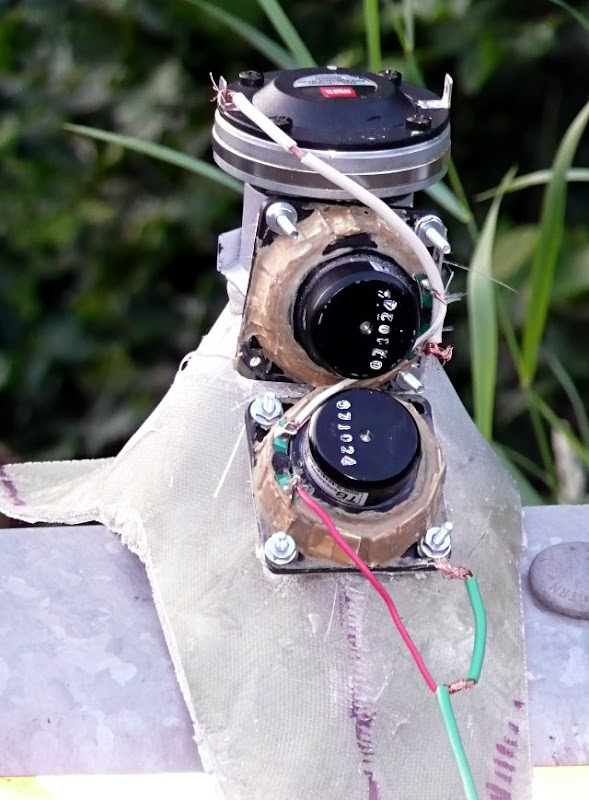

I am running the Tang Bands in my car on Unity waveguides, along with the Misco sealed back midranges on a horn. A pair of Tang Bands has slightly higher efficiency, and measures better, than the Misco mids.
This was completely unexpected - you would think a crummy little 2" computer speaker wouldn't perform so well.
Admittedly, the horns that I'm using for the Misco are *anything* but ideal, while the waveguides that I'm using for the Tang Bands are close to perfect, so that has a lot to do with it.
Anyways, the TBs are very unique, and offer excellent performance.

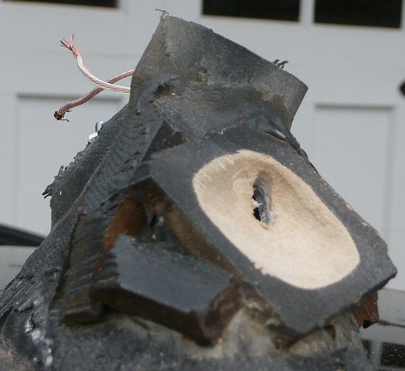

Here's some pics of the entry slit. The front side is copied off the Yorkville Unity, and the back side is copied off the Synergy Horn. You want the holes as shallow as humanly possible; that's why I went to all the trouble of grinding down the plate where the midranges enter the horn. With the Misco mids, you could probably get up to 2khz if you made the holes shallower. But it has to be a smooth transition, to reduce turbulence. It's basically a miniature version of the last picture, which is a subwoofer port.

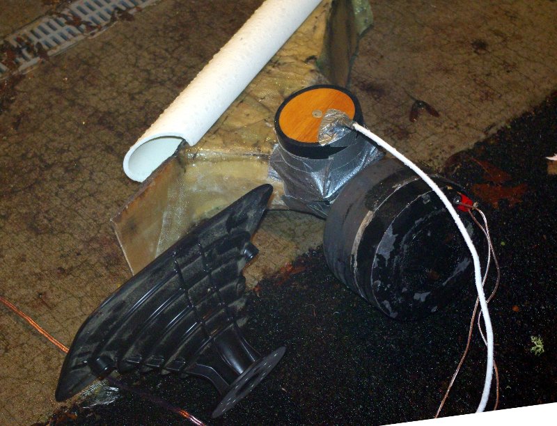

Also, it's a holiday, so I'm building a Unity horn for the house. It will like be used outdoors. It's pretty darn close to the Lambda Unity Horn, so it should be an interesting read.

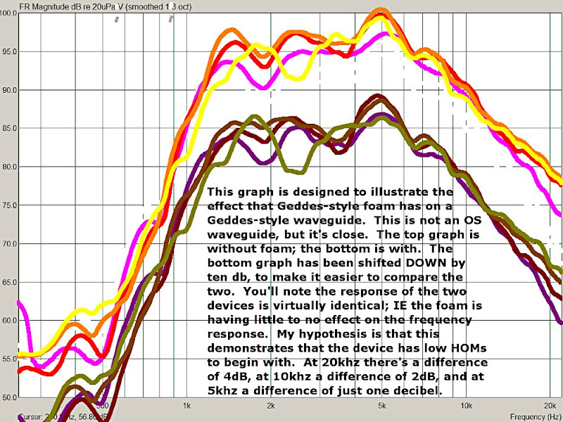

The best polar response that I've ever measured in a car was using a Geddes-style waveguide.
This is the polar response of a treated and untreated Geddes style waveguide, driven by a Celestion compression driver, mounted in the kick panels of my Accord coupe. You can see that the polar response is about as good as it's going to get in a car. (A 1khz sound wave is 13.5" long, so controlling directivity below that point is very difficult due to the sheer wavelength.)

The reason that I don't use this solution, and would not recommend it, is that I don't like my soundstage at knee-level. Also, I've found that the Summas are very sensitive to diffraction. For instance, if there's anything within a foot or two of the waveguide, it makes an audible difference. Most speakers don't behave like this. (I think this is because most speakers have so much diffraction off the cabinet, additional diffraction from the room itself is less noticeable.)
Anyways, even though the waveguides measure nice in the kick panel, I couldn't live with diffraction and reflection off the driver, passenger, and steering wheel. That's why my waveguides are on the dash.

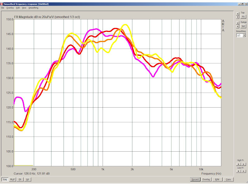

Here's the polar response of the project. This includes the BMS compression drivers, the TangBand midranges on the Unity waveguide, and the Misco horns under the dash.
This graph shows you the problems with the project:

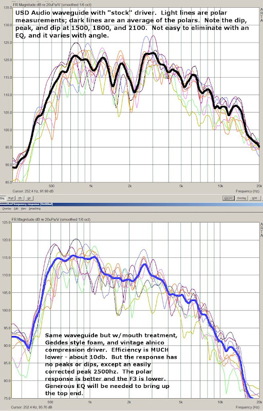

Here's the power response and the polar response of a USD Audio horn, which fits under the dash of my car. The top graph is with the "stock" compression driver. The bottom is with a JBL 2470, which I've modded extensively. The modifications include an aluminum diaphragm, a roundover on the horn, and Geddes-style foam inside.
The JBL clearly can't match the extension of my Unity waveguides, but it's hard to ignore that it gets down to 500hz. The BMS can't even get close; it's too small.
- We have enough efficiency to EQ this any way we'd like. Which is what I'm doing at the moment. The problem is that we don't have enough displacement to play below 400hz, and the polar response from 400 to 1600hz is poor.
- No amount of DSP or EQ can fix the problems with displacement and polar response; this can only be fixed with a larger waveguide, larger woofers, or woofers with more excursion.

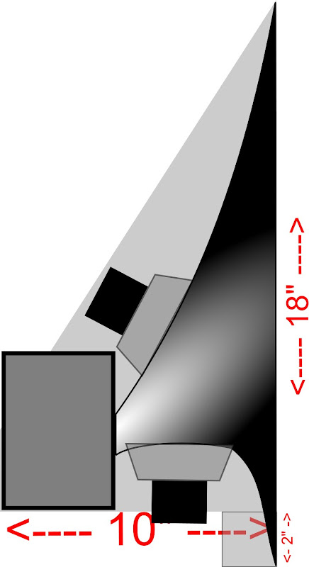

Instead of building a new horn under the dash, or trashing my USD horns, I decided to use one of my old designs to see if this will work.
(Read the last post for more info on today's project.)

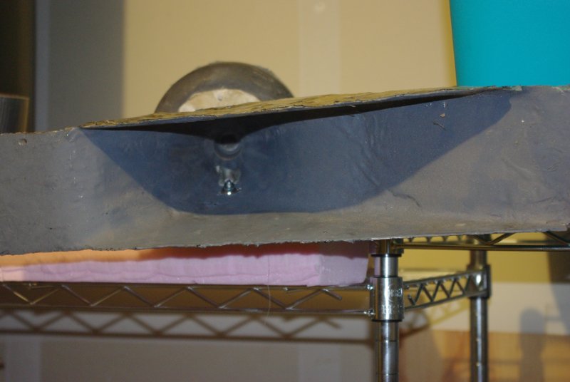

IIRC, I built this horn almost a decade ago, back in 2002 or so. It's a tractrix profile that's been chopped down to fit under the dash of a car. It's similar to the USD horns, but without a diffraction slot, and no bend. (The bend in the USD horn creates a notch in the response, see some of my old threads for the measurements.)
I'm turning the horn into a Unity horn. Up until now, I've used woofers that are good for horn loading on my Unity horns. This time around, I decided to use a cheap a/v speaker from Peerless. This particular unit is $15 from Parts Express and Madisound. It's parameters are crummy for horn loading, but I'm curious to see if it will work.
Here's the throat chamber, which mates to the horn. I really wanted to take a good pic of this, since the shape is an important part of the Unity design. In this detail pic you can see that the area of the port is deeply routed. This reduces turbulence, and basically makes a small port act like a bigger one. This is because the average diameter of the port is larger than if the walls were straight. Check out the patent on the Synergy Horn for more details. Also, the port is a slot instead of a cylinder. A cylindrical port, like the ones on the Lambda Unity, doesn't seem to work as well as a slot port. The Yorkville Unity uses a slot port.
The volume of the rear chamber and the front chamber is rather important. If the rear chamber is too big, the Fb of the enclosure will be too low. If the Fb is too low, there will be gap in the response between the compression driver and the midrange. For the Peerless, I aimed for an Fb of 350hz. That should give us a bandwidth of about 175hz to 700hz.
Of course all of this is just theory - we really won't know how much bandwidth we'll get from the Peerless until we build the thing, which is why I did this "proof of concept."
Staring down the throat, you can see that the slot port is a nice match for this horn. You can also see that the two sources are very close together, which is a huge part of "the unity magic."
There are pros and cons to moving the port very close to the compression driver; if anyone is curious about those pros and cons I can write a post about that.

![2470unity-3.jpg](https://lh4.ggpht.com/_wUDOCViv9D0/Syj0GdrGDqI/AAAAAAAACFs/lFqA22UVdWo/s800/2470unity-3.jpg)
![2470unity-5.jpg](https://lh4.ggpht.com/_wUDOCViv9D0/Syj0HTo2TEI/AAAAAAAACF0/obagu7J1Gsw/s800/2470unity-5.jpg)
![2470unity-6.jpg](https://lh6.ggpht.com/_wUDOCViv9D0/Syj0FbewQcI/AAAAAAAACFk/ZTU5_XA93Jg/s800/2470unity-6.jpg)
I still prefer the sound of waveguides ON the dash - it's the ultimate soundstage. But there's no ignoring the fact that it's easier to mount drivers UNDER the dash. Located there, the horns are virtually invisible, particularly if you paint them to match the car.
I've finished some crude ground plane measurements of this Unity horn, and I'll post those in the next few days.

If you pay close attention to the dimensions near the waveguide, you can reduce it's footprint by fifty or even eighty percent. This allows you to get good coverage with a waveguide that's much smaller than it should be. Basically the boundaries extend the WG. I have abandoned the project documented in this thread, and started a new one. If you'd like to follow the new one, here it is:
