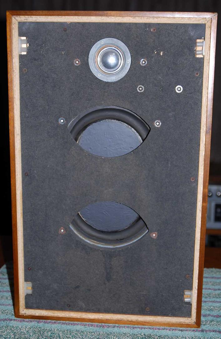

What is the effect of hiding the B139 in the Kef Concord?
If you have a look at the Kef Concord from the late 1960s, the B139 seems to be half hidden behind the baffle board:
Why would Kef do this?
What effect would it have on the sound output?
I am not really interested in the qualities of the speaker as a whole, I am aware that the B139 is only effective up to about 800Hz and that the T15 isn't really likely to cope adequately above that. I just can't understand the logic behind hiding half of the bass driver; particularly since in relation to this speaker, Kef say
Many otherwise fine loudspeakers at the time were ruined by their grille fabrics, which upset the frequency response ...
Kef LINK
Some sort of an attempt at using the baffle board as a phase plug to correct for frequency peaks or droops? According to this link audio-talk :: View topic - Kef Concord loudspeakers. "The Concord had B139 XOed to T15 at 1kHz, The B139 has a nasty resonance right near there and even using it as high as 400 Hz is pushing it. To get the tweeter to go that low its extension is not all that good. "
Factory data sheet here. TL Links

I must admit that that had crossed my mind but as you perhaps suggest, why waste half of a B139 when it would seem much more logical to use all of two B110s?
When you mask off the diaphragm it doesn't 'waste' any of the speaker. Output is determined by displacement*, and displacement doesn't change when you mask off the cone of a driver. So you basically get the output of an eight, with the directivity of a couple of fives.

I think thats right. The styrofoam diaphragm was known to have some serious modes fairly low down. The aluminum foil skin was a partial fix as first used by Barlow in the Leak woofer.
No different than a lot of tweeters where the first big vibrational mode can be reduced in effect with the right phase plug, forcing some sound portions from part of the diaphragm to go extra distance to offset how it is out of phase. Most likely there is a big beam mode with the center out of phase with the two ends.

SpeakerDave has it right. It is a phase plug to control the effects of cone breakup just as is done with rigid diaphragm tweeters. This allows the B139 to be used up to higher frequencies to cross over to the T15 directly rather than need a B110 as a midrange.
Not really a good solution: Both drivers are being used over a wider frequency range than is optimum. There will be consequences on distortion, coloration, directivity etc, but it is cheaper than a 3-way!
The idea that you can split a single large driver with a central baffle and make it appear as though it is two smaller drivers with a common acoustic center with the directivity of a smaller driver is pure hokum. Spaced drivers absolutely behave as spaced drivers, not as a common single driver. Just look at the impulse response off axis and you will see two non-coincident impulses. Its why center channel speakers behave so badly horizontally off axis!!

The "eye" holes are an acoustical band pass, to correct the woofer's peaking response above 1000 Hz would have required a lot of crossover parts, and still may not have been as effective.
Using the faceplate as an acoustical band pass cut the LF crossover parts count to one coil.
Looks like they got about the best possible results without adding the expense of going three-way.
