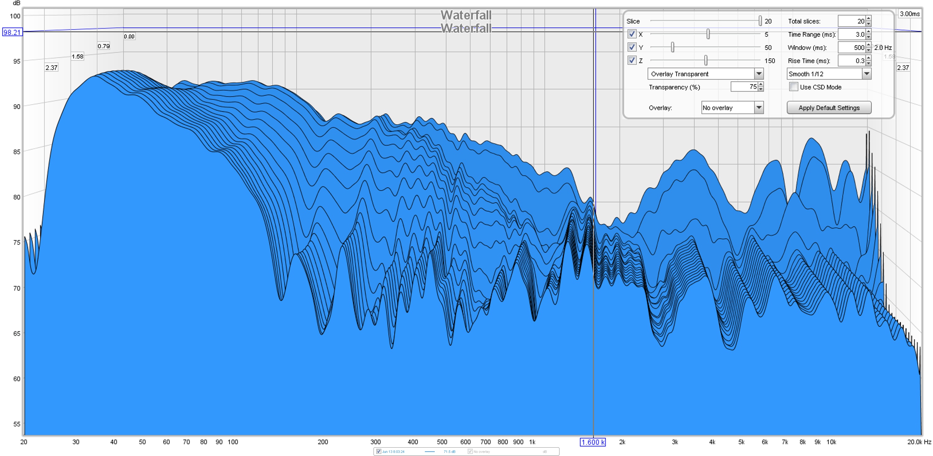

![554637d1465823538-making-two-towers-25-driver-full-range-line-array-waterfall-613.jpg](https://www.diyaudio.com/forums/attachments/full-range/554637d1465823538-making-two-towers-25-driver-full-range-line-array-waterfall-613.jpg)
Recorded with one mic at ear position shrouded by a dummy head and both channels playing.

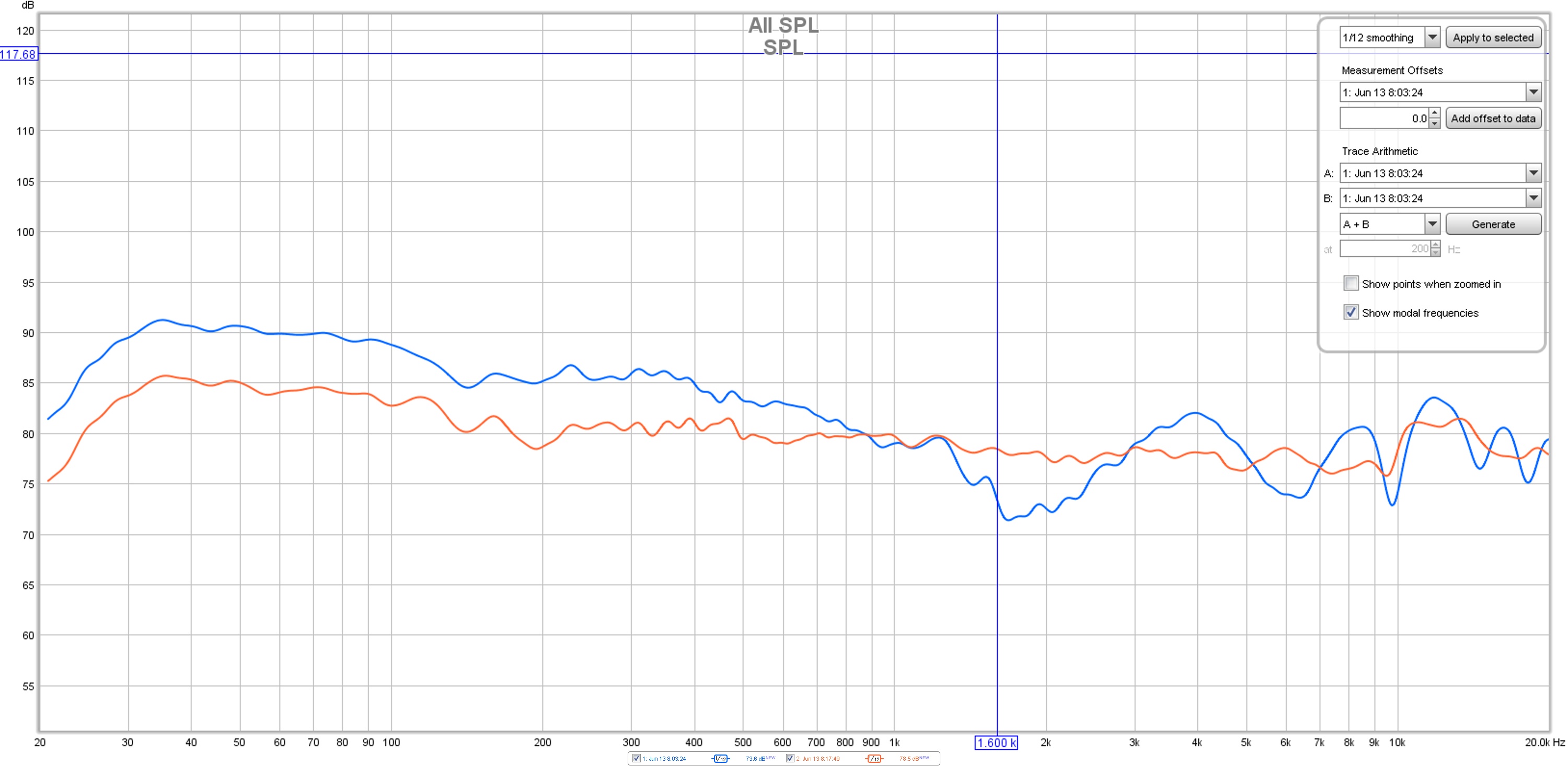

![554640d1465824012-making-two-towers-25-driver-full-range-line-array-spl0613.jpg](https://www.diyaudio.com/forums/attachments/full-range/554640d1465824012-making-two-towers-25-driver-full-range-line-array-spl0613.jpg)
A comparison of the FR of one channel playing and both channels playing, recorded at the ear position with one mic and a dummy head.
Looks pretty familiar, doesn't it?

The waterfall graphs seem like one of the most revealing ways to test a system, whether it's just a speaker or including the room acoustics. But Linkwitz made a good point when he mentioned that with the old MALISSA test system, the lower frequencies weren't turned on long enough for an entire period of waveshape to be analyzed, so the results would be wrong for anything below maybe 800HZish (I can't remember the exact frequency). So he purposed a variation that would be made out of gaussian envelop tone bursts that would have a consistent number of waveform cycles at each frequency, and be made out of incremental frequencies (many). Your waterfall software may already be compensating for this somehow. Just thought I'd mention it.
Excellent indeed! Just what we wanted to see. Yes, it does look familiar.Recorded with one mic at ear position shrouded by a dummy head and both channels playing.
Glad to see it - as I don't know that I will get to do any measurements here before I leave.

Yes nice to see real world situation from within a good room and system setup, verse pure left or right panned signal there is quite some difference comparing to your shared mdat-file called "16 04 28 LL RR wr: Mains + Ambient channels (1M)"
Yes nice to see real world situation from within a good room and system setup, verse pure left or right panned signal there is quite some difference comparing to your shared mdat-file called "16 04 28 LL RR wr: Mains + Ambient channels (1M)".
Sweeps with both channels driven are nearly always going to show some major differences in the mids and up compared to single channel measurements with a single mic.
Good thing we have two ears
