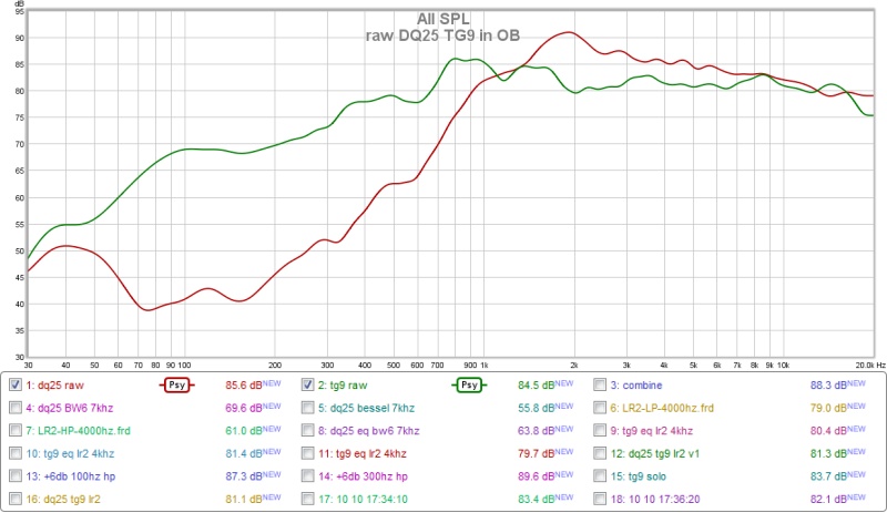

But here is a DQ25 + TG9 open baffle test platform for the start of this compact 3way project with XRK.

My idea here was to test an open baffle with the TG9, and also test if I would prefer the TG9 alone or with a small neo tweeter. I choose the DQ25SC15-04 since zaph gives it really high marks and uses it in several of his speakers. It is also a titanium dome so might be quite different to the silk dome RS28f that I already have. I have put it into a relatively simple EVA rectangular open baffle and have just offset the drivers slightly to try to control the baffle diffraction.

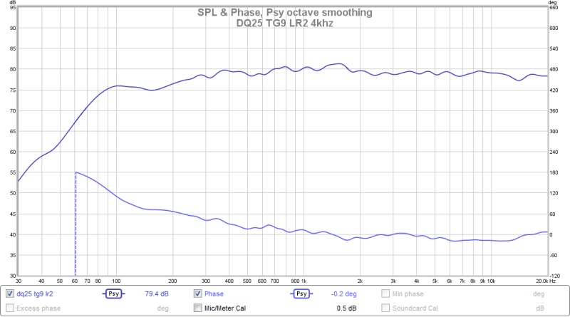

The center to center spacing of the drivers is only 77mm so I can do any crossover under 4800hz. I decided to aim at a 4000hz LR2. After a little EQ I was able to hit the LR2 target really well with excellent summing. I time delay the tweeter by 0.06msec to get the drivers time aligned. Somehow manged to get a linear phase and near perfect step response. Maybe because of the really high 4khz crossover?
Should be easy to mate this to a woofer maybe around 250-350hz. All measurements at 0.5m and approximately 80db at 0.5m.

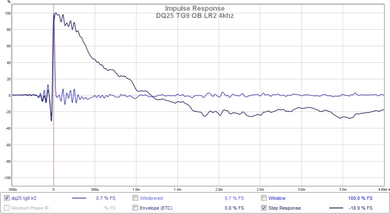

![508179d1444469646-eva-foam-performance-speaker-enclosures-dq25-tg9-ob-lr2-4khz-xo.jpg](https://www.diyaudio.com/forums/attachments/full-range/508179d1444469646-eva-foam-performance-speaker-enclosures-dq25-tg9-ob-lr2-4khz-xo.jpg?stc=1)
![508180d1444469646-eva-foam-performance-speaker-enclosures-dq25-tg9-lr2-4khz-dist.jpg](https://www.diyaudio.com/forums/attachments/full-range/508180d1444469646-eva-foam-performance-speaker-enclosures-dq25-tg9-lr2-4khz-dist.jpg?stc=1)
![508182d1444467723-eva-foam-performance-speaker-enclosures-dq25-tg9-lr2-4khz-fr.jpg](https://www.diyaudio.com/forums/attachments/full-range/508182d1444467723-eva-foam-performance-speaker-enclosures-dq25-tg9-lr2-4khz-fr.jpg)
![508181d1444469799-eva-foam-performance-speaker-enclosures-dq25-tg9-ob-lr2-4khz-impulse.jpg](https://www.diyaudio.com/forums/attachments/full-range/508181d1444469799-eva-foam-performance-speaker-enclosures-dq25-tg9-ob-lr2-4khz-impulse.jpg?stc=1)
I may have over eqed this, but I will start with this and see how I like it. Getting the DQ25 to hit the LR2 4khz target was pretty easy. TG9 was a little lumpy in the rectangular open baffle.
![508184d1444469799-eva-foam-performance-speaker-enclosures-dq25-tg9-ob-raw-drivers.jpg](https://www.diyaudio.com/forums/attachments/full-range/508184d1444469799-eva-foam-performance-speaker-enclosures-dq25-tg9-ob-raw-drivers.jpg?stc=1)
dq25
peak 1900hz -8db q0.5
BW6 7khz 0.06msec delay invert phase
tg9
LR2 4khz
low shelf 400hz +7db q0.7
peak 3400hz -2db q5
peak 1540hz -6db q10
peak 880hz -5.5db q2
not sure I would want to do this with a passive crossover though.

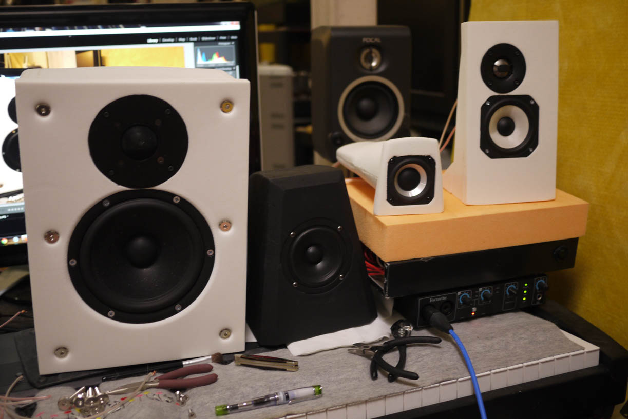

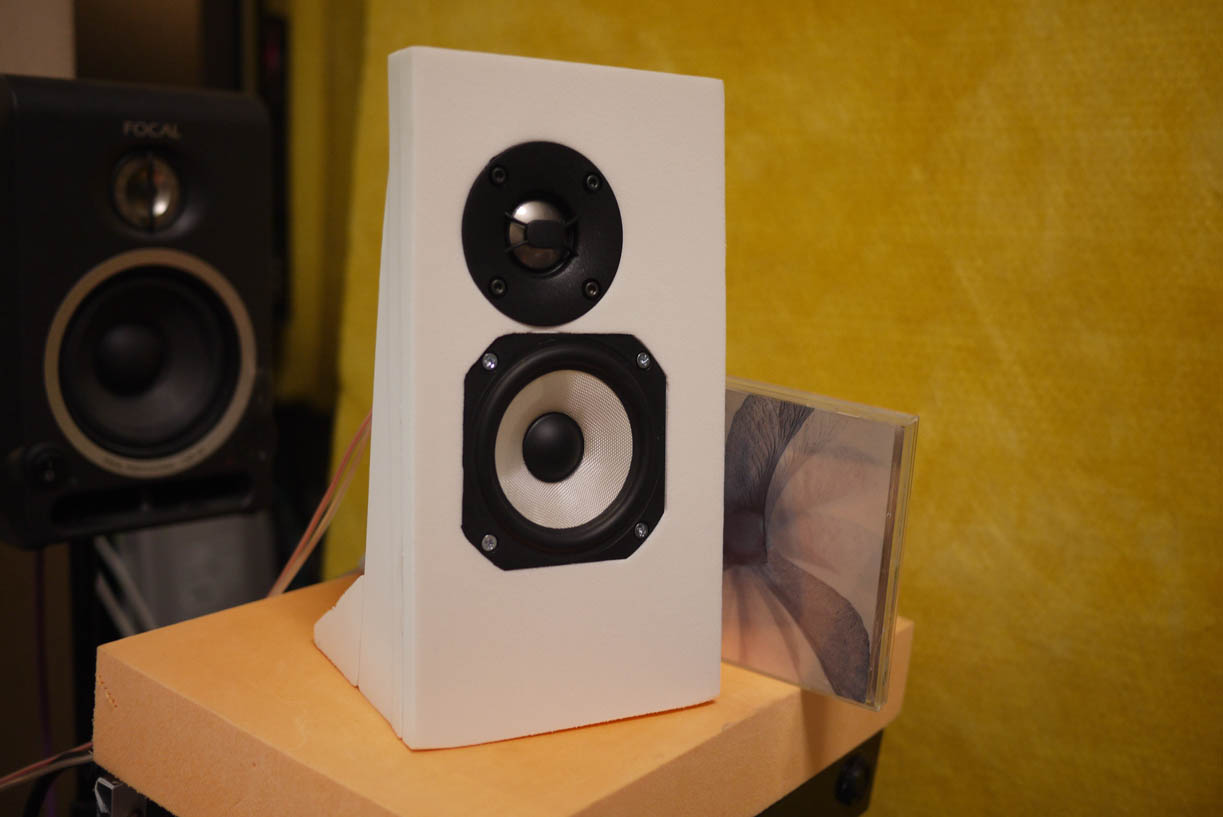

A little family picture for everyone
I may have to try the DQ25 with my Satori at some point but the RS28f works so well in that speaker that I don't really want to change it.
![508201d1444478307-eva-foam-performance-speaker-enclosures-p1110613.jpg](https://www.diyaudio.com/forums/attachments/full-range/508201d1444478307-eva-foam-performance-speaker-enclosures-p1110613.jpg)

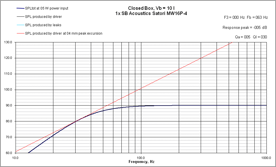

The way I calculate max SPL is to put the driver into unibox and raise the level until I hit the xmax. UniBox - Unified Box Model for Loudspeaker Design - Kristian Ougaard
for example here is my satori in a sealed box with a linkwitz transform (close to my current one) and the model says my max SPL is probably 90db. My design goal for the satori is a nearfield monitor for my home studio so I will listen at 1m distance and usually around 82db, so the 90db max is more than enough headroom. And in practice I find the sealed-LT Satori can play louder than I need and definitely louder than my focal CMS40 speakers.
For this I am using an xmax of 3.5mm since I read in several places that even though the satori has a published xmax of 6mm, the kipple data seems to indicate that it is more linear in the under 3.5mm range. So this is a very conservative estimate of max SPL for the satori. If I use the 6mm xmax then is shows 94db max SPL.
The Satori MW16P-4 is amazing in the midrange and does enough bass. The best way to increase your max SPL is to add a subwoofer (roll off the 6" at 80hz and add a 10" sub to handle the 30-80hz range). For example in the plot above, you can see that the Satori can do 100DB before the conservative 3.5mm xmax if you roll it off at 100hz.

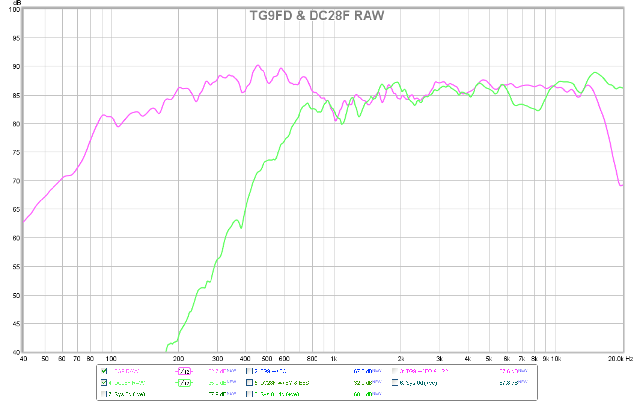

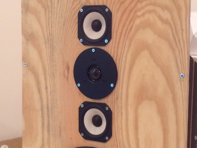

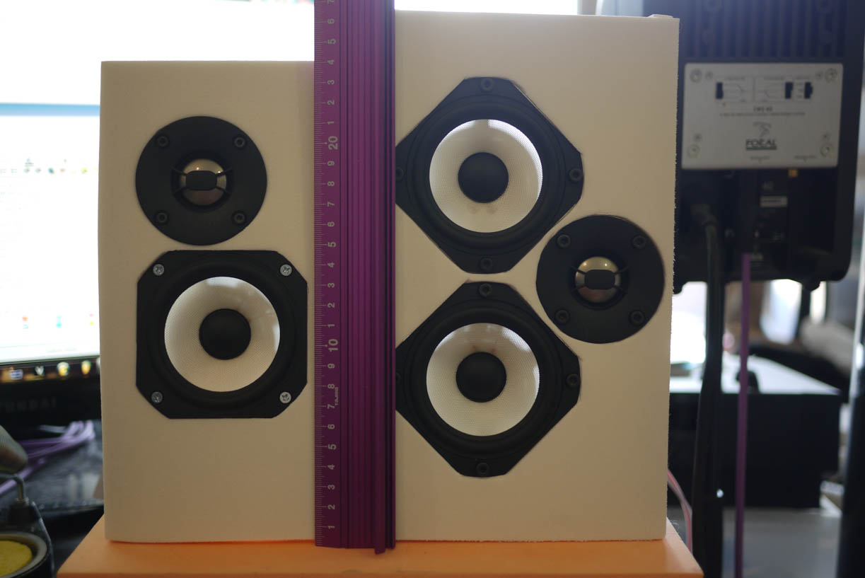

Dual TG9FD & DC28F in OB
Ok, I am going to try to follow your experiment but do it a little differently as I already have a setup with dual TG9FD's and a DC28F silk dome on an 18in wide plywood OB ready to go. So mostly a DSP XO topology experiment...
I am going to take a slightly different direction on the XO, sort of aiming for Harsch style or other asymmetric transient perfect design.
Here is a photo of the setup:

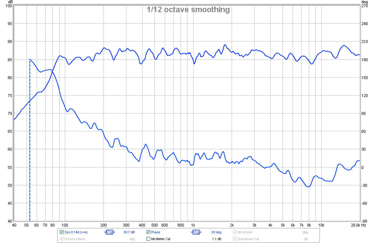

Here are the raw responses (an 18in baffle gets you a lot more bass extension before falloff):

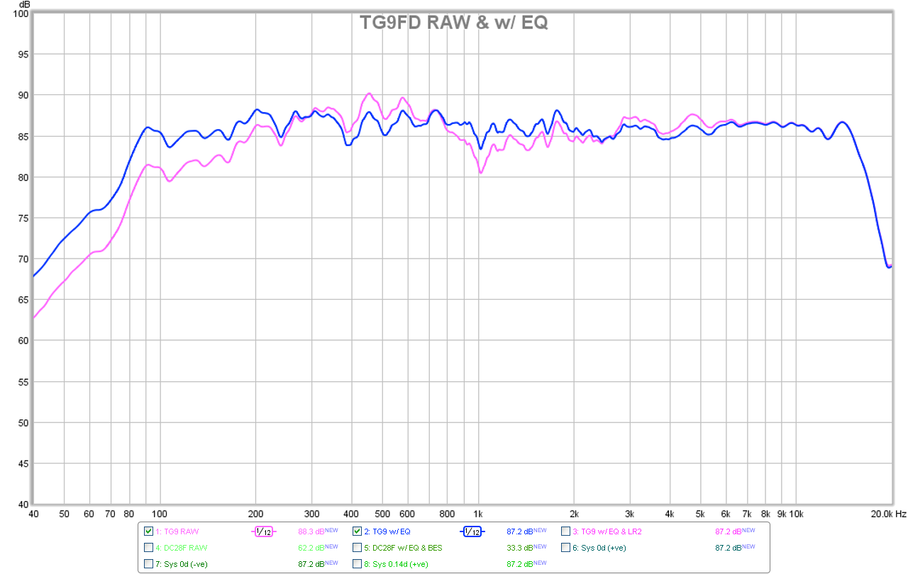

Here is raw and EQ'd response for TG9FD:

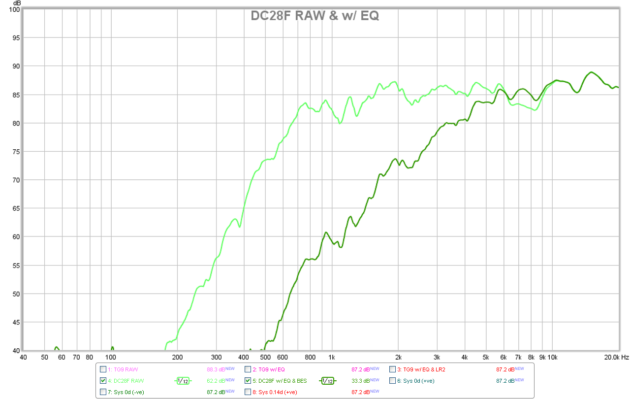

Here is raw (700Hz 2nd order Bessel HPF for protection) and EQ'd response for DC28F (with 2nd order Bessel at 4kHz):

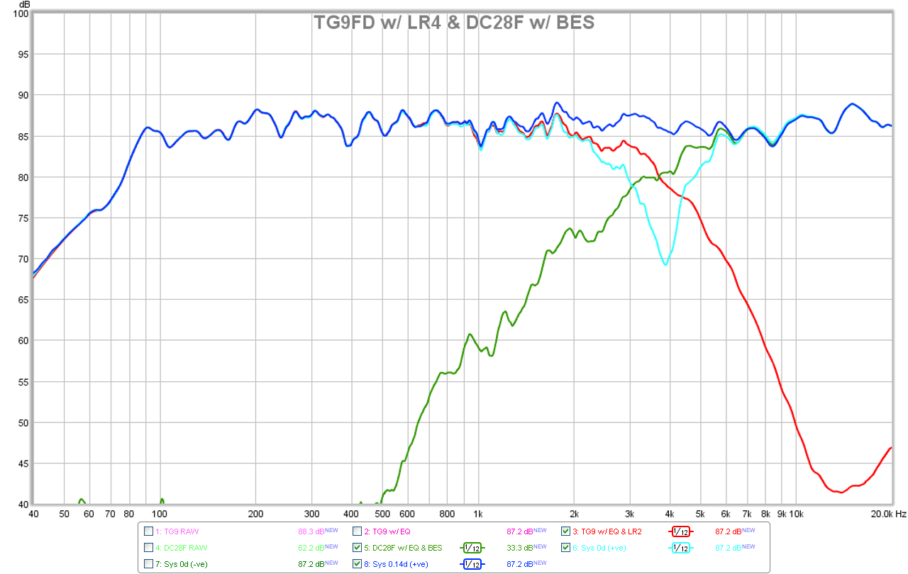

And here is the combined acoustic response with 4kHz LR4 on the TG9FD LPF and 4kHz Bessel on the DC28F HPF, resulting in 3850 Hz acoustic XO frequency as demonstrated by null from positive polarity and zero delay. However, adding 0.16ms of delay on tweeter (close to Harsch value with acoustic offset of TG9FD) and flipping to all positive polarity we get a nice integration:

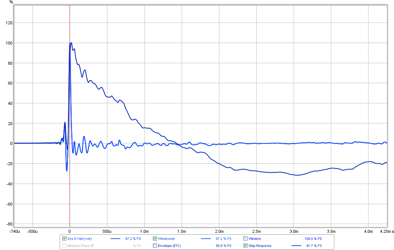

Here is the corresponding impulse and step response - transient perfect like yours:

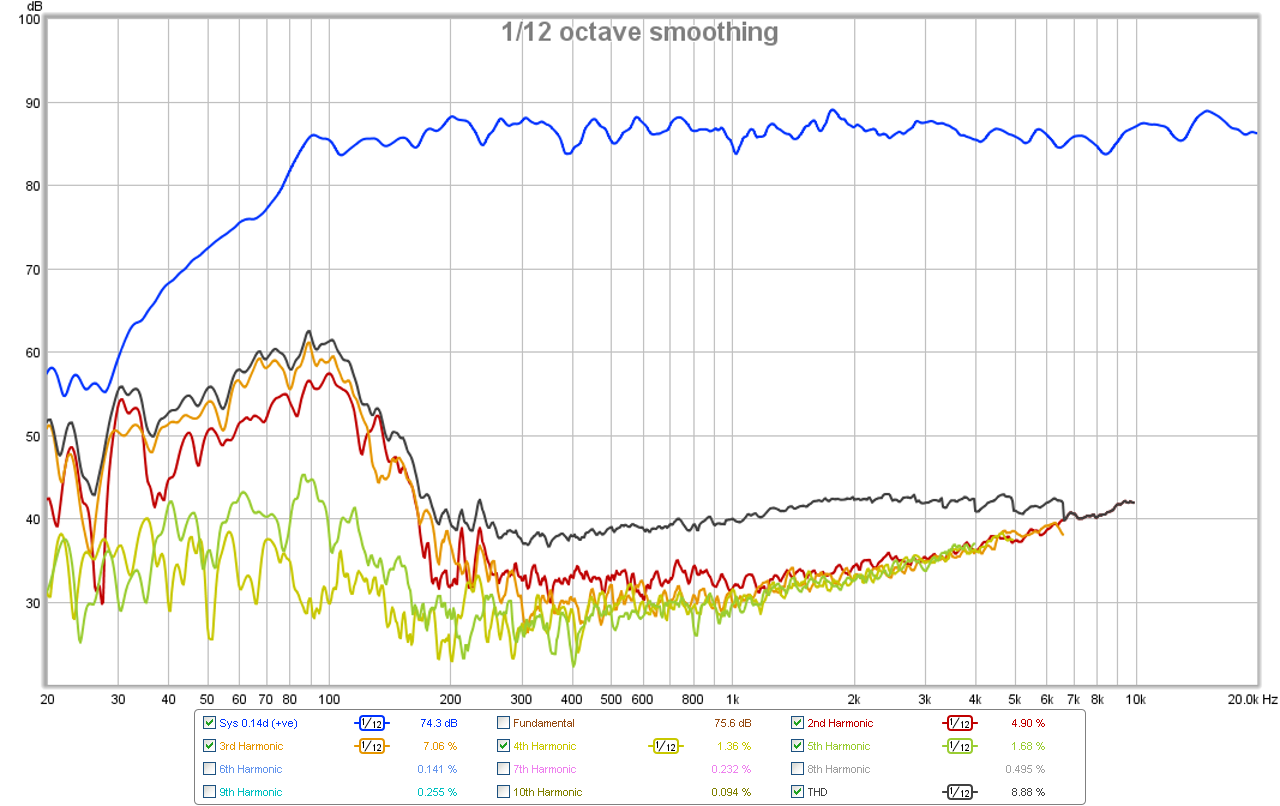

Here is the distortion - which says that when I add the woofer for a 3-way, if I cross above 400Hz, distortion should not be an issue:
So, it appears that a transient perfect can be obtained from an electrical LR4 and a Bessel. Probably in acoustic domain if I over-laid the textbook functions we are close to Harsch's BW4 and BES2 recommendation. However, the sharpness of the rise on the SR is better than what I normally achieve with the Harsch, so this may actually, be different. The key is to keep all polarities positive and adjust delay until integration is smooth and null dip goes flat.

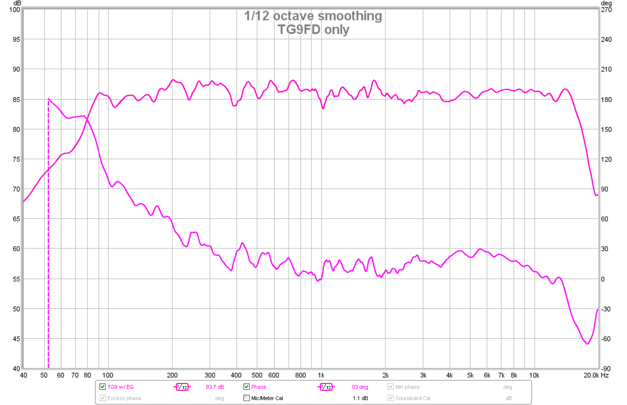

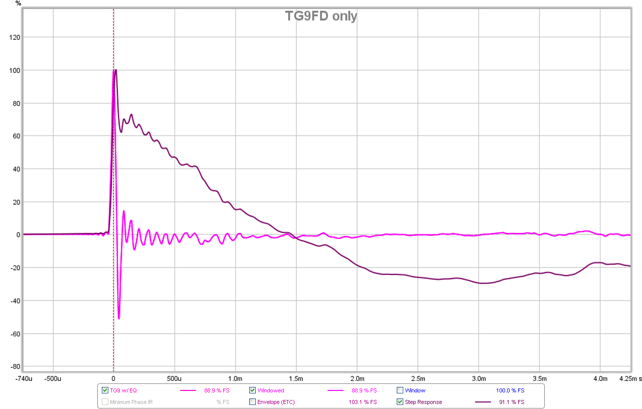

One may ask, why not just use the TG9FD all by itself, it seems to look pretty good after EQ? Well here is the TG9FD only phase:
And here is the TG9FD only IR and SR - not as good as the combined 2-way sysem - mostly because such a steep cutoff is acoustically imposed on the driver at the high frequencies. Byrtt has shown electronic experiments that show this causes the overshoot and ringing in the IR and leading peak on the SR.
![508204d1444480615-eva-foam-performance-speaker-enclosures-tg9fd-dc28f-raw.png](https://www.diyaudio.com/forums/attachments/full-range/508204d1444480615-eva-foam-performance-speaker-enclosures-tg9fd-dc28f-raw.png)
![508205d1444480615-eva-foam-performance-speaker-enclosures-tg9fd-raw-eq.png](https://www.diyaudio.com/forums/attachments/full-range/508205d1444480615-eva-foam-performance-speaker-enclosures-tg9fd-raw-eq.png)
![508207d1444480615-eva-foam-performance-speaker-enclosures-tg9fd-dc28f-xo.png](https://www.diyaudio.com/forums/attachments/full-range/508207d1444480615-eva-foam-performance-speaker-enclosures-tg9fd-dc28f-xo.png)
![508209d1444480615-eva-foam-performance-speaker-enclosures-tg9fd-dc28f-ir-sr.png](https://www.diyaudio.com/forums/attachments/full-range/508209d1444480615-eva-foam-performance-speaker-enclosures-tg9fd-dc28f-ir-sr.png)

![508210d1444480615-eva-foam-performance-speaker-enclosures-tg9fd-dc28f-hd.png](https://www.diyaudio.com/forums/attachments/full-range/508210d1444480615-eva-foam-performance-speaker-enclosures-tg9fd-dc28f-hd.png)
I listened to one song and it sounds quite good - characteristically transient perfect. Bass is a bit thin
![508214d1444481264-eva-foam-performance-speaker-enclosures-tg9fd-only-phase.png](https://www.diyaudio.com/forums/attachments/full-range/508214d1444481264-eva-foam-performance-speaker-enclosures-tg9fd-only-phase.png)

The dual TG9 definitely seems to have lower distortion though in the 200hz and up region. I think I am at a lower SPL than you but the pattern seems to hold. Both builds highlight the extra distortion that shows up below 200hz when run without a woofer
very cool!

This white foam is defintly looking fine !
That is very interesting. So all you need is a LR4 LP and a BE4 high pass, ad .16ms delay, and you get that...
Did you guys try the Neo 3 planar tweet from G&B (with a face plate wave guide in its PDR version) ?
I've heard most of the B&G neo planars. They are pretty nice, but I can't give you a detailed evaluation because the amps and source they were connected to were a limiting factor. (high power mosfet).
Here is the phase which is pretty looking linear:
I wouldn't call this STEP transient perfect but it has a good continuous flow in the phase. Transient perfect STEP would be flying higher for a longer duration.
My step on the same scale shows the difference:
![transient.jpg](https://www.rsr-concepts.com/diyma/transient.jpg)
See how it's still way up in the air? The triangle theory is fine but you have to look at the scale it is plotted on. In theory with flat response (the above STEP is with a different target) my step "crosses" the zero line at about 15 ms. Now this is of coarse a highly manipulated result. But that's how it looks if you get a flat phase result that follows the FR. The results Barleywater and BWaslo showed are also still flying high at ~4 ms. Of coarse it also depends on the low end extension. But the example in Stereophile of the Dunlavy IV was actually a bad example. It was measured way to close to really see it's step response. The speaker was optimised for coherency at a much larger distance. Once John Atkinson realised that he published a measurement at 3 meter:
which shows the step is still above zero at the 4 ms point (end of graph) and without knowing what the actual design distance would be the result could even have been better at 4 meter.
But the results you both are getting here show a smooth phase turn throughout the entire bandwidth. I.m.h.o. that is a good thing. It means the crossovers are smooth, the named targets are one thing, actually hitting them acoustically is key. This shows that EQ-ing to hit the target helps in getting a smooth transition from one driver to the next. It would also make it possible to straighten the phase with Rephase (for example) to get that transient STEP.
You might want to check the STEP at the listening position if you play with delay of the tweeter vs the woofer. The distances to the microphone are different if you step further back. I'd want it optimised at the listening position.
That's probably true in Jeshi's case with the small OB setup but I can't imagine listening to that rather big MTM at say 0.5 meter distance? So optimising and measuring the STEP at the listening distance would make the most sense. That's why you shouldn't measure the STEP of a big Dunlavy IV at close distances. The arched baffle, crossover and (passive) EQ are all optimised to hit target at that listening position. The big problem we have is room effects messing up the measurements to get it right...
