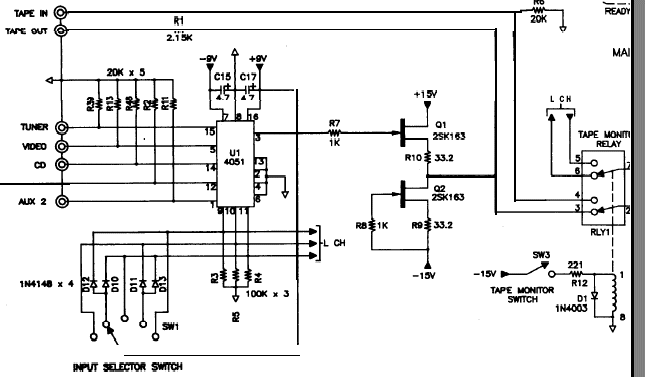

I'll probably get drawn and quatered for this 🙂 , but my "interim" preamp uses a scheme like this one from the Hafler 915 preamp.
It's not bad, sound-wise, and you can throw it together VERY quick. I use Maxim analog switches- higher power rails, MUCH better specs all the way around . I use 2SK389 as the JFETs (I like seeing the zero for DC offset).
