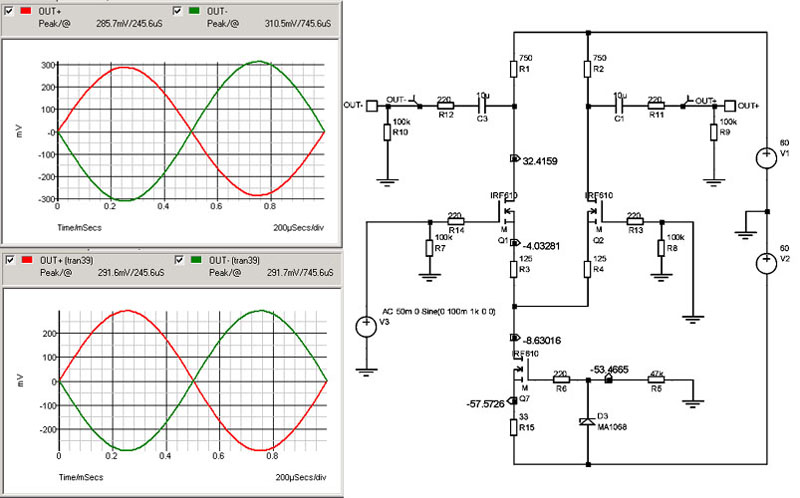

I use single ended inpuit (i grounded the other input, but it worked even without grounding it..) for bosoz and convert it to balanced on output, but when i apply sine wave at input i get 1v + phase and 0.7V - phase, i cant figure why (i used matched irf610s, metalfilm resistors...)..

When converting unbalanced to balanced, there is some
loss on the "undriven" side, which can by corrected by
having greater resistance biasing the diff pair, and gets
practically perfect when you bias the diff pair with a
constant current source. Your other alternative is to
reduce the Source - Source resistance of the diff pair,
which increases the gain also.

I used +-60v rails, there is -4v on source of each fet and +30v on drain of each fet, idle voltage on r15 is zero.. What do you mean with removing output cap, removing it and putting normal wire instead of it?

Got your post Nelson, so I have to use constant current source.. Can you or someone else post schematic of modofied bosoz with current sources then. or just schematic of current source..

Anyway, it sounds like yours is working in light of the advice from Nelson. My incarnation of BoSoZ uses a contant current source, so I never noticed this assymetry. Apparently it is normal, which makes some sense now that it has been pointed out.

As Mr. Pass said: "When converting unbalanced to balanced, there is some loss on the "undriven" side".
You have a loss at the output at around 30%, it seems too much to me.
I am using my BOSOZ as an unbal. to bal. converter, I do have some loss at "the undriven side" but not more than around 10%, and until now i have not considred this lack of mismatch to be a problem, but i could be wrong. I would like to other oppinions on this question!
The question is, do we get better performance by adding a Constan Current Source, or will the small mismatch from the passive circuit be les significant than an eventually degrade in sonic performance caused by the change from passive to active currentsource.
Grey has "bin there" in a long thread, but that was in relation to SOZ, and since BOSOZ an SOZ do have the same topology, one could get the idear, that his experince could be usefull here.
I my self like the passive topology very much.
You should read Nelsons artickel "DIY OP Amps", you can get from WWW.diyaudio.com .
I have simulated a simple Constant Current Source.
The upper left diagram shows the original BOSOZ, and the one under BOSOZ with CCS, simulated from the circuit at the right.

Regarding your first post.
I have done some sims on this.
If R15=124E the loss at undriven vill be around 8%.
If R15=375E the loss at undriven vill be around 20%.
The loss at the undriven increases with lower value for R15.
So if you have chosen the lowest gain and distortion with R15 >= 400E tis could be an explanation or a part of it.
