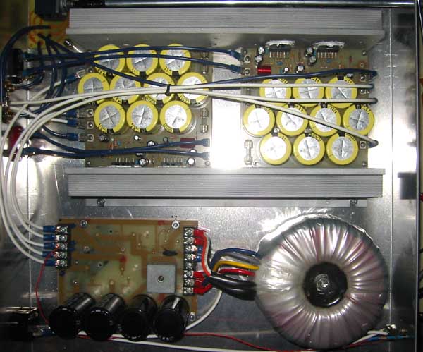

I've built a simple stereo amp using LM3886's. There's two LM3886's bridged on each channel. The power supply is built from a Plitron 2x22VAC 400VA transformer and 60,000 µF of capacitance for each channel.
When I input an audio source in one channel, everything is fine and the sound is pretty good. However, when both channels are hooked to the audio source, the sound looses all its bass and depth. What the hell is going on? I don't think that's the kind of problem caused by a ground loop and I strongly believe there's enough power in this amp to supply the two channels.
Below is a picture of the problem. Note that the board in the lower left corner was a regulation board...I converted it to a 'do nothing' board. It already had the bridge and connectors for the transformer so I thought it could still be useful.

Are you sure that you don't have the phase reversed in one channel? That would make the bass go away. That would be easy to do with a bridged amp. Just try reversing the speaker connection on one channel. If that fixes it that's the problem.
Later
Bruce:geezer:
PS: Nice looking amp. Good job.

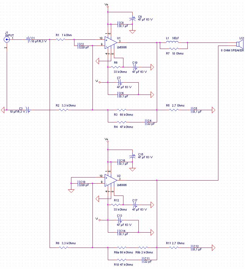

This is it:
MWP> Wow i am impressed with your amp are you trying to give Jeff Rowland a run for his money.. Hee... HEE.. Heck i was impressed with just using two bridged Pairs for a great 60 to 100 watt Per Ch. Amp for my PC. but heck your Beast is way Cool. Is that from the BPA 200 app note?
Skinny Boy> I was refering to whitch one of the several Bridge Circuit configuations available for this and other Power Op Amps some use the method that MWP is sugesting others tap off the Output of one and feed into the input of the Other and several others are used for this as well. The PM 21 as on the Link above uses MWP's method and is the one i also used. The Rane MA-3 also uses a LM-3886 but not in the Bridge mode. What a popular Chip National semiconductor has.
