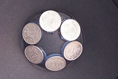

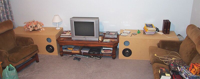

First off, the idea of this project was to see just what I could get out of a dirt cheap driver. Jaycar has an 8 inch 30 watt paper cone woofer for ~AUD$30 http://www1.jaycar.com.au/productVi...&pageNumber=&priceMin=&priceMax=&SUBCATID=383 and on paper it looked just what I wanted. The T/S parameters looked good too, so I went and got a pair. Got then home and measure the parameters and they were just way off! e.g. resonance was 60Hz, not 39. Soooo..... rather than take them back I got to work WinISD Pro and looked at the effect of adding mass to the cone. I ended up (temporarily) sticking six 10 cent pieces there = 0.6 ounces total and it got the resonance down to 35.9 Hz. The boxes are tuned to 33Hz and down there they really hammer. External dimensions are 500 x 500 x 1200mm. It's just amazing what you can get out of a little speaker if you give it half a chance. Soon I will do some in-room measurements. I am going to end up biamping for sure. The whole cost was speakers $30 each, Wood 18mm MDF $78 including cutting, second hand carpet for lining, 128 screws = $8. Cheap as dirt. Top fun.

I am not at liberty to say..... But you could have spent twice that on the drivers, and half that on the MDF..... Would cost the same and be smaller... thats all..
Nah, just silicone sealer like you would put around the edge of a window or something. I did try superglue but it would not stick. The coin mass I said before was incorrect. It is a total of 6x 0.2 ounces, not 0.1 .LaMa said:Which type of glue did you use to mount the coins? Is het hotglue?

Would It Sound Better With Dollar Coins ?

The top line is not entirely smart **** - when you drop a Dollar coin, it sonically rings quite differently to a 10c coin.
As to the added mass you impress,
I would try titanium and never aluminium,
and in my guesstimation,
Mallee Root would be a hoot.
