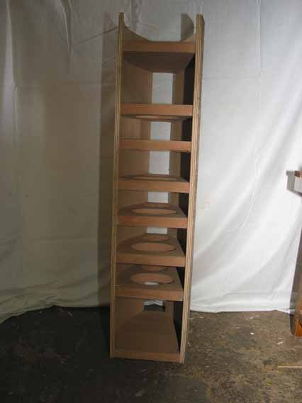

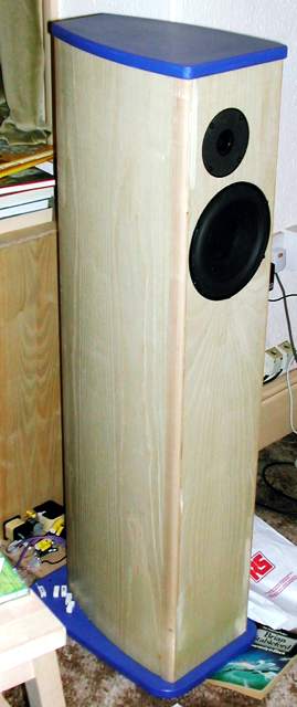

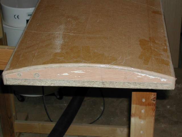

when i built the cabinet shown below i found that mdf was tougher to bend than ply. i used 3 layers of 4mm marine ply and alternated that with 3 layers on 3mm MDF.
to do this i first built a frame. each layer was laid on the frame. each subsequent layer was nailed and glued to the earlier layers and kept in place by over a dozen c clamps to dry over night. I managed 1 layer per day. cust lay, glue, clamp, nail. and i needed help.
took me 24 days + to complete 4 sides.

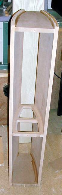

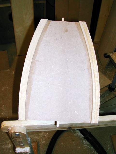

Each side was left overnight to dry and then I cut the top and bottoms to a matching profile with a router and mounted them on a stongback, a plank that secured the ends aligned and the correct distance apart, the sides were then glued onto the ends in the jig and the strong back then formed a reference platform for the router to trim the front and back flat. The dowels in the picture are used both to align the ends on the strongback and to locate the front and rear faces.
The brace can then be clipped into the body and glued into place before fitting the bitumen damping and foam, the panel, behind the speaker is the front before cutting the holes for the drive units. I made it this way as a trial run, using scrap I had lying about, but I would say that 6 mm mdf is too thick for this, I dont feel that the speakers are long term stable and will start to delaminate. I am now designing a more advanced construction, to be laminated from 3 mm ply to get a home brew version of gridded bracing inside the curved panels, for my next project, which is currently a mix of a faber style body with the EVEII units and XO as a starting point.
Hope the method seems clear.
mike.

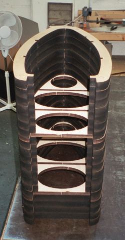

I used exactly 3 sheets of 2400 x 1200 (8' x 4') mdf at 25mm (1") thick.
The cnc work was perfect. Nice sharp edges, etc. Took them over 2 hours to cut everything. Each rib has 6 10mm registration holes in it which I'll slide dowels thru to line it all up. I start gluing it up next weekend.
What the major advantage to the extra expense of more board and cnc cutting is, is that cabinet assembly is like putting together a big 3D puzzle. Lots of gluing and time but I'm expecting it to be very satisfying from a DIY perspective.

laminated side jig

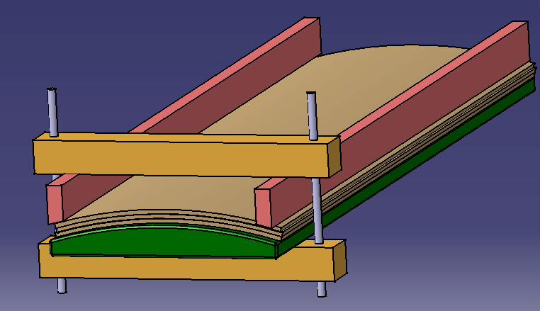

to explain the process I used to to make the curved panels shown above I have created the picture shown below. The green part of the image is the former, this can be made as a tramslam by pattern routing 30 or 40 profiles and gluing them together
The sheets for lamination (shown in pale brown)are cut to size, tite bond applied with a roller to all the faces at once and bound at both ends with parcel tape to keep alignment and placed in the jig as shown.
I have only drawn one set of clamps but I had 5 sets on a 40" length. The pink pressure rails are screwed to the top clamp bar to keep them at the correct spacing and the gray rods are lengths of threaded rod and nuts and washers. You then move around the jig tightening the nuts one or two turns at a time, until the edges of the laminates are pressed down on to the base. Leave the whole thing over night and the next day you have one perfectly curved panel. I used some pre-veneered 6 mm mdf I had lying about but it would be easy to veneer the curved panels at this point.

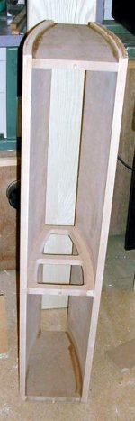

Once the panels are made I cut the endpanels to fit the inside curvature using a router on a trammel, I establish the correct radius by trial and error and then make the set of 6 in one go (4 ends plus two braces)
I position the end panels in this jig by using small diameter dowels (1/4") placed on the center line of the endplates, these dowels are then used to center the end caps on the strongback, purple in the image below.
The orange ends are clamped in this jig and the curved side panels glued in place. Once the glue has dried the clamps are removed and the blue strongback fitted.
The flat outer surfaces of the strongbacks provide the register surface for trimming the edges of the panels using a router.
To finish I edge the front and back mdf panels with solid wood and after fitting the brace bitumen panels and wadding The are glued on using the dowels for alignment
When dry a combination of routers and handplaning finished the curved corners
