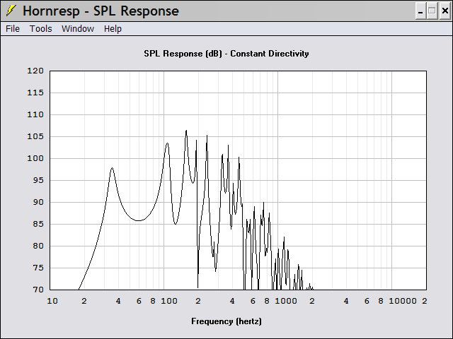

Here's the measured response of the th-mini, showing a F3 about 50hz or so.
Here's the frequency response. This is with 200 watts into an 8ohm load, which is about 300 watts into the 5.5ohm P-Audio woofer. At this level, you're just about running out of excursion, and you'll need a subsonic filter at high SPLs.

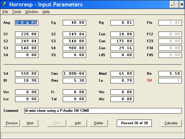

The enclosure is basically equal to the TH-Mini. The TH-Mini has an external size of 4.17cf. This clone has an *internal* size of 3.4cf. Once you factor in the woofer and the wood, you're looking at an equal footprint.
Note the efficiency is lower - however the F3 is slightly lower also.

Wanna buy that P-Audio woofer? Here's where you get it for $150:

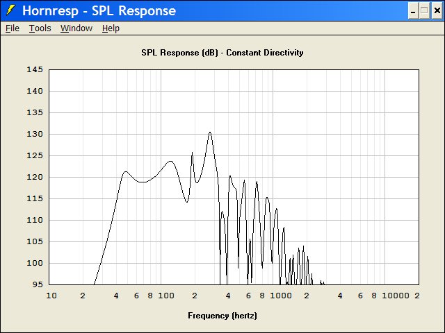

Here's a simulation of the enclosure above, with the B&C 12PS100, the same woofer I believe Danley Sound Labs is using in the TH-Mini.
The response is all but identical; it's a bit shallower in the midbass. The B&C has more excursion, will play louder, and costs more.

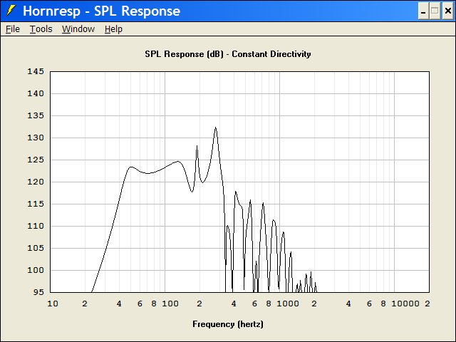

Here's what the response is like with my favorite cheap woofer.
Admittedly it's rougher than the B&C or the P-Audio, but that's because the FS of the MCM is way too low. In the real world, it won't be as peaky, especially if you use two or three cabinets.

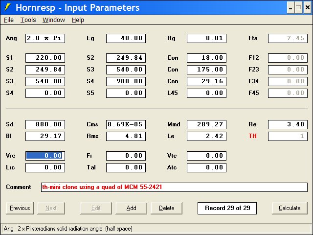

Interestingly enough, a *quad* of MCM woofers has the best response of all. They offer the flattest response, the lowest excursion, *and* the lowest price. At 45hz the MCM has a full four DB more output!
The MCM 55-2421 is very hard to beat.
Check out the response graph.

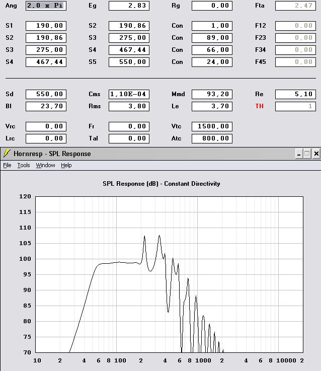

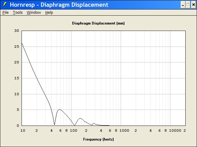

Still cant get my head around Hornresp.
Driver specs:
Power handling: 600 watts rms
Voice coil diameter: 2"
Voice coil inductance: 1.81 mH
Impedance: 4 ohm
DC resistance: 2.60 ohms
Frequency range: 20-450 Hz
Magnet weight: 112 oz.
Fs: 18.8 Hz
SPL: 90 dB 1W/1m, 93.4 dB @ 2.83V/1m
Vas: 232.2.
Qms: 8.66
Qes: .39
Qts: .38
Xmax: 15.1mm
Re: 2.8
Le: 1.82
Mms: 297.1
CMs: 0.24
Sd:829.6
Vd:1252.7
BL: 16
Trying to put this into a box of roughly 104.5 L
I don't understand how to get some of HRs measurements. Like Rms and Mmd. I also haven't figured out how to define box parameters. Layout equals a 13 foot horn length (roughly) within the space of 7 folds. 13 foot would (roughly) get me the 1/4 wave length for 50Hz ?
Help a laymen comprehend?

"Trying to put this into a box of roughly 104.5 L"
The driver you listed is not suitable for a 50hz tapped horn.
"I don't understand how to get some of HRs measurements. Like Rms and Mmd. I also haven't figured out how to define box parameters. "
You don't have to understand them, just enter as required. The 'HELP' section tells you how to do this. The program calculates what it needs from common T/S parameters.
"Layout equals a 13 foot horn length (roughly) within the space of 7 folds. 13 foot would (roughly) get me the 1/4 wave length for 50Hz ?"
The speed of sound is roughly 1130 ft/sec, the 1/4W of 50hz is thus 5.65 ft, or 67.8 inches.
As you can see from my 50hz AkAbak script, the main horn length is 1.78m, or about 70 inches.

As already noted, this is a very poor choice for a 50 Hz TH, especially in ~104.5 L due to its high Vas, but curiosity got the best of me to see how poor a choice it is:
