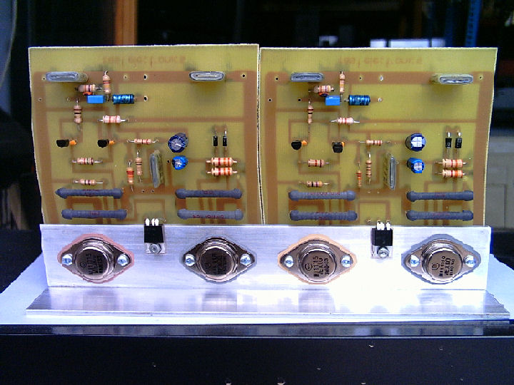

i spend a year working with that playing here and there i managed to get 175w off it
but its extremelly unstable
there is a picture of my version using far more advanced transistors from on semi mj 11015-16 but still ...at high rail voltage like 50+50 volts is trully unstable
plus the originall working at low voltage may be 40+40 volts is not stable at all as is

I have made it, and was dismounted as i did not have apreciated the sonics.
But i could fix the unstability problems.
Was dismounted as i do usually, to have parts to check other circuits..only 8 amplifiers had my respect and are assembled.
I have tried more than 4000 units.... they were in almost 36 groups of different schematics, with different circuitry.
Install a 18 picofarads capacitor in parallel with 22K resistance, the one at the feedback line....one side will go to the output line.
Install 470 to 680 picofarads capacitors into the output darlingtons, from colector to base.
Install a 47 picofarads capacitor into the TIP41, from base to colector.
It will work fine.....as i did that and worked for days without problems...the audio quality was the problem.
Suggested modifications were sent to Mr. Sakis...i have a copy of the mail sent to him.... he forgot that mail, or did not have received it.

This amp does work, sort of, might do for a beginner because it's as simple as can be, but you'll spend the same and have a *real* amp if you build this one:
