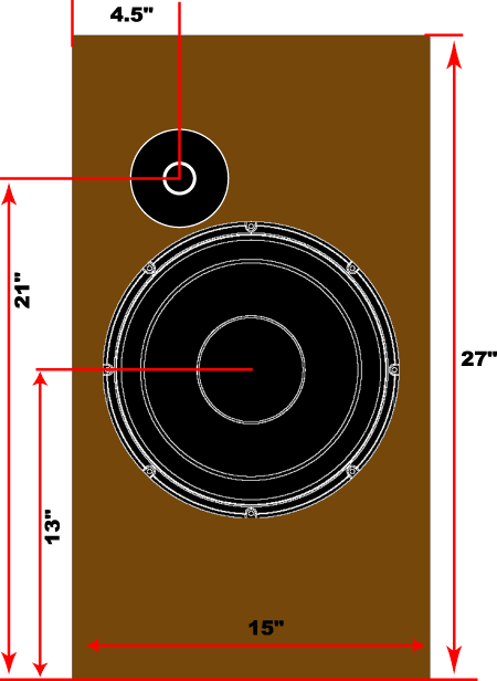

First the baffles:
They are 15” wide by 27” tall. Chipboard, MDF, plywood etc. will do just fine. Mirror image tweeter placement for left and right.
Some sound deadening (simple automotive spray) should be put on the baffle back. Typically they sound balanced with the baffle face being from 30" - 38" from the rear wall and at least 36" from side walls. Only about 83 dB sensitivity at 1 kHz and -3 typically from around 40 Hz to 22 kHz on axis up to 14' of listening distance. You will want to elevate the baffle off the floor with a target height for the tweeter of 42", depending on your listening position.
It’s easy to build a speaker that sounds much better than it should, and much better than a lot of other speakers you’ve heard.

First the baffles:
![245580d1319131921-fast-fun-inexpensive-ob-project-new-baffle.png](https://www.diyaudio.com/forums/attachments/multi-way/245580d1319131921-fast-fun-inexpensive-ob-project-new-baffle.png)
![245581d1319131921-fast-fun-inexpensive-ob-project-new-wing.png](https://www.diyaudio.com/forums/attachments/multi-way/245581d1319131921-fast-fun-inexpensive-ob-project-new-wing.png)

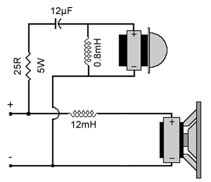

Let’s look at the crossover.
Drivers are electrically in phase. Woofer exhibits a 2nd order acoustic roll off at the top and no roll off on the bottom down to the mid 30's in a small to medium size room. (up to 2800 cu ft – 80 cu meters or so). They will sound best near field (8' to 14'). The tweeter has a forth order acoustic roll off around 1350 Hz. A pair will deliver clean sound on most recordings up to around 94-98 dB.
Why the big inductor? A 12mH inductor on an 8ohm driver is a first order low pass of about 105Hz. That’s seems awfully low to cross to a dome tweeter, right? But the idea here is to tilt the woofer response down to make up for the bass losses suffered in an open baffle design. If left alone or crossed at a more normal point, the 12” driver would have very little bass on an open baffle of this size. We need to “boost the bass.” The only way to do that with a passive filter is attenuate the high end. That’s where that part about throwing away certain things comes in. We throw away efficiency in the midrange to keep the low-end balance; otherwise the tonal balance of the 12 would be far too bright.
The big inductor does this FR tilt for us by pushing down the top end response - it’s an old trick for open baffle speakers. If you’re not using a box for the bass, you have to give up something. In this case we trade away efficiency.
The crossover on the tweeter looks a little more normal, a simple 2nd order high pass with attenuation. But there is some staggering of values from textbook values. This stagger helps bring the tweeter into phase with the woofer, among other things. The 25R resistor pads the tweeter down to the woofer’s midrange level.
The side wings of the baffle are asymmetrical to help smooth frequency response. Tweeter placement is also chosen for smooth response and to mate well with the woofer. Note that left and right baffles should be mirror images. The tweeters will be toward the inside edge when the speakers are in their playing position.

MJK said:You specified "25 ohm 5W resistor", could this be 5 ohm 25 W? Is this a typo?
Probably is a typo. I'll double check. Thanks for catching that, Martin.
Love the simplicity of this, my only concern is the efficiency, but you can't have it all....
I think 25 ohms is about right actually, if the 12mH causes a drop off of 6dB/oct, at the xover freq the woofer should be around 20 dB down. Of course this will be offset by the rising response beacause no zobel is used, the calculator here
http://www.sengpielaudio.com/calculator-Lpad.htm
gives 13.7dB attenuation using the quoted min Z of 6.5 ohms + 25ohms in series
5 ohms only gives around 5dB, which would probably be way too hot in this speaker...???

Talked to JB, the designer. He says 25 ohms on the tweeter is correct. Why? Just because that's what worked! And I can tell you first hand the tonal balance was right, tweeter not MIA.
"You have to remember this is a DIPOLE, so there is a substantial rear contribution up to over 2K . [don't forget the] first and second harmonics that the woofer produces and the rear radiation of which is bouncing all around the room reinforcing the total presentation." Says JB.
If in doubt, buy yourself a big varible resistor and dial it up and down to find what works for you. 25R would be your starting point. At least that's what I think.

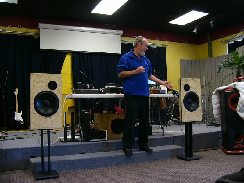

I had the chance to hear the Manzanitas at the NCDIY meet on Saturday. JB was very articulate in presenting the design. They do indeed sound good, though they were handicapped by the room which was way too big for them.
Here's a pic of the speakers and their builder:
