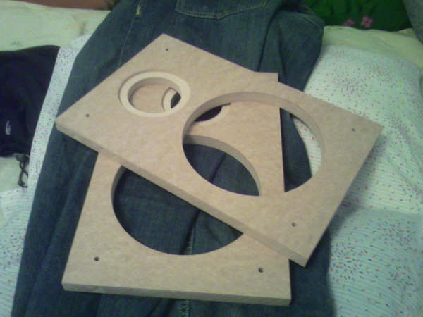

Just a small update, the woodworker has been contacted and he gave me a time frame of 2 weeks for the cabinets. The parts were ordered today (will ship tomorrow at the earliest), so if all goes as planned this project will be built inside of a month.

My parts order from Solen arrived today, the 3mH steel laminate inductors from Madisound should be here any day now as well.
I am a little disappointed, however. I had thought that by now there would be no old DST stock and I would get all Tymphany parts, but one of my woofers has an old DST Peerless label on it, and one has a Tymphany label on it. What disappoints me is that the cones are slightly different. The old Peerless driver has visible fibers that give a little bit of a sparkle if the light hits the cone just right. The new driver does not. It resembles a regular paper cone, so it looks like Tymphany has switched from a long fiber Nomex cone to a short fiber. This is something that can only be seen up close, but I do wonder if the drivers were measured for frequency response and distortion if there would be any measurable differences.
The other thing I noticed about the Peerless HDS drivers is that from the images I've seen looking at them on the internet I expected the frame and phase plug to be a shiny aluminum look, but instead they are actually painted light grey (I think it's a powder coat). It's not that big of a deal, they still look very nice, just not what I was expecting.

Consistency...that's the problem of Peerless products, as Zaph mentioned. Seas is known to be far better in this regard. I hope you won't have any problems because of that. Can you request replacement for that reason?
Nice looking kabinet, is there any special reason fore placing the 4 "stiffeners" vertical ? I think it would be better to place them horisontal if it's fore resonance damping.....just a teori doesn't mean that its the right way to do it..🙂

Well, the largest panels are the sides so they will be the ones that will vibrate the most. I'll see once they're built if I think they need a couple boards from front to back as well. The bracing (the entire cabinet design really) is just a copy of Zaph's tower design for his Vifa XG MTMs. He seems pretty on the ball, so I figured the bracing is quite sufficient.ROVSING said:Nice looking kabinet, is there any special reason fore placing the 4 "stiffeners" vertical ? I think it would be better to place them horisontal if it's fore resonance damping.....just a teori doesn't mean that its the right way to do it..🙂
