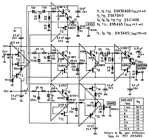

Just to get the ball rolling on active crossovers, I'll present a few schematics for your consideration and amusement.
Let's start with one that is known to sound very, very good. Solid sate, combo of bipolar and jfet. The Kaneda active filter. A true benchmark. Came as 2 or 3 way filter.

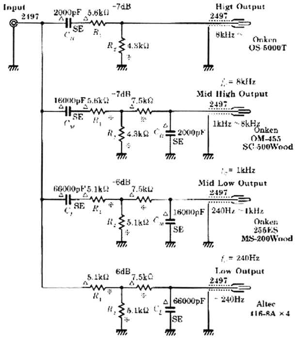

PLLXO 3-way
Here is another approach that I believe also belongs to Mr. Kaneda. About 20 years later, circa 2004.
All passive line level. You want to be sure to have a good beefy line drive in front of this.

If I ever did another one, for 2 ways, I would just design the low pass, and subrack it from full pass to get the high pass. For three ways, I would design the high and low pass and subtract it from the full pass to get the mid range. Use opamps.
