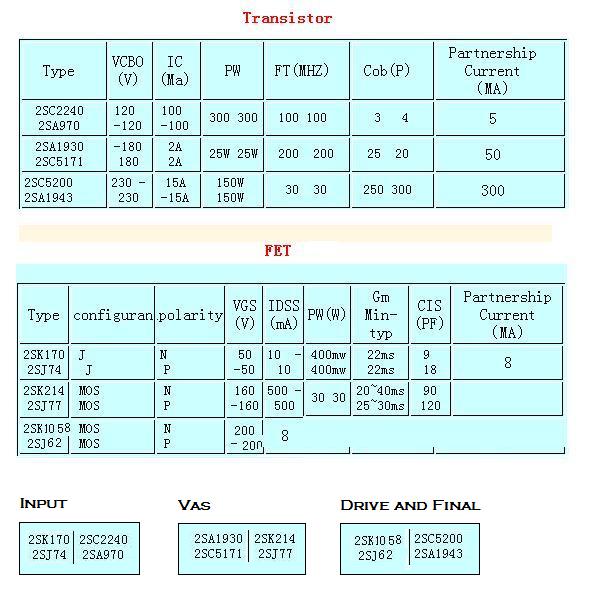

The foundation of the Burson Opamp is a sophisticated Voltage Differential Amplification network. The entire opamp is constructed from audio graded transistors and resistors. Such a design will ensure minimal colouration and maximum dynamics, but this design feature also posed a great challenge to production.
someone knows something more about this design?
http://www.bursonaudio.com/Burson_HDAM_Module.htm
When I look at this and the associated comment, I'd say it's a recipe for disaster...
That is not to say that the design itself might be pretty fine, and without doubt a discrete design has more degrees of design and execution freedom than an IC design... but then again the "specifications" they give for their design is a joke. With *that* amount of info (read: zero) my conlusion would clearly be "stay away from kitchen-table stuff like that", and the rest of the talk on their site does urge me to think so even more.

I don't know if the Burson opamp is a "disaster" as I have never tested it, however I must agree with KSTR that the information level is quite low...
However if you look at this thread: http://www.diyaudio.com/forums/showthread.php?s=&threadid=127371 you find a link to the John Hardy Company
http://www.johnhardyco.com which has a quite higher information level. And as I recall, Mr. Pass has also written an article on discrete opamps. Pick your choice with care 😉
Yes, the long wires shown in the photo that Klaus has linked will degrade and negate the whole effort.
Another DIY member had problems a while back with these (Burson) modules. Seem to remember there was a seperate ground wire, and there was constant noise no matter how it was connected. I don't know what the final outcome was, but agree with comments so far --- Avoid.
