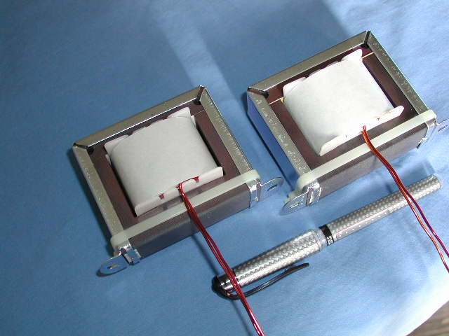

I've got several pairs of inductors left from various I made with good iron cores, they are gapped for 3.5 to 6 amps.
I'm actualy using a pair of these gapped for 3 amps with 16 mH on my Aleph 4 with excellent results.
The general spec for these are:
Iron: Silicon laminations M-15
Inductance: 10 to 14 mH
DCR: 0.05 Ohms
Amps: diferent gap for 3.5 to 6 Amps
Finish: Metal bracked and varnish dipped.
I will post a photo.
Anyone interested please contact me.
