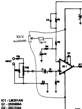

Can you show me how to put a pot at the input of the opamp for dc adjustment?

Connect the 100K pot between the positive and negative supply to the opamp, and connect the center pin of the pot via 160K resistor to the connection between R4 and R5.

I just made this schematic for you regarding DC-adjustment.
Yes! This will adjust the DC-offset on the output.
Let the amplifier warm up for 15 minuttes and then adjust it
(offset better than +/- 0,2 mV is possible).

I saw your advise on the DC offset control. But please note that the DC loop gain is about 3 in the amp, so the offset will be limited to less than the intrinsic LM301 offset, which probably is below 10mV anyway. Surely no need to add offset control (which will drift anyway).

About DC-offset: I have very good experience with this, and in my amp the DC-offset is below 1 mV on the output!!!
10 mV on the opamp x Voltage gain of the rest of the amp gives a lot of DC on the output......

But I differ on the offset. The LM301A (most loose spec'd version) has a typical 2mV, max 7.5mV offset. And the DC loop gain in this amp is 1x (not 3x as I said before, there is 100% DC feedback to inv input, sorry about that goof). So my 10mV is very, very worst case. I say, putting in the offset control is unneccessary and can make matters worse by drift, potmeter failure etc.
I am sure you are aware that the LM301A is a very tired opamp. Not wanting to go to a faster one, because that can upset the rest of the amp, something like a TL084 or an LF411 is perfectly feasible (you probably can't get the 301 anymore); the latter will bring the uncompensated offset close to 1mV anyway.

Sorry regarding the DC-offset. You are right!! I missed the C2 capacitor…. :bawling:
In this case it’s a matter of believes. I like the possibility to adjust the DC-offset, however it is not necessary in this circuit, as you correctly have pointed out.
