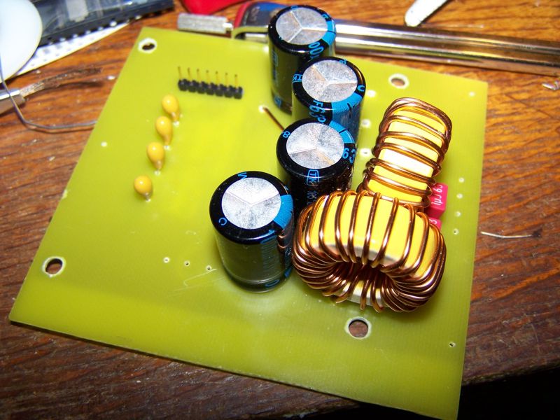

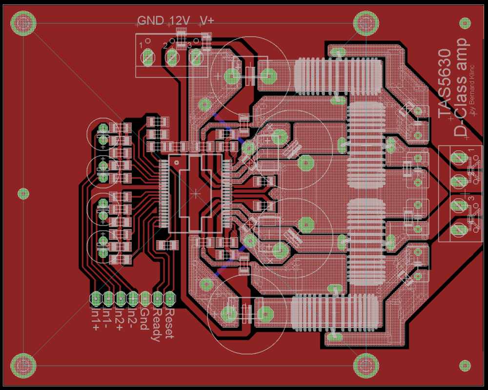

Right now i have a PCB made in eagle for the HSSOP version of the chip( The TQFP version i wanted is not in production yet) and i just recently got the chips them selfs .As you can see i am using the BTL mode of it that has a max of 300W but the high power is mealy to provide headroom and keep the amp cold.
On the PCB the 4 holes you see are not for the purpose of mounting the PCB but they are 775 CPU socket push pin heatsink mountings. I just toght why not simply use a CPU heatsink to cool this. As for the white you see around the board thats the solder mask stop layer so i can cover those in solder to provide a better connection in the high current paths.

Like your PC heatsink idea... Just need to make sure all the
topside stuff is shorter than the thermal interface top of the
chip... Means flush cutting some rather large thruhole parts
too, from the look of it. Sometimes that makes for mechanical
weakness... You might want to build up big fillets the other
side. Agh, but you just said single layer???

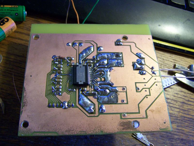

Right now i have to etch this board, i hope it comes out alright despite the printer problems. With luck it should be assembled tomorrow. I hope it will actually work.

Oh misunderstood the shutdown pin its a output to indicate device is not in a error state and it is 0 meaning the device is shut down and dose not react to the reset signal.After some diging in the datasheet i found that the SD pin remains low no mater what when the device is preforming the so called PPSC (Pin to Pin Short Circuit protecion) and is Dependant on the output inductor... hmm the inductance of a open cirucit is something like infinite uH that means i have to wait infinite seconds for the amp to complete the procedure.... i dont think i have that much time.
Anyway this means i have to build the 2nd channel too.... damn where to find those bootstrap caps.
