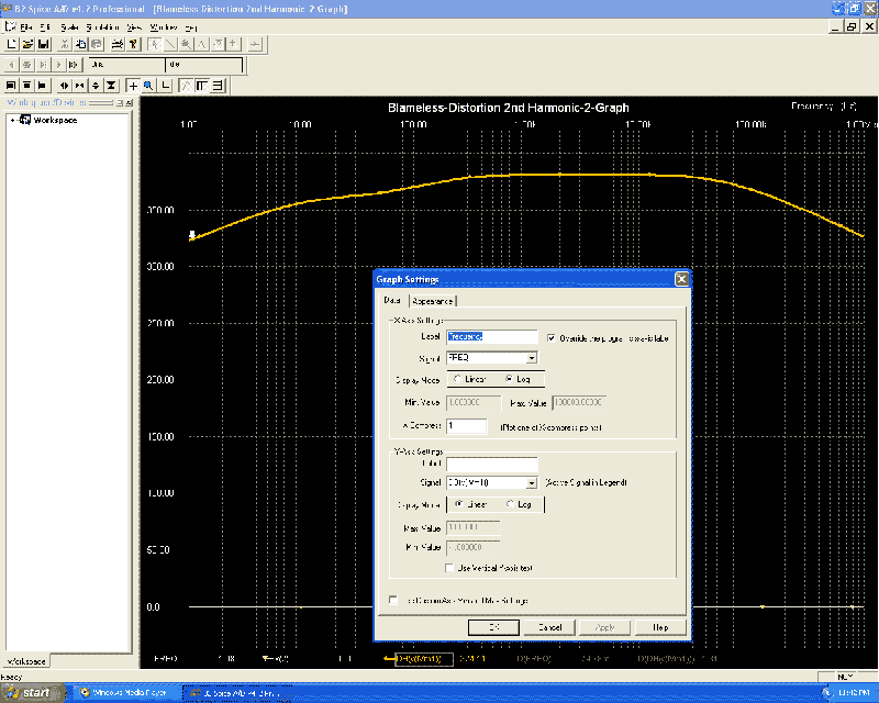

I can't seem to make reasonable distortion graphs.
I'm trying to model circuits in bSPICE and I can't seem to get good cisuals out of the simulations.
Tried doing noise and distortion graphs and alll I get is crap, actually I don't get anything.
After a bit of fooling around I managed to get this graph simulating Self's Blameless amp. The file is attached. O got this by putting a DC source with an AC signal injected into is (1V) at the inputs and put a voltage meter at the speaker outputs.
I still can't make heads or tail or it. I need to have it look like it does in the textbooks. Easier to compare then.
So what does one put into the circuit to simulate these circuits and what parameters or equations are needed to get a good graph that makes sense?
Eternalightwithin
