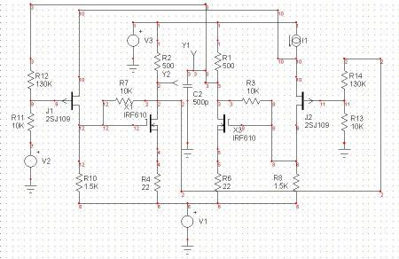

Actually I do have an X preamp in the design phase. Not shown is the Fet follower to buffer the circuit from the volume control. The balanced part need to see equal impedance. i have a nifty servo that uses only 3 transistors and acts on the common mode offset and ignores the audio signal this should operate with lower distortion and 1 less cap than a servo for each balanced output as well as a greatly simplified circuit. This is a work in progress but someone could probably build one from this design with AC coupled outputs. The bais points and feedback are based on a pretty extesive study of Borbely's Jfet and Pass's mosfet preamp designs with several nested feedback loops. The Borpass preamp doesn't sound like a very enticing name and the Nerno preamp is absolutey out of the question!
There is about 10 hours of Spice analysis to get this far. The circuit is counter intuitive concerning output impedance. The preamp has to drive two (or one for nonbalanced amps and that was the problem) single ended loads with respect to ground at the amp input [ INSERT STEVE EDDY TRANSFORMER SPEECH HERE ] and the differential and common mode output impedances are different which was a real dilemma in the early design phase. I have never been forced to fight my gut level instincts conflicting with the Spice results like this one! Made me nuts for two days trying the resolve the difference.
It also lead to a very interesting dialog with Mr. Pass on an op amp circuit that does not work and was posted on the forum. That hasn't stopped the op amp vendors from publishing it in some data sheets and app notes. Seems the original circuit required some coupling caps the op amp guys left out. I think even Mr. Pass was scratching his head on that one.

I am happy to finish 3rd (or have I msised another one too?) I did not show the voulme control buffer. The circuit needs to be driven from equal source impedances on each half for the best performance. Even a 10K pot will imbalance this impedance and as function of the volume setting. The 100K input will load the wiper of the pot and change it's log taper. I have heard some express concerns about signak current through the wiper of the pot as well. Forget about a 100K pot without a buffer.
I have a few questions:
Why not use mosfets in place of the BJTs?
Since your topology uses an inverted cascode and one stage of gain, instead of two as the Xamp uses, how did you get enough open loop gain?
If the preamp is being by a source impedance less than the 100 ohm input resistor, isn't the close loop gain 220K divided by 100 or 2200 assuming an open loop gain much greater than thie closed loop gain?
For a 100k load, isn't the open loop gain about 50K divided by 50
or 500 which is less than the closed loop gain?
How much cable capacitance can it drive without stability or bandwidth limtation issues?
What is the output impedance?
How do you deal with DC offset on the output?
I am not trying to nit pick or engage in armchair engineering without looking closley at the circuit. I am very curious about these parameters which took a lot of thought when I was designing mine.
Thanks,
Fred
