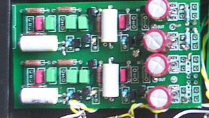

Crossover components:
2n5457 as a buffer, biased at 1.3mA (CCS)
SLA battery supplies
Dale resistors
Wima FKP in the HP sections
Also Wima MKP and ERO 1813 in the LP
Distortion is about -85dB 2nd harmonic SE, which of course disappears entirely when the differential output is used. 3rd harmonic appears to be way down in the -100dB arena. Noise is certainly under the noise floor of my test equipment.

Or one of the boards. Each board is a single differential channel. I didn't want to do any Diff - > SE -> Diff type conversions, nor did I want to use something like a diff. pair here, so I simply duplicated the circuitry. I matched each differential "pair" of circuits to 0.5%. Over the entire range they track within 0.25dB, which is about as far as I trust my measurement setup.

P.S. That dreaded 2kHz hump is gone. I think this is validation that at least a good bit of the hump is due to electrical interactions between the driver and the passive xover. The active version is immune to these problems.
