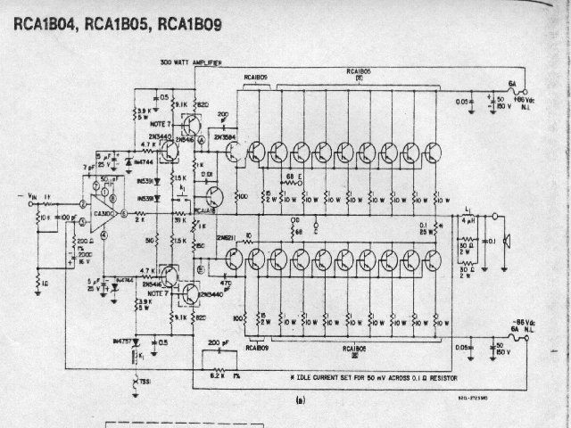

I Built many years ago, based on the RCA application notes for audio an amp using the IC CA3100 at the front end and capable of 350W continuous at 8 ohms. It worked fine and I think it can be modified to 4 ohms use easily or even to more power at 8 ohms and for today´s components use. I think I have the schematics somewhere if you, Killowatt or someone else were interested.

I will scan the schematics to put it in this thread.
Regards

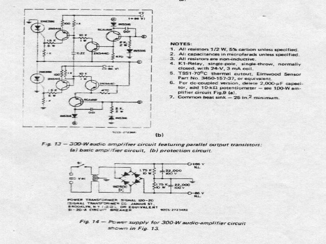

schematic
This is the amp. I reached 360W continuos with less than .1% distortion at 8 ohms. The outputs are bd550b (Vceo=250V, Pt25oC=150W, Ic 7A, hFE between 15 and 75 and fT=5MHz), that you can use for RCA1B05 and 1B09 replacement.
