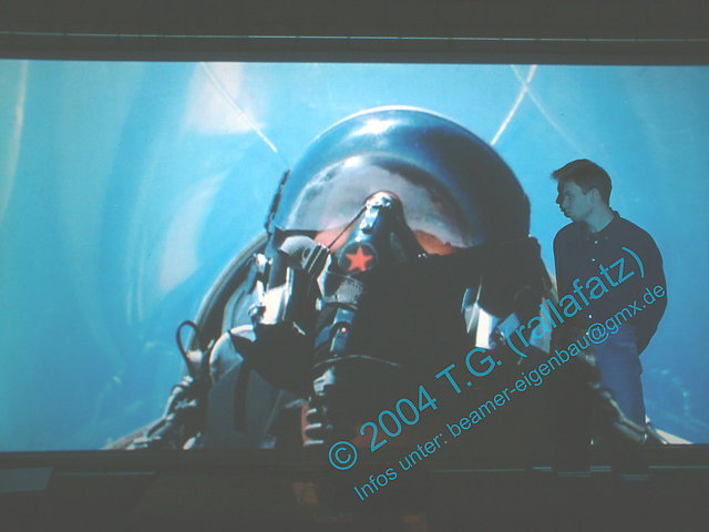

Hello Guys: Here some results of my current setup:
I'm using a Serial 13,8 Inch TFT-Monitor (XGA in Width).
OHP is a Liesegang trainer spezial with 10.000 lumens, 6.000 Kelvin.
I starteds with an Nview Spectra C and continued as follows with a modified TFT monitor on my OHP:
Picture is projected on a 4 x 2 Meter DIY-Screen. For comaparison: I'm 1,89 meters tall. Lower end of screen begins 30 cm above the floor.

Screen material
Hello.
The used material is a cotton fabric with special white coating.
Available as fabric on a roller sized 10 x 2,10 Meters, bright white coated. As far as I know only available in germany from special wholesale trader (specialized on art-equipment).

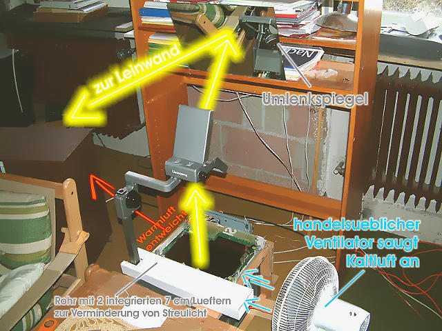

Cruser and Moltenrock, If you don't understand german or other languages...
... you have to be careful with inconsiderate pre-assumptions! Read the following explanation carefully completely and you won't say that again!
Freebie and the whole german users have understood my setup instead of you! But no problem: For you two from the fast-firing unit (first firing, then maybe thinking 'bout the consequences) , I'll show and explain you details. Exclusive for both of you, I will repeat it in simple structured and clear english to help you understand my technical setup (as it is completely and detailed explained in ebay germany (german language, Sorry!)):
I'm using a very bright 10.000 Ansi Lumens OHP (Liesegang trainer spezial, 6.000 Kelvin) It projects the Image against a mirror which itself mirrors the image and reflects it to the screen backward to the OHP.
The reason for this unconventional setup is: My TFT-display has a anti-reflexive coating on the front. The light provided by the OHP doesn't pass the Display effectively if the Display is positioned face-up on the OHP. I made some test runs at the beginning and had a huge spot and a washed out image with faced-up-display. This was the start: Afterwards, I recognized that turning the display round and putting it on the OHP face down, the result was great. No spot! Bright and crystal-clear picture with great colors. But what happens If you put a Display on a OHP this way moltenrock (face down)????? Guess what? Stay a while and think about it on your own!
>>>>Right - The projected picture is projected mirrored on the screen if you project it directly on the screen, which means: the projected picture-information which should usually be placed on the left is shown on the right side and inverse (projected picture is flipped horizontally or mirrored on the screen).
So I had to find a solution to get the picture back in its usual position. Software solutions for flipping the projected picture back in its correct horizontal position were out of reach and I recognized, that a simple and usual mirror will do it! Thats the easy explanation for this unconventional setup!
A mirror flips the mirrored picture back in its usual horizontal position! But as you can see as follows, it works great!
look at my illustrated setup with mirror! If you want I can add much more pictures from different angles.
The photographing-position I took for the ebay auction which you posted, was taken behind -and lower- to the mirror. Photographed in direction to the screen. Instead of freebie You didn't mention, that in all of my ebay auctions there is another photo plus a crystal-clear explanation for all of my setup-details!

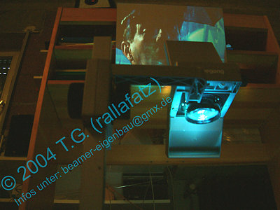

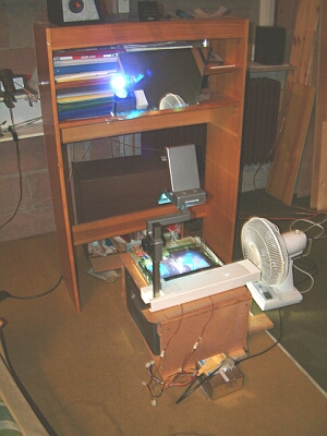

The setup...
...once more...
The OHP with Display on it (face down), the ventilator (cooler fan),
the white barrel with the additional two 7 cm PC-fans inside.
As you can see in my scheme, the way of the light-beam is reflected by two mirrors:
-First of all the mirror of my OHP
-and afterwards: the mirror which reflects the picture to the screen in 4x2 meters.
Higher screen-size would be no problem, but our attic-wall is too small for bigger things. Maybe I should try in summer (open air-cinema, maybe on our neighbours house-wall).
I guess 10 meters without significant loss of light and picture quality must be possible. I'll post It if I've done. Maybe I'm getting a little insane by the size, but aren't we all a little crazy?!

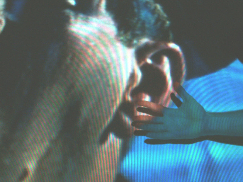

screendoor-effect
This it how it looks from half a meter distance:
Believe Me: When you're viewing films with a distance of about 5 Meters to the screen, you don't see any pixelized-effect or something like that. The TFT has a contrast-ratio of 300:1, resolution native 1024 x 768 Pixels, response time of about 30 ms (absolutely liquid Video-Projection even in very fast scenes taken from Top Gun (which is great, if the Aircraft flying across your attic and the earth is shaking!!!!).
additional information to my resolution: because of a not enlengthable flat-flex-cable, I have little part of the circuit card in the picture. But that doesn't matter in 16:9 mode. I easily drag the Window of my DVD-player to the upper end of the screen and no circuit card in sight. In 4:3-mode I do the same. native resolution of the 4:3-box might be abot 800x600 Picels then. But If you think about the native resolution of 4:3, then its almost always PAL-Resolution (720x540 Pixels or somewhat).
So You see: the resolution in case of 4:3-viewing is still acceptable. I recently saw some Music clips from Axel Rudi Pell and Within Temptation in 4:3 and it was great in spite of reduced resolution in 4:3 mode. And be honest: Who of you is building a DIY-beamer for watching 4:3?! I guess 16:9 is the main employment for your setup, isn't it?
