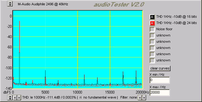

Attached a loop-through result of what I archived with my (not that expensive) audio card. Averaging was 100 times. THD figure at 16 bits is –96db or 0.0015%, at 24 bits –111 dB or 0.0003%. More than sufficient for DIY projects IMHO.
As far as I can figure out, Audiotester takes into account the first 9 harmonics to calculate the THD number, but I am not sure. At 16 bits there are relatively large harmonics above the 9 th harmonic. So the THD number calculated at 16 bits is doubtful. Dunno with other software but the limit is the measurement bandwidth (< ½ Fs).
For THD+Noise it takes anything compared to the fundamental, so this will be more trustful I think.
Anyway the distortion profile obtained at 24 bits is very useful to judge the qualities of DIY efforts.
Cheers 😉

tschrama said:
Hi Pjotr,
Those are excelent results! What soundcard did you use for that loop-through test?
Thijs
Look at the top of the picture 😀
Found that at Fs = 96 kHz distortion is worse (doubles). Also at higher levels than –6dB FS distortion becomes worse. I used a 10-cm loop-through cable. At long cable runs a lot of rubbish can enter the audio cables (i.e. from the mains cord), spoiling the results. Something to take care of.
Cheers 😉
Hi Pjotr,
I that 24bit -111dB number an absolute number or relative to -10dB. That would mean that the 5th harmonic level is -121dB. Your picture shouws the first harmonic somewhere between -110 and -120dB, not -121dB. Well, upon further inspedction, the red line is difficult to see but seems indeed to be in the -121dB ...
Thanks for the soundcard name.. looked it up.. on sale for 149.95$.. that nice indeed for such a high quality THD analyser...😀
Thijs
