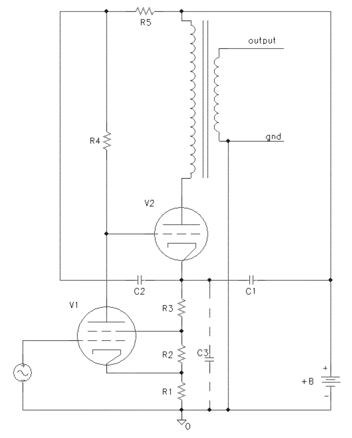

A practical Example - the UX-224 UX-245 UX-280 Stereophonic
Loftin White Amplifier
First Published in the London Live DIY HiFi Circle Newsletter # 42
http://www.earthcurrents.com/london-live/
This Amplifier can be considered as the Granddaddy of all Monkeys
on a Stick, Loftin White/Morrison 2A3 et al. My original schematic comes from an 1930 Electrad Amplifier, however the design by that time was already quite common and can be traced a good few years further back. It’s main attraction was that it dispensed with the need for a coupling device (transformer, capacitor)
between driver- and output-stage, a problem as much then as it is now. I have redrawn and slightly simplified the schematic for clarity, so as to be easily used in this exercise.
As one major war and one generation plus a bit after the original amplifier was designed the stereophonic record was introduced, it was considered sensible to calculate the amplifier as stereo unit. The result should be a set of equations and background information that will allow anyone to calculate their own DC coupled Loftin White Amplifier, using whatever output triodes and driver tetrodes or pentodes are desired to be used (and can be made to work well). As I have recently acquired several pairs of 45’s (including some Globes), as well as some 24’s and one 80 I will use these valves for this example. A wide range of other Valves could be used without any fundamental changes to
the basic procedure. I will not again in detail cover the “why” of pentodes as drivers in SE Amplifiers, for that please refer to my article in the newsletter issue 39.
Before we actually start calculating the Values of the components shown, I’ll briefly explain the function of the circuit. The Output Valve (V2) is loaded by the usual Output Transformer and biased
by a combination of the input valve and the resistor chain in the cathode of V2. The resistor chain is calculated to provide both the screen grid voltage and the cathode (bias) voltage for the input valve. By supplying the screen grid from cathode of V2 the voltage on the screen grid will vary if the operating point of the output valve varies. Thus a form of negative feedback is introduced for the DC operating point of V2, stabilising the circuit against load and +B voltage changes.
The Anode supply for the input valve is taken from overall +B supply, not from the cathode of V2. If the anode voltage for V1 would be supplied from the cathode of V2 the amplifier would be incapable of attaining it’s full output power, as the current
through the input valve anode essentially does not reach 0mA anywhere near the normal operation. Thus the drive to the grid of V2 would fall notably short of reaching 0V grid to cathode voltage, resulting in increased distortion and reduced output power.
The cathode of V1 does not need to be decoupled for AC, the cathode of V2 requires some form of decoupling. By returning the cathode directly to the +B line a shorter current loop is introduced and the value of the decoupling capacitor can be reduced.
This so-called “ultrapath” capacitor is C1 and can be used as sole decoupling capacitor. However, if the optional capacitor C3 is fitted it is possible to materially increase the rejection of power line noise, so in a day and age when a 22uF Ansar polypropylene capacitor is quite inexpensive I doubt that there is any justification for omitting this capacitor.
The final “trick” is presented with C2, which at least for the small signal condition allows the use of severely undersized capacitors for C1 (and C3) by providing positive feedback to the anode of V1.
Thus if the audio signal current through V2 is materially modulating the cathode voltage of V2 due to a insufficient size of C1, this modulation is fed straight through to the anode supply of V1 and from there to the anode of V1 and thus the grid of V2. The result is that grid-cathode voltage is retained despite some voltage modulation on the cathode V2 which would normally reduce the grid-cathode modulation leading to reduced output at low frequencies.
Finally, usually the screen grid circuit features it’s own decoupling capacitor. However, in our circuit here the impedance feeding the screen grid is so low (similar to the cathode circuit) that a decoupling capacitor can be omitted with no ill results. There is nothing (other than the low impedance requiring large value capacitors) to stop you from adding such a capacitor from the screen grid to ground, but it is not neccesary, so I’d say make do without.
All in all this circuit is a very neat and professional solution to the problems presented in such an Amplifier and thus comes highly recommended. At first glance it seems very difficult to calculate such a circuit, compared to RC or transformer coupled circuits, but that is not so.

Let us begin the calculations. My RCA Radiotron Manual Issue 10 (RC-10 from here on) suggests a number of operating points for the 45/245 Valve. Living in a power-hungry age we shall take the highest permissible operating condition, shown as follows:
  • Anode Voltage (really Anode to Cathode): 275 V
    Grid Voltage (really Grid to Cathode: -56 V
    Amplification Factor (Mu) : 3.5
    Anode Current : 36 mA
    Load Resistance : 4600 Ohm
    Output Power : 2000 milliwatt
Also useful to know are the various capacitance’s between the electrodes of the Valve. The major one is the grid-anode capacitance with 8pf, we also need to account for the grid-heater capacitance, which is 5pf.
From the above we can start to calculate the requirements for the +B voltage and driver stage voltages. We need to add the grid voltage to the anode voltage, this will give us the voltage from the grid of V2 to the Anode of V2. This is effectively “stacked on top of the drivers anode voltage, so the full requirement of the +B Voltage for our amplifier is:
Anode Voltage V2 + (-Grid Voltage V2) + Anode Voltage V1
We have the first two terms but the third term eludes us from the specifications. In order to calculate the necessary anode voltage for our driver tetrode or pentode we need to understand how the tetrode/pentode works. As long as the anode voltage is larger than the screen grid voltage the tetrode/pentode behaves as near ideal (and linear) voltage controlled current source. If the anode voltage drops below the screen grid voltage the classic tetrode kink becomes visible for tetrodes; pentodes materially increase their screen grid current draw. Both conditions leading to substantially increased nonlinearity.
Thus the anode voltage or our valve must not swing below the screen grid voltage for full peak signal supplied to the grid of V2. This is commonly equal to the Bias voltage. So the Anode voltage under quiescent conditions must be at least 56V above the screen grid Voltage. In the interest of improved linearity even the region near the screen grid voltage should be avoided, so if we increase the anode voltage to 10V plus the bias voltage of V2 we should be safely outside any nonlinear operation of our voltage amplifying tetrode or pentode for normal operation. With most tetrodes and pentodes the screen grid voltage can be chosen quite freely, however excessively low screen Voltage will reduce the transconductance of our driver valve and prejudice linearity.
The RC-10 suggest as little as 25V screen grid Voltage for the 24, for our example we shall however use a screen grid voltage of 60V. We now have 60V screen grid voltage, 66V screen grid to anode voltage and thus an anode voltage of V1 of around 126V. Looking at the datasheet and the maximum suggested anode current of 4mA at 250V Anode Voltage it seems reasonable to use around 3mA Anode current. Hopefully this is sufficient to drive the output valve V2 without slewrate limiting, we’ll check later in detail, for now I’m happy as I know the slewrate limit current for a driver stage to drive a 45 is around 1mA, safely below our chosen anode current.
We now can calculate our required +B voltage and current:
275V + (- (-56V)) + 126V = 457V
The cathode voltage of V2 BTW becomes:
(- (-56V)) + 126V = 182V
To this 457V +B Voltage we need to add a any output transformer losses caused by the non zero DCR of the output transformer winding. If we assume a 200 ohm DCR primary winding and 36mA we have an extra around 7V drop, so we require around 465V of +B. With a stereo amplifier drawing around 36mA per chanal plus 3mA for the driver stage anode current. Thus the current is 78mA. Looking quickly at the charts for the 280 Rectifier in the RC-10 suggests a choke input supply with a 550V – 0 – 550V mains transformer.
We can take a closer look using Duncan Amplifications Power Supply Designer (PSUD from here on). The 80/280 is electrically compatible with the 5Y3 (but has a different socket), something useful to know if you don’t fancy programming your own rectifier models for PSUD. The circuit was simulated according to the screenshot below. It assumes the use of two Maplin power supply chokes (one in each leg of the supply input) as input chokes, a further Maplin Choke as Filter Choke and a small “tuning capacitor” on the input of the Supply to fine tune the +B level in circuit.

So, we have our +B resolved, know the screen voltage for V1 60V), the anode voltage for V1 (126V) and the cathode voltage for V2 (182V). We also know all currents apart from the screen grid current. The RC-10 suggests < 1/3 of the Anode current, so it will not be more than 1mA, looking closely at the curves in the RC-10 it seems it will usually be even less that this, at our static operating point I would estimate < 0.5mA screen grid current.
Ideally we would know exactly also the grid bias voltage for V1, but the charts in the RC-10 only show 90V screen grid voltage. Comparing a few similar tetrodes would suggest a bias voltage for the control grid of around 1V to 1.5V for 60V screen grid voltage. If we base our calculations on 1.5V bias voltage for V1 we can place a modest value adjustable resistor in parallel with R1 and adjust it to make all operating points “fit”.
So now we have:
VC(V1) : 1.5 V
VG2(V1) : 61.5 V
VA(V1) : 127.5 V
VC(V2) : 183.5 V
IA(V1) : 3 mA
IG2(V1) : 0.5 mA
IC(V2) : 36 mA
With the above we can calculate our resistor chain as follows:
R1 = VC(V1) / (IA(V1) + IC(V2))
R2 = (VG2(V1) - VC(V1)) / (IC(V2) - IG2(V1))
R3 = (VC(V2) - VG2(V1)) / (IC(V2))
Filling in our values we get:
R1 = 1.5V / (36mA + 3mA) = 38.46 Ohm
We use 43 Ohm as the nearest standard value and then one number up and parallel a 1k 10 turn adjustable resistor in parallel to fine adjust the operating point.
R2 = (61.5V – 1.5V) / (36mA – 0.5mA) = 1690Ohm
We use 1k5 as nearest standard value available with a substantial power rating (we should use at least 5W audio grade types) and an 180 Ohm 2W resistor in series, making our value 1680 Ohm – I’d say close enough for government work and Pentium users.
R3 = (183.5V – 61.5V) / 36 mA = 3389 Ohm We use 3k3 as nearest standard value available with a substantial power rating (we should use at least 10W audio grade types) and a 91 Ohm 2W resistor in series, making our value 3391 Ohm again close enough.
Now to calculate the minimum value for our anode load resistor. From the Datasheet we know that the transconductance is around 1000 micromhos, a particularly unintuitive measure – I prefer the European notation that calls this 1 milliSiemens, or 1mA/V denoting that a 1V change on the grid gives a 1mA change in current. As we expect our bias to be near 1V we may assume that our maximum grid swing should be less than this. With a 1V peak grid swing we obtain a peak current swing of around 1mA. This should give at least 56V change in grid voltage for our V2, requiring a 56 kOhm anode load resistor for V1. To be on the safe side of that equation I think giving us around 50% leeway is a good idea, so our anode load resistor R4 shall be selected as 75kOhm. The dissipated power is below 1W, so selecting a 2W type here is fine.
The effective anode impedance of V2 is around 400k Ohm, so R4 dominates the output impedance of the driver stage, if we want to be precise it will be around 75k in parallel with 400k or 63kOhm.
With 3mA anode current a voltage of 225V is dropped along this resistor. This adds to our 127.5V anode voltage of V1 to give a voltage of 352.5V on the top end of R4. With our +B at 464V nominal R5 needs to drop the difference between these two voltages with 3mA current, so:
R5 = (464V - 352.5V) / 3mA = 37166 kOhm
I think here we are safe selecting a 33k 2W resistor in series with a 4K3 0.5W Resistor.
With the above we have established all resistors and the DC operating conditions of our Amplifier. We have:
R1 = 43 Ohm in parallel with a 1k 10-Turn trimpot (power uncritical)
R2 = 1k5 Ohm 5W in series with 180 Ohm 2W
R3 = 3k3 Ohm 5W in series with 91 Ohm 2W
R4 = 75k Ohm 2W
R5 = 33k Ohm 2W in series with 4k3 Ohm 0.5W

Our last task is to calculate the capacitors C1 to C3.
I think for starters we should set the lower cutoff of the amplifier ahead of the output transformer to 5Hz. This should ensure that the output transformer forms the dominant pole.
For fun, I’ll start to work out C1. C1 is with a current loop that includes the reflected speaker load via the transformer (nominal 4600Ohm) and the anode impedance of V2 (1670 Ohm per RC-10). Together with these impedance C1 should give a –3db point of 5Hz.
This suggests:
C = 1 / ( 2 * PI * f * Z)
Where f is the –3db point and Z is the sum off other impedance’s in the loop at this frequency. Now the impedance is dicey, as the inductance of our output transformer feeds into this, but we cannot really do much here, so using the nominal impedance’s will have to do, it will result in a sufficient value C1.
Thus:
C1 = 1 / (2 * 3.14159 * 5 * (4600+1670)) = 5uF
As a 5uF is not readily available we choose a 4.7uF or 5.6uF Capacitor here. Just to get to the value of C3, this is approximately C1 * Mu, the exact value will have to be selected by trial & error for minimal PSU induced noise. Ideally inject a 300Hz signal into the PSU rail and tune C3 for minimal 300Hz output.
However, based upon our quick and dirty formula we get:
C3 = C1 * Mu
C3 = 4.7uF * 3.5 = 16.45uF
I’d say start with a 15uF unit in place and then tune the value with additional parallel capacitors for minimum noise.
Our last issue is the value of C2. C2 effectively “bootstraps” the anode supply of V1 with the AC voltage on the cathode of V2. So it is effectively a coupling capacitor into this node. The impedance’s present there are the anode impedance of V1 plus the anode load of V1 in parallel with R5. Given the very high value of the first two terms (475k or higher) we find that R5 dominates, so if we calculate for the resistance of R5 and take the next value up we should be fine.
In order to effectively bootstrap the Anode the –3db point here should be 1 Octave lower than for all other calculations; thus follows:
C2 = 1 / (2 * 3.14159 * 2.5 * 37300) = 1.7uF
If we use a 2.2uF Capacitor for C2 we will have no problems.
We now have all components for our Stereo Amplifier using a 24/224 driver and a 45/245 output valve, with an 80/280 rectifier for both channels. I guess a round of shopping is on order.

Calculating DC coupled Single Ended Valve Amplifiers - Triode Drivers
Konnichiwa,
Let's continue our mini series. First we looked at calculating a classic, Pentode Driver and Triode output Loftin White Circuit, basically the original. This time around we will have a look at calculating a Circuit with a Triode Driver. This whole post is condensed from a discussion on the Audio Asylum.
http://db.audioasylum.com/cgi/m.mpl?forum=tubediy&n=35780
The set Valve lineup was 45 Output V2 (as in our previous example) and a 417A/5842 as driver V1.... The generic schematic from the previous article is attached again, this time adjusted to suit a triode as driver, which means R2 is omited.
First, Gordon Rankin shared previously his preferred operating point for the 5842:
http://db.audioasylum.com/cgi/m.pl?forum=set&n=6774
And I usually listen to what Gordon says. His 10k/-2V/10mA operating condition fits in nicely with my own prejudices on sonics as well. So I would recommend starting from that. My WE 417A Datasheet says the Anode Voltage is 130V under those conditions, anode impedance will be around 3k5.
The 45 in the V2 position will want -56V/275V/36mA as operating point. This means the +B must be 2V (V1 Bias) + 130V (V1 Anode Voltage) + 56V (V2 Bias) + 275V (V2 Anode Voltage) + 5V (estimated OPT DCR Voltage Drop) = 468V.
The +B Current Draw will be 10mA +36mA = 46mA.
Plug this into all into PSUD (46mA constant current for a monoblock or 92mA for a Stereo Amplifier) and fiddle around with the Input Capacitor (making it as small as possible) untill the voltage falls into place.
With a 5R4-GY rectifier and a 550V-0-550V secondary winding and 1uF/10H/20u/10H/20u as filter you get according to PSUD 469V with around 30mV +B ripple. With an 80 you need a large value first capacitor.
The 30mV ripple will be attenuated to around 1mV on the 8 Ohm Speaker output even without the added cathode to ground Cap and to << 0.1mV if C3 is added. If you use AC heaters for the 45 the main noise source will in generally be the heaters anyway.
Back to V2. It's actual anode voltage will be 132V and the supply to the anode resistor R4 will be 2V +130V + (10mA * 10k) = 232V. With a +B of 468V we need to drop 468V-232V = 236V across R5 which requires 236V / 10mA = 23K6 Ohm, I would say a pair of 47k Resistors in parallel.
The power dissipated in the 10K Anode Resistor R4 will be 100V * 10mA = 1000mW or 1W, use at least a 2W Resistor, 5W is recommended. The dissipation in the 23k5 +B dropper R5 for the 417A will be 236V * 10mA = 2360mW or 2.36W distributed over two resistors, so again 2W minimum, 5W are recommended.
Now to the biasing of the V1. Here we can use again our neat little trick illustrated earlier to get rid of the Cathode Cap. We return the bottom of the V2 cathode resistor R3 to the V1 Cathode instead of ground. We now have 46mA current in the Cathode Resistor R1 for V1 and we need 2V Bias. So R1 = 2V / 46mA = 0k043 or 43 Ohm.
I would suggest using initially a Pot there (100R) and first to adjust the correct DC balance of the Amplifier. Later we replace R1 with a fixed resistor of suitable value if desired.
With around 50 Ohm unbypassed Cathode resistor and at the chosen operating point our effective anode impedance for V2 becomes Ra' = Ra + Rk * u = 3k5 + 43 * 40 = 5k22 so the increase in effective anode impedance from 3K5 to 5K22 is modest and definitly worth ditching the cathode bypass cap.
Our gain BTW will be u / ((Ra' + R4)/R4) or 43 / ((5.22 + 10)/10) = 43 / 1.522 = 28.25. If we multiply our Bias (2V) with the gain (28.25) we get 56.5V on the anode, so our bias is just sufficient to make sure that our output Valve delivers full power. However, given that we have a small amount of cathode feedback we can in practice drive the V1 Grid with more than 2V Peak without causing grid current, so we have some overload margin available.
Okay, the V1 is sorted, on to V2.
This is easy now. The grid will be at 132V and the cathode 56V above the grid, at 132V + 56V = 188V. As the bottom of the cathode resistor R3 of this Valve will be at 2V we will have to have a resistor for R3 that causes 36mA currentflow with 186V across it, 186V / 36mA = 5k1666, so 5K1 should work fine as nearest preferred value. The power dissipated will be 186V * 36mA = 6696mW or about 7W, so a minimum of 14W rating is suggested, probably best to go for something really meaty here like 20W Caddocks in TO220 casing with a heatsink or high power Mills wirewounds etc....
Alternatively paralleling a pair of 15k/5W resistors and a pair of 33k/2W resistors will give 5k16 resistance and just about sufficient power handling, without using very expensive power wirewound (the "white coffin" ones are best avoided - positively diabolic things).
Calculating C1, C2 and C3 is identical to the pentode case earlier.
C1 & C3 can stay the same (C1 = 4.7uF, C3 = 16.45uF), only C2 changes. To quote:
"Our last issue is the value of C2. C2 effectively “bootstraps” the anode supply of V1 with the AC voltage on the cathode of V2. So it is effectively a coupling capacitor into this node. The impedance’s present there are the anode impedance of V1 plus the anode load of V1 in parallel with R5."
This time the Valve itself represents around 15K resistance and R5 will be 23k5. In parallel this gives (Ra'+R4)*R5/((Ra'+R4+R5) = (5k22+10k)*23k5 / (5k22+10k + 23k5) = 9k24
"In order to effectively bootstrap the Anode the –3db point here should be 1 Octave lower than for all other calculations; thus follows:
C2 = 1 / (2 * 3.14159 * 2.5 * 9240) = 6.89uF
If we use a 6.8uF Capacitor or larger for C2 we will have no problems.
There you go, simple, basic DC coupled 45 Amp, a handfull of resistors, two valves, three Cap's, ideally all non electrolytic and the best quality you can afford for C1, C2 & C3 can be decent polypropylene film or the like. It should be possible to get away in the PSU with a (C)-LCLC filter combo using cheap 20uF/275V AC polyproylene motor capacitors (two in the second stage) and 10H/0.1A Chokes for a stereo Amplifier, meaning you can build a completely electrolytic capacitor free amplifier, with absolutely minimal numbers of signal path capacitors.
Sayonara
hi kyw,
for my WE404A driver, i chose a screen voltage of 100V, 50V screen grid to anode voltage (45V + 5V allowance) resulting to a plate voltage of 150V. based on the datasheet, it says 14mA at 150V plate voltage is typical.
i also used 1.5V bias for V1.
following your formulas, i now have:
B+ 445 Volts
Vk (V2) 195 Volts
R1 20.27 Ohms
R2 1,769.91 Ohms
R3 1,558.33 Ohms
now i'm totally lost with R4 computation. with a transconductance of 13,500 micromhos at the above operating point. we know, i need 45V to drive my 2A3. so how do i calculate my R4?
cheers!
Konnichiwa,
arnoldc said:
B+ 445 Volts
Vk (V2) 195 Volts
R1 20.27 Ohms
R2 1,769.91 Ohms
R3 1,558.33 Ohms
Well, 13,500mcromhos = 13.5millisiemens of 13.5mA/V.
With 1.5V Bias that gives a maximal current swing of 13.5mA * 1.5 or 20.25mA (theoretically). So, with 20.25mA and at least 50V swing you need at least 50V/20.25mA=2469 Ohm. Yet our Anode resistor needs to drop at least 50V and a little for reserve, so first 75V (50V + 50% reserve) divided by 14mA gives 5,357 Ohm, say we use 5k6 then the top of R4 will be at 5k6*14mA + 150V = 228V.
Now we can check the theoretical maximum Voltage swing, 5k6 * 20.25mA will give (theoretically) 113.4V swing, I'd say more than good enough.
So, I'd start with R4 = 5k6, which BTW will give a gain of around 75, probably a little less as our cathode impedance is not zero.
Does this help?
Sayonara
oh by the way, according to microsoft excel my values should be:
Results
B+ 445 Volts
V2 Vk 195 Volts
R1 20.27 Ohms
R2 1,769.91 Ohms
R3 1,558.33 Ohms
R4 5,600.00 Ohms
R5 26185.71429 Ohms
C1 4.772266193 uF
C2 1.706756864 uF
C3 16.70293167 uF
for the WE404A driven 2A3. nice small values for film caps 😉
Konnichiwa,
Results
B+ 445 Volts
V2 Vk 195 Volts
R1 20.27 Ohms
R2 1,769.91 Ohms
R3 1,558.33 Ohms
R4 5,600.00 Ohms
R5 26185.71429 Ohms
C1 4.772266193 uF
C2 1.706756864 uF
C3 16.70293167 uF
Hmmm, R5 looks too large in value. Looks to me more like it should be around 15k....
Well, please note that the Capacitors are MINIMUM values. No harm making them larger as long as you keep the cpacitor quality at the same level. Most critical is C1.
BTW, translated to NPV (nearest preferred value) your resistors are:
R1 33R in parallel with a 100R adjustable resistor in series with 27R - you use this to adjust Vk of V2 to nominal.
R2 1K8
R3 1K5
R4 5K6
R5 15K
In terms of power rating R2, R3 should be 12VA each, R4 2VA minimum (this the the sonically most critical resistor BTW) R5 5VA minimum dissipation.
For the capacitors the NPV's:
C1 4.7uF
C2 2.2uF
C3 15uF + 1.5uF plus "tuning" capacitors if you wish to tune the PSRR for lowest noise.
I would try to make C1 a good quality PIO or Film/Foil polypropylene type. If you make C1 large in value keep the ratio between C1 & C3.
Sayonara

Re: Calculating DC coupled Single Ended Valve Amplifiers - Triode Drivers
hi T
in the first paragraph, the equation Ra' = Ra + Rk * u, used a u of 40.
and in the second pagaraph, the equation u / ((Ra' + R4)/R4), used a u of 43.
i'm confused as to where the variable u gets calculated.
