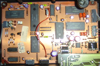

Here is what I did
Thanks to Guido for the CDX manual
I studied the schematics and decided to try a few tweaks. I didn't want to :
1) Risk this ancient machine not working at all
2) Change the sound too much i.e destroy what I liked
3) Buy any new parts - so I raided my parts bin
Basically I :

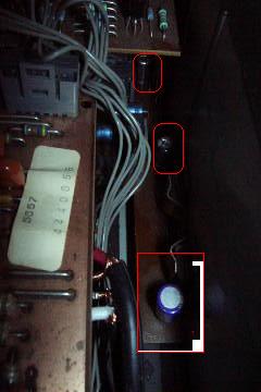

1) Replaced the DC blocking caps on the decode board (underneath ) with wire links (caps 2573 & 2608). I use a Quad 44 which has DC blocking so these were unneccesary
2) Replaced the opamp decoupling caps with cerafines 25v/100uF (2624 & 2627) - seen in the picture
3) replaced the PSU board caps 2451 - 2456 with Elna RSH (16v /100uF) with the excpetion of 2455 which I used a 16v /100uF OSCON
still a bit hard at the top end but I think that it has greater imagery and depth.

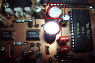

Now swapped all the remaining caps from the decoder board for oscons. They were all 22uF/35v ( B&O CDX says there 40v) However none see a voltage greater than -18v. There is alsu one 1uF/35v cap too. I swapped in 22uF/20v oscons which fit well and a 1uF/20v. sorry for the poor picture but the oscons are the violet/blue caps
Sound is sweeter I'd say
Remaining tweak might be to add some ferrites to the 3 green inductors you can see in the picture. Need to device a means where they don't short with the groundplane.
