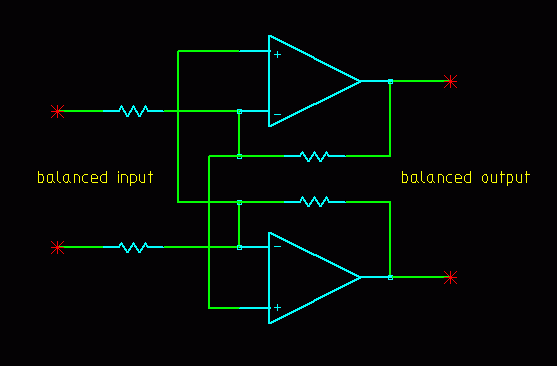

Any results yet? I know what an instrumentation amplifier is but what is i/a feedback? and super symmetry?
GP.
Actually, is this a super-symmetry cct as done with opamps?
GP.
