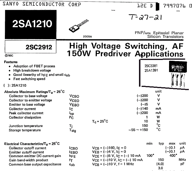

nice layout! what if ....
Brian:
Your layout really looks good! What's the possibility of adding patterns to use the 2SA1349/2SC3381 monolithic duals in their special wierd package for the dual diff stages in addition to the usual TO-92 package devices currently being used and adding patterns for different voltage gain driver devices (say, the 2SA1210/2SC2912 in the TO-126 package) in addition to the TO-5 package devices currently used? Just to be clear, I'm saying adding patterns (pads, holes, routes, etc.) IN ADDITION to the original Leach selected parts. That way, one could build the original design and experiment/update with more modern parts without tearing up the PCBs.
By the way, I think I'll be looking for six boards 🙂
mlloyd1
Re: nice layout! what if ....
ooops! forgot to add the device pics!
mlloyd1 said:
Brian:
Your layout really looks good! What's the possibility of adding patterns to use the 2SA1349/2SC3381 ....and adding patterns for .... the 2SA1210/2SC2912 in the TO-126 package....
mlloyd1
Sorry, I cannot add extra pads for these devices, but the existing pads are spaced far enough apart for use of these devices, and the holes are big enough for the leads of your devices.
