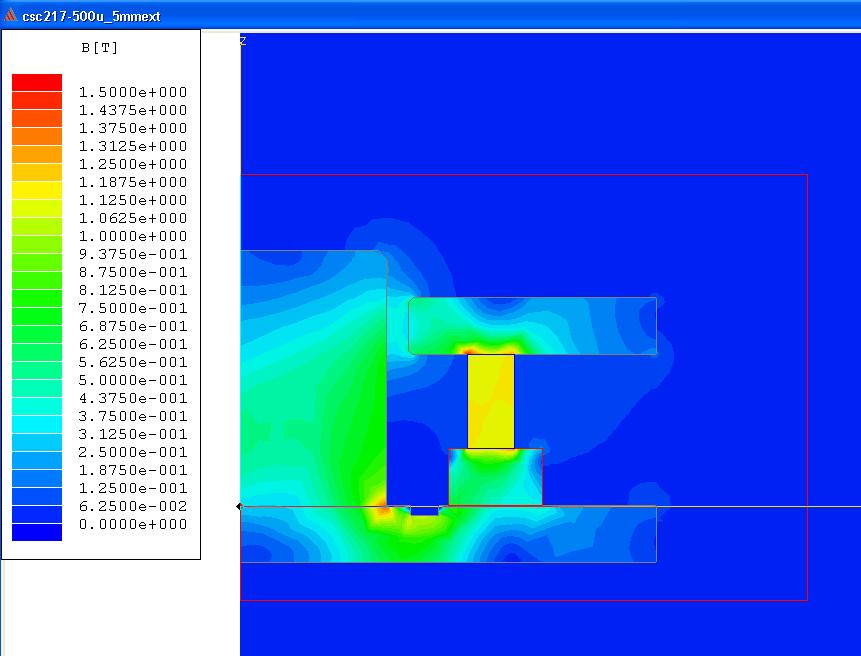

simulation of B-field
I took the driver apart, measured the geometry of the parts and calculated the field with Maxwell 9 SV. I assumed 1008 steel and a Ceramic 5 magnet (Ceramic 8 does not make a huge difference).
Here's a 2D-rotational symmetric plot of B. The rotational axis is the non-existent pole piece vent.

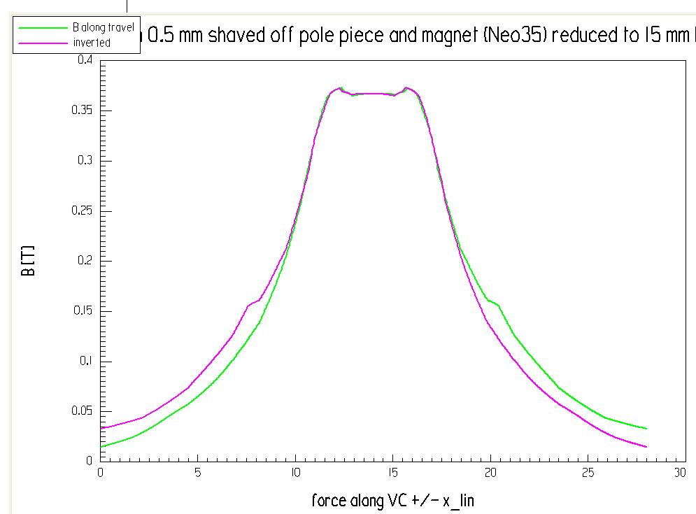

field along VC +/- possible excursion
The green graph is the B-field along the center of the gap (i.e. r=16.875 mm) and from -14 mm to + 14 mm above the center of the top plate.
Hence, 14 mm = vertical center of gap and center of voice coil,
5.5 and 22.5 mm = first and last winding of VC when in rest position,
0 and 28 mm = first and last winding of VC when displaced by +/- x_lin
The purple graph is the B-field along the same line, but with top and bottom reversed. This is essentially a symmetry check. As you can see, the symmetry is not too good. The stray field below the gap is stronger than the stray field above the gap.
It is interesting to see that you can get a flat B curve only along the inner 3.9 mm of the 6 mm gap. At the top and bottom end of the gap, the field is already down to 0.8 T = - 15% of the plateau.

possible mods
First of all, I shaved 0.5 mm off the radius of the pole piece to make room for a copper cylinder. The caused the plateau to drop from 0.93 T to 0.81 T. At the same time, the flat region became wider, 5 mm compared to 3.9 mm before. Essentially, I took the top off the B curve, the sides didn't get much better.
Next I simulated what would happen if I reduced the magnet height from 20 to 15 mm. I happen to have a stash of 5 mm dia, 10 mm long Neo 42 magnets. On the quick, I took Neo35 in the simulation (the difference is like 10-15%) and 5 mm 1010 steel washer used as a spacer.
First thing to notice is that the field in the gap dropped from 0.8 to 0.4 T, even with a solid ring of 5 mm of Nd! The length of the Nd magnet does not contribute too much, but the area does. If I were to buy new Nd magnets, I'd probably go for 5 mm length and greater diameter and use two 5 mm steel spacers.
Anyway, the field now looks much more symmetrical!
curve symmetry
As you can see, the top 50% of the B curve look a lot better now. The outer stray field can probably be symmetrized by carving out the pole piece, similar to the construction of the Usher 9950 tweeter (cross-section at Northcreek) or the XLS subwoofers (there is also a cross sectional view some place on the d-s-t site).
Getting the field back up to slightly below 1 T will take an awful number of Nd magnets. I should consider reusing the original 20 mm magnets and simply glue a 5 mm steel plate onto the top of the pole piece to obtain the extented pole piece.
Does anybody know how much magnetization a ceramic magnet looses when the return circuit is opened and closed again (assuming it was orginally charged with the circuit in place)?
