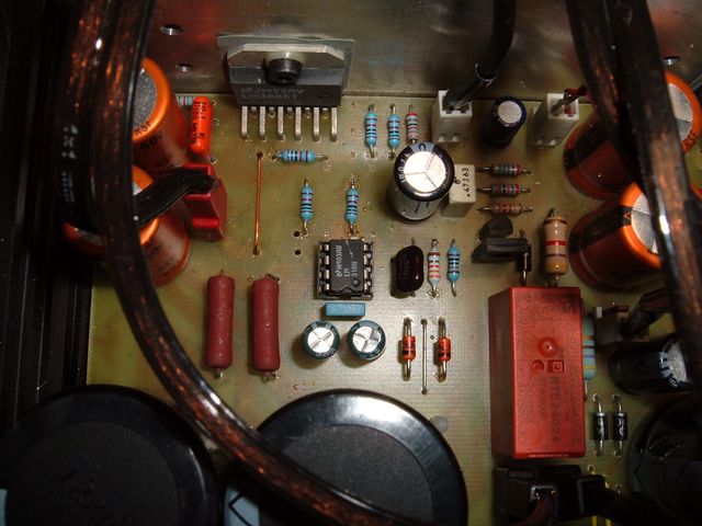

The LM3886 it's the power "bilateral current source" (National Semi app...), but the Low value of R3 end R20 (0,01 ohm or 20mm jump 05mm wire) create an "modest" Output Impedence of the bridge.
The LM318 controlling all over close loop.
This architecture it's very complex for tuning, but I the have chosen on account of the fantastic integration with the loudspeakers, end the modest "load invariant" propriety.
The close loop stability It's controlled on dominant pole (C33 end C34) end C31 C32 (0-3p3) not used for this configurations.
In the schematic 2 view a simple Power ON speaker delay (2sec) plus -+ DC protections, and power supply. The transformer It's 225 VA 240/25+25Vac, and Diode (Bridge D1, D5) 5A 250V C5000/3300
to attach the preliminary test of my (1 years old) prototype.

The LM318 choice it's extremely determinant (for my). I have tested various OP-amp (NE5534, OP27, TL081, TL071 ecc...), but the audio performance (compareted a class A amplifier) are superior.
An other motivation is that the slew-rate of this OPAMP is suited to this application (or all final amplifier device )
I am not able to explain shortly the theme of the topology ( in English ).
eventually if find the time, I will do a little relationship and will translate you.
In brief, say that this type of amplifiers "feelses" the load that in minimum departs comes to be part of the feedback network, on account of the presence of the bridge in exit (or an other high impedance current driver).
No tuning problem (for you, and this schematic).
The recommendation it's a good bypass and short length of
a input network on LM3886 . I have built all the circuit a 100*160mm card, (as in the photo), and abundant stagnated all power copper track.
If have a oscillations problem, increase C33,C34 on 110 or 120 pF.
If to is not enough, added C31,c32 sperimentaly, (1- 3,3 pF).
ciao
