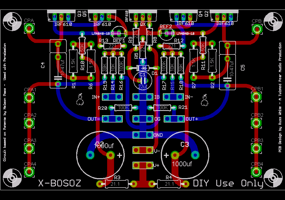

It seems there are a lot of people, besides me of course, who have been wanting a good quality PCB for XBOSOZ. Well I have been pointed to several thread and tried to glean as much as I could. This is a completely no area for me, and my first pass at a Pass design. 🙂

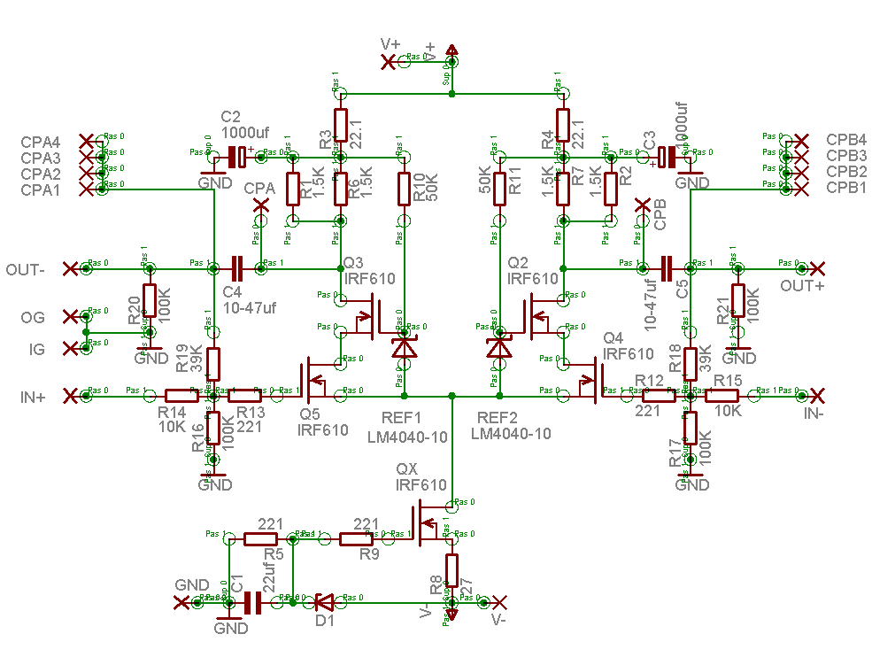

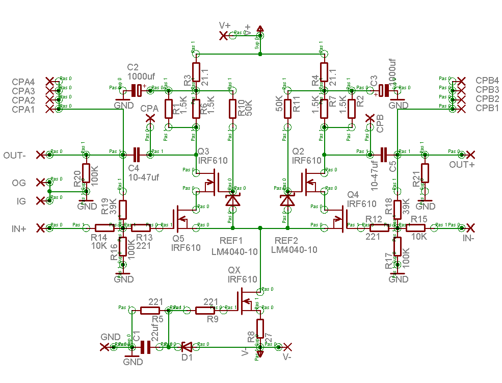

First the Schematic:

The PCB is pretty compact at 4.2" x 2.7" and is designed for a common HS.
It allows for either a radial output cap or axials up to 2.1" long or so.

CPA/B and CPA1-4/CPB1-4 are for the AXIAL C4/C5 caps, which if you used axials you would omit the radial C4/C5
I printed the layout on papaer and check a 33uf cap which is about 1-1/4" diameter. It fits fine, but it will extend off the sides just a bit. But no need for PCB over on the sides that does nothing. 🙂

Since I am making suggestions, how about you modify the schematic and put in the vol control? The only reason is that you would then be the only one to have a full X-CCS-BOSOZ schematic with vol control, apparently since its so "obvious" no one includes it in their schematics.
Plus if you are making boards people will wonder where to hook up the vol so even if you just have some holes with a label it would be a little easier for beginners. Also its kind of odd to have a preamp circ lacking volume.....but of course its up to you.

I'm not sure what the tolerances of the PCB manufacturer are, but I noticed that the upper pad of R5 is awfully close to the trace above it.

ble0t said:I noticed that the upper pad of R5 is awfully close to the trace above it.
Thank you,
How is this?
Nice work as always Russ 🙂 But why the layer change for the traces from C4/C5 to CPxx ?
EDIT: Same question for the trace from C1 through R9 to R5?

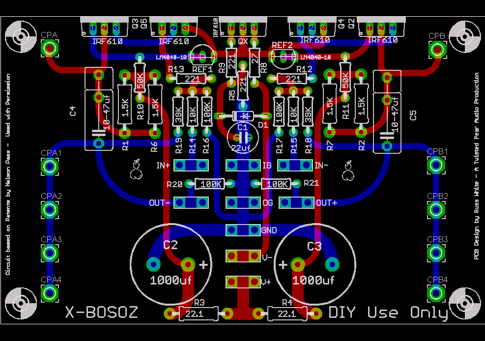

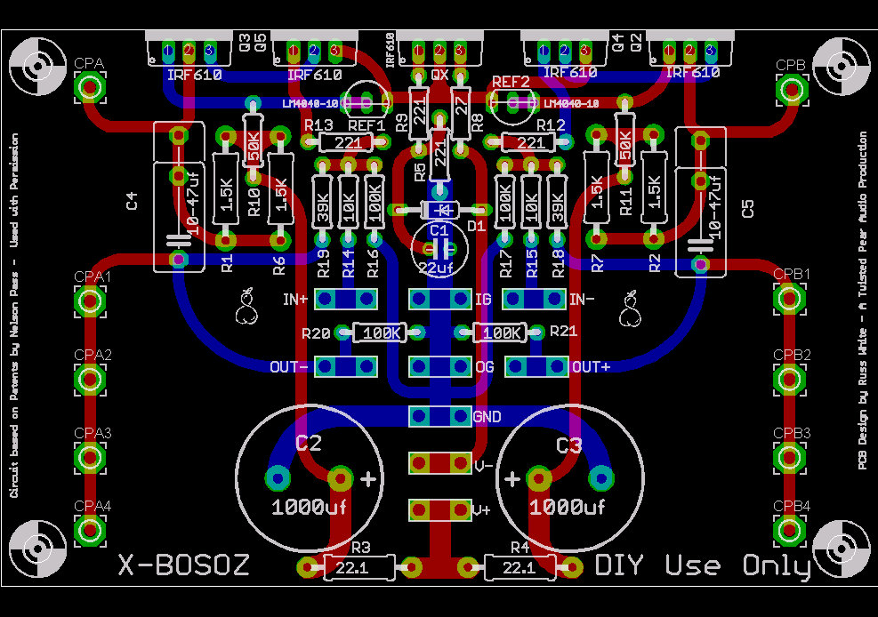

Thanks for pointing that out to me, i missed the first thing simply becaue I have been looking at it too long I think. 🙂 It is now fixed. Picture will be in next post.

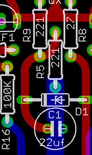

The second is not exactly correct, but its hard to see, so I have attatched a zoomed image.
BrianDonegan said:Looks like there is trace-doubling between the pins of the references as well (top and bottom).
That was actually intentional. I built a version of that part in the library with those two pins coupled because the datasheet says so. And I wanted to be sure it was the same on both sides since I knew it would have traces running to/from it on either side. But I could easily remove one trace. Not sure it matters..
