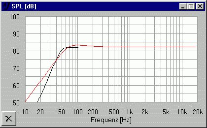

Measured frequency response of FR125S in sealed 9 litres enclosure stuffed moderatly and filterless:
As you can see, it's faily erratic above 1kHz (+/- 6db up to 20k) so I was curious what filters some of you have been using, and any measurements (with or without filters) would also be helpful.

If... I had the FR125 (or WR) I would try the closed box with highpass capacitor. This allows a small box and good low frequency performance, including protection against too low frequencies.
I simulated the 9 liter closed box in AJ Horn (Demo) which is quite close to the measurements presented (red line). Then the simulation in a 6 liter closed box with a 400 uF in series with the speaker (black line).
Good and close enough is say a 330 uF bipolar rough, a 68 uF Bipolar Smooth and a 10 uF MKP.

I think your curves don't look right for a sealed solution. The black line in your graph approximates what I simulate in WinISD for the FR in a .5 cubic foot ported enclosure tuned to around 50 hz. Also, the sealed solutions all seem to start rolling off just above 100 hz and usually have an F3 around 90 hz . . . Try downloading WinISD and using that - most people seem to like it for basic simulations and it is a free download.

Hi ABS
Yes the normal closed boxes with WR/FR125 end up around 90 Hz . Ans Yes I do have and use WinISD for reflex and closed enclosures.
But the 3rd order alignment with a series capacitor, can not be simulated with WinISD. The Demo version of AJ Horn is the only package I know that does this.
The 3rd order alignment works fine with chassis that have a rather high Qms and Qts with a low fr. Then a smaller enclosure than the standard Q=0.7 closed box gives a lower cut off frequency. Also the power handling is increased as there is a limiting for the subsonic input to the chassis through the capacitor. The impedance plot gives the explanation for the behavior. The sonics of this 3rd order alignment is also between the vented and the closed box. And for highish Q chassis often better than vented.
