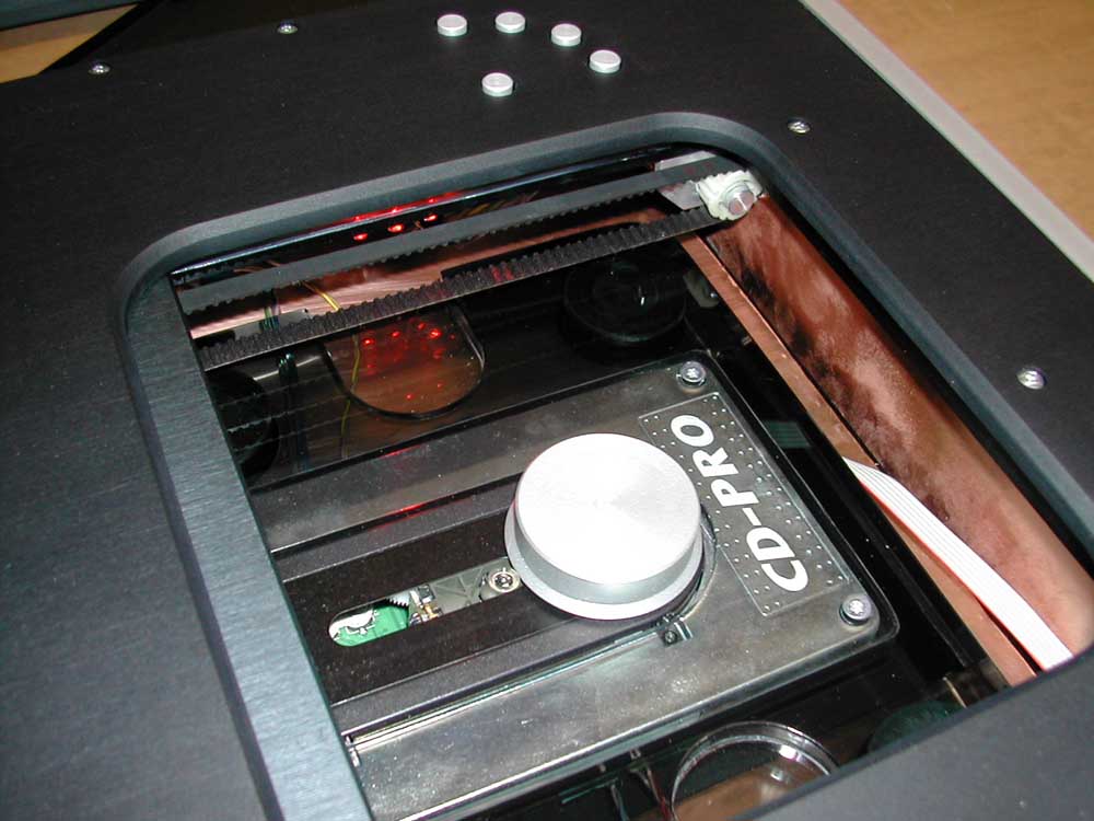

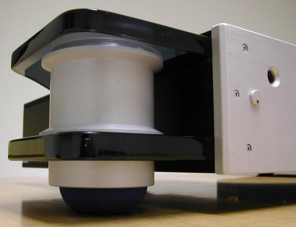

I bought only the three big feet and the cd clamper from a skilled turner!
Everything else is Hand Made with common tools and a jig router with fine regulation.
I adopted different solutions to fight the mechanical vibrations: the CD-PRO2M module is fixed to a thick machined dark plexiglass support, which is fluctuating through four couples of opposed little magnets; the case is made of two wonderful dark pieces of dampen acrylic and 8mm anodized aluminum; everything lean on three large aluminum feet filled of a sandwich of damping materials (sand, cork, soft rubber, closed cell rubber and a soft ball).
Ah, also the aluminum finishing is made by a craftsman... I didn't want to deal with dangerous sulfuric acid tanks!!

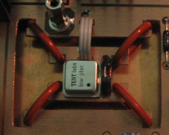

Here is the pulsating heart of the Player, a very good TentLabs XO
Guido, look what a special treatment I reserve to your precious module!

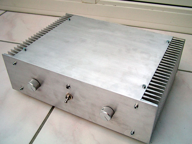

Right now, I'm still focused on speaker building after having completed various gear (pre amp, power amp, sub amp, sub, fullrange speakers). My CDP is very good, it's a Philips CD880. I found it for very, very cheap.
By the way: What DAC are you using and what kind of output stage did you use?
ps: My metalworking skills are limited, but still, I'm proud of my power amp:
Hi madscience
your amp is very goodlooking. I would have used some biggest and solid panels (at least for the front panel) ...but I know it's not easy to find thick aluminum!
I'm lucky to live close to some shipyards and you know, yatchs are made with every sort of exotic material (who can buy such thing can afford exotic materials!)

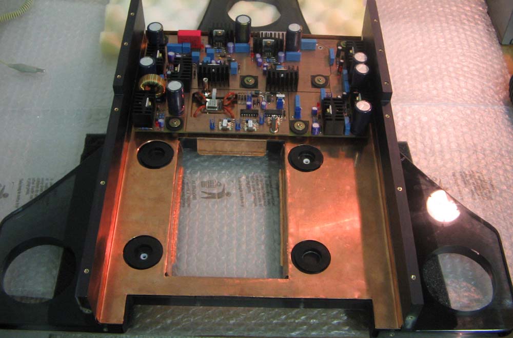

The analog out of my player is a kind of "service output"
so it's connected to the onboard akm dac (it has to arrive a diy dac, I already started the design!!)
More attention I give to the digital section of the circuit: a TentLabs XO directly feed the CD-PRO2M and the S/pdif reclocking section (D-Flip-Flop).
The digital connectors there are: XLR 110ohm, BNC 75ohm and RCA.
The player is extensively shielded: a copper foil underneath the main board, two copper boxes shield the delicate digital circuits and the noisy display and controller board.

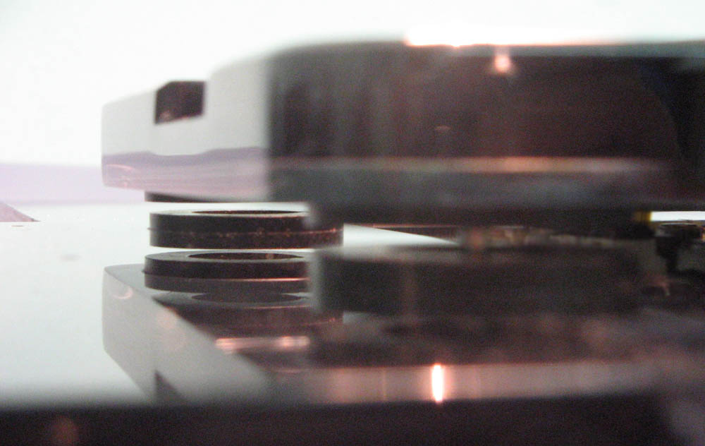

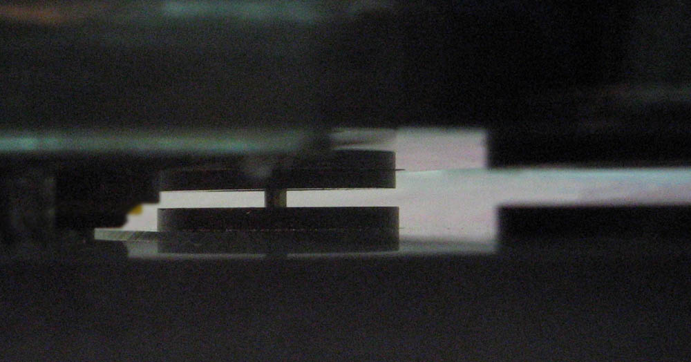

Give a look to the magnetical suspension:

But could you be more specific on the magnetic suspension?
What do i see floating?
How do you prevent is from sliding of the magneticfield?

Here is another picture of the cd-pro support.
Two iron axles in the center of two opposite magnets slide into teflon (bushes or bucklets)(sorry for my english!!)
In that way the support is free to move vertically, low frequency vibrations (the worse ones) are not transmitted by the axles (teflon is really effective!).
I tested it with a vibrating mobile phone and a stethoscope, the attenuation is huge! ...and if you add the action of the damping feet, it's almost silent!!
And now the interior whith the copper shield and the pcb mounted!

Here's another view.....
You can see:
- the laser pick-up, it's painted with army green mat paint, really effective to absorb laser spurious radiations
- the belt which drives the lid, this operation is controlled by a Microchip PIC expressly programmed ...another thing to deal with but it's too cool compared to the hand open ones
and it sounds as Robocop!
- the copper box that shields the display board
