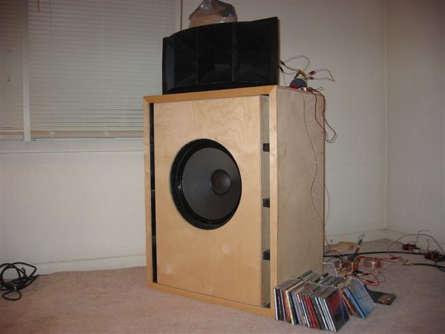

Here is one I built from double thickness of 19 mm baltic birch plywood and 416Z woofers. Altec MR902 drivers/511 Horns on top. Tuning around 40 Hz in a ~7 ft^3 box.
Tim
Tim
