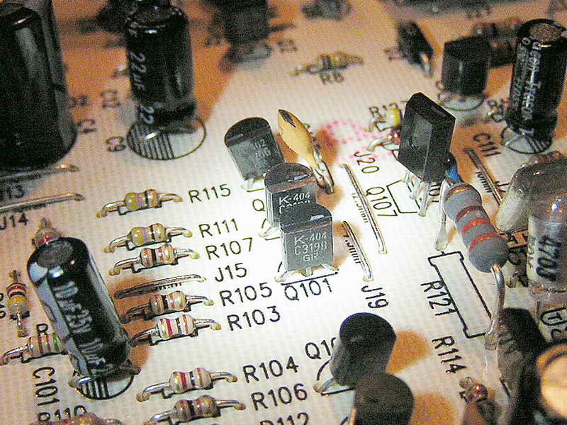

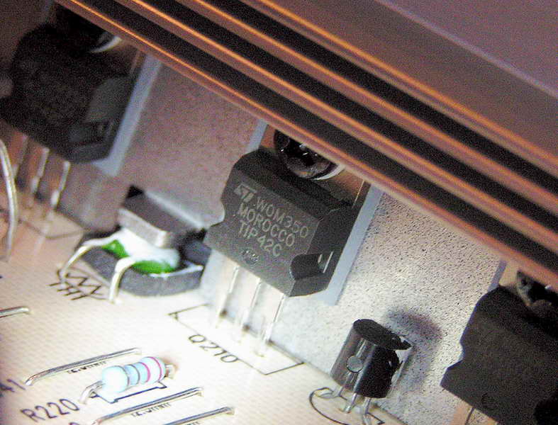

I bought this Accurian Powerline home amplifier from Radio Shack today. You are supposed to use it to transmit and receieve audio through your powerline. They clearenced it from $150 to $20, so I couldn't pass up the offer to listen to it. Anyway, when I got home I opened it up and noticed it is a rebadged ST&T iMicro 84. I removed the powerline receiver, and took pictures of the amp section. The toroid is 28v-0-28v, 2A. Anyone care to comment on the quality of this amp design?
Nice little amp, at 28V rails maybe 30w/channel with relays too but I don't think they are for speakers output. The TIP42Cs (power transistor) seem to be push to maximum mayde replacing with MJ15031 and it's complement will give better performance.
A BJT amp with 6800uF puffers and an 56V-CT mains trafo is able to produce 100W-RMS on 4ohm and 60W-RMS on 8ohm. But these output transistors wont survive a 4ohm speaker.
So that amp I think gives 60W on 8ohm, maybe 80W on 6ohm.

Nice internal layout
Internal layout is clean compared to other mass produced ones, even PCB looks decent and has torroid transformer too. I may get this one today. But it looks that this one is a good candidate for tweaking.
Sorry Carlos, I don't have a schematic, as this is a mass produced component. Maybe you could try e-mailing St&t (www.stt.com.tw), the maker of this amp. Some listening observations:
There is no center marking on the bass/treble knobs, and also no center detent on the pots. This makes it hard to tell if the bass and treble are flat. You can solve this by completely bypasing the front knobs and just using this as a straight amp.
There is a slight ground hum, and I'm trying to figure out why that is. For $20, this makes a perfect garage stereo/ outside amp. I agree, this amp could be easily modified to sound better.
