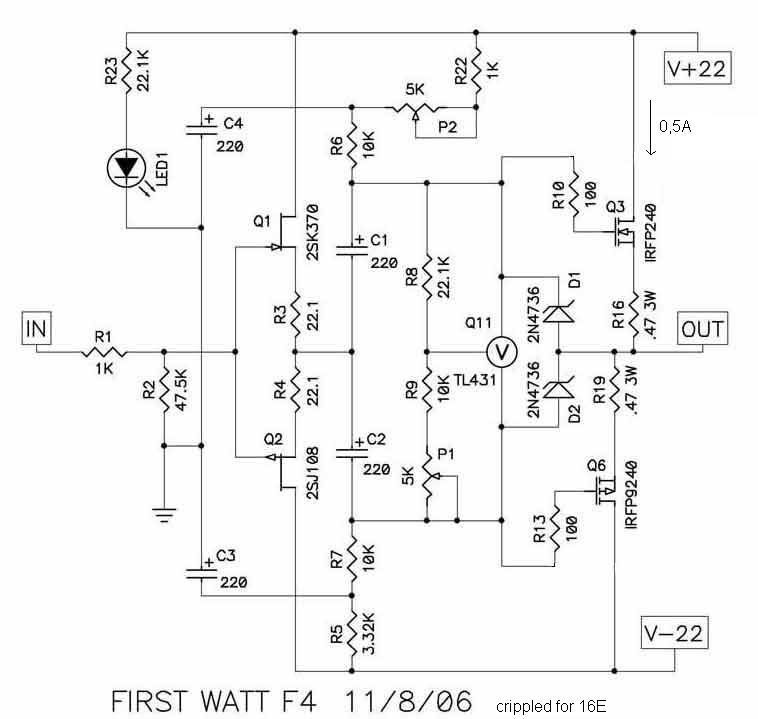

In an attempt to short circuit the inevitable questions:
--Yes, you can increase the bias as long as you have sufficient heat sinking/power supply/etc.
--Yes, you can decrease the bias.
--Yes, you can substitute the usual MOSFETs for the IRF outputs.
--Yes, you can substitute the input JFETs, but the field of candidates is much more limited.
--I don't have the datasheets for the input JFETs with me at the moment, but I don't think you're going to want to increase the rail voltage much. The outputs can take it, but the inputs can't. If someone knows where to find 100V low noise, complementary JFETs with reasonable current capability, I'm all ears.

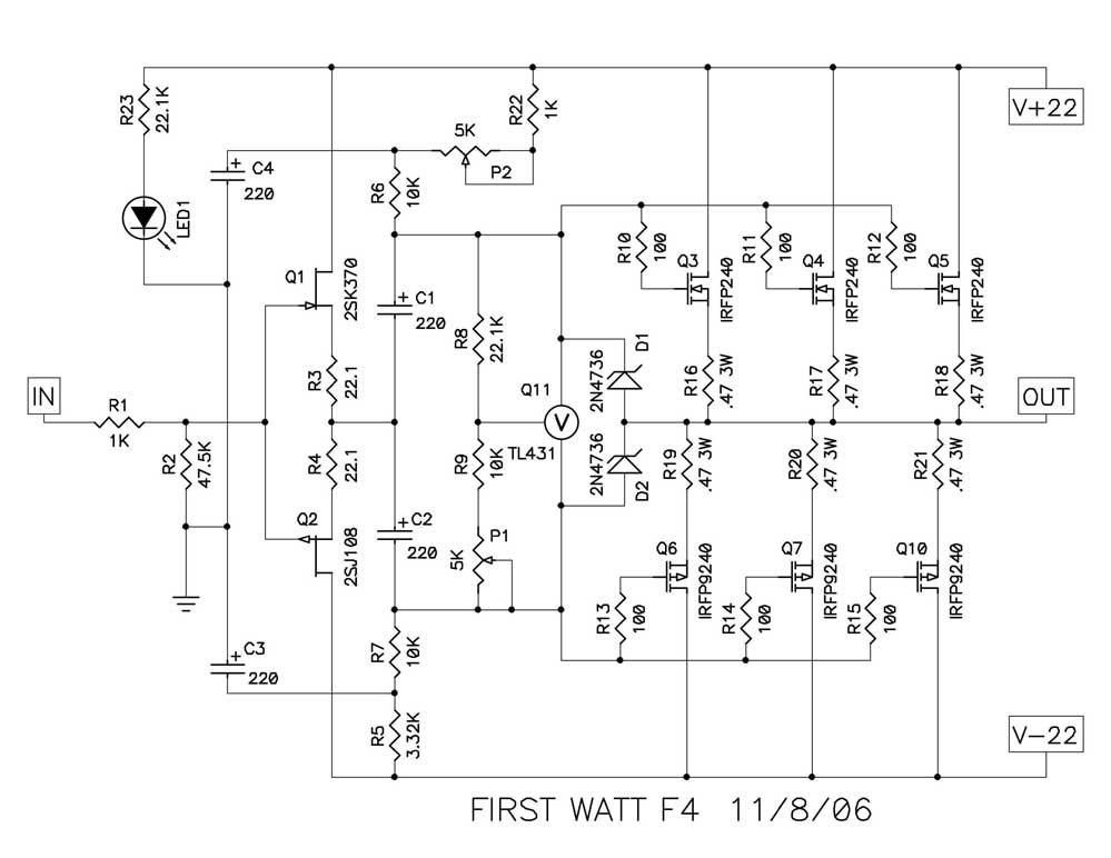

--Yes, you can decrease the number of output MOSFETs, but watch the heat dissipation per device.
--Yes, you can increase the number of output MOSFETs, but bandwidth and distortion will suffer as a result--though not fatally.

GRollins said:What'd I miss?

First stage (complementary JFET pair) is just an input buffer and it's not that critical. Any favourite low current buffer stage with appropriate voltage swing capability can be used.
I think that I would build F4 as na integrated amp, in the same box with Aleph L or Aleph P.
In that case the input JFET pair could be left out of the circuit.
2N4736 should probably be 1N4736 (6.8V 1W Zener)

I remember seeing a reference that the IRFP140 is a better complement to the IRFP9240 than is the IRFP240. Is this true? Would anyone have spare IRFP9240? I have spare IRFP140 I would like to trade off for 9240.
maybe we could help each other.
Amongst the guys that know jfets - Please don't be shy in suggesting suitable replacements (and hashing out which is best, and why). I am sure more than myself could benefit in how you come to the conclusions you come to.
heatsink on the jfet?
