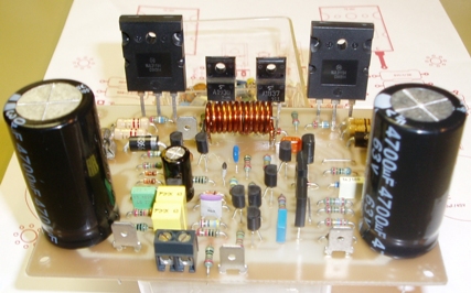

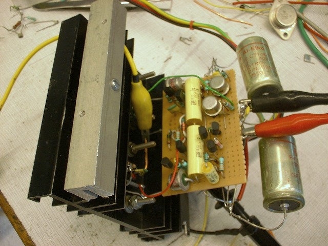

This is my latest prototype build prior finalizing CFP pcb layout. That axial metal case is a military spec tantalum capacitor used as feedback capacitor installed very casual way. You may see, TO220 schottkies have insulated with heat shrinkable tubing. This build carries BC556B/BC546B's and 2n5551's as small signal transistors, 2N5858 as bias servo, Philips BD140 as drivers, MJL21194 as power transistors.
I used a legendary Iskra 12K 1/2W resistor as feedback. Gain ratio kept as 12K/560R respecting original setting.

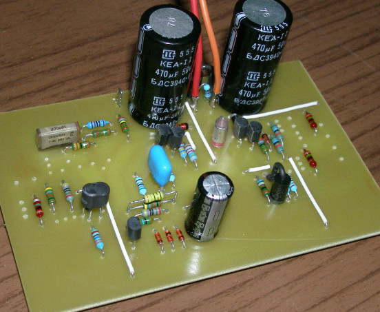

I am very interested by the Circlophone because having nothing to preset, just like the Quad 405, and because it is a very good way to recycle old devices. It also had good specs and nice reviews.
I started to extract the necessary components for my many junk-boxes. However, I did not find any 2N3019 for the Q5-Q6 pair. Being in Tours (France) yesterday, I went to this shop
Accueil - radioson, boutique en ligne de composants electroniques pour professionnels et particuliers, installe a blere (37)
where I have been proposed BSW68A (originated form Philips, I think). Looking at the datasheets, they seem adequate for the circuit. What do you think ?
Regards.
Regards.
The problem is the collector capacitance: 35pF is too much for the VAS.
Note that it would probably work, but there are many suitable alternatives more common than this one, like the 2N1893 for example.

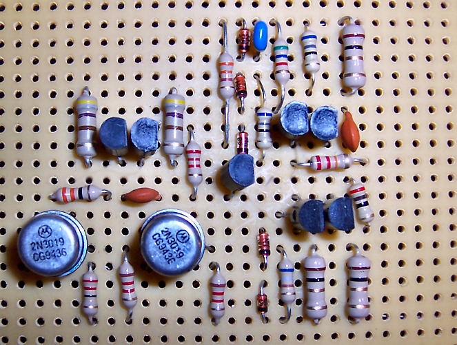

For VAS (Q5, Q6) a 2N3019 can be found almost anywhere as there are many makes of this still popular 1 watt NPN transistor. ST brand has close matching (but you might want to HFE match Motorola for QC). The large metal transistor is easier to cool than plastic alternatives.

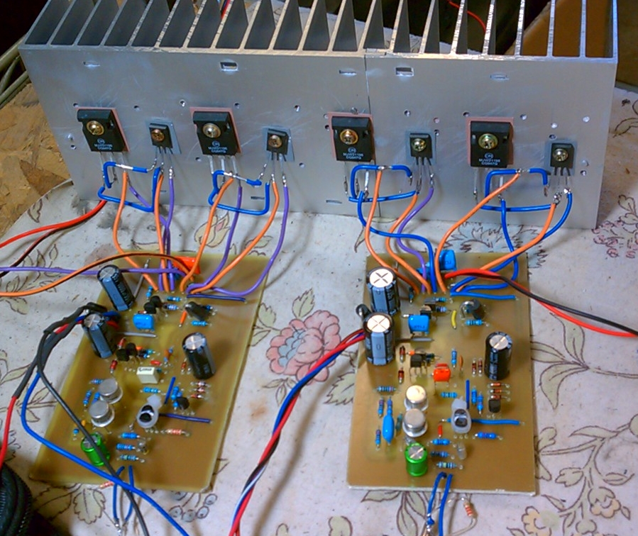

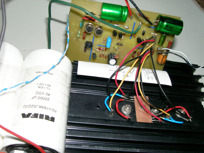

The dissipation is mostly comparable to that of more conventional class AB amplifiers.What size heatsinks are people using?
There are one or two minor differences: the quiescent power is typically 2 to 3 times larger than a normal AB amp, , but that is partly compensated by a better efficiency at high power.
For a 60W/ch amplifier used domestically, one is enough.I have a couple 260 x 100 x 40 high fins, use one or both?
If you build a higher power version, and you listen to heavily compressed music at high volume, you should use one per channel
With the sole clue being the voltage range of BD140. . .What size heatsinks are people using?
Getting nearer, boards populated apart from BD140's + heatsinks.
I guess 120w to 140w worth of class AB amplifier per each heatsink (much depending on other factors like thermal interface speed, quality of thermal materials, significant amplifier enclosure ventilation, added mounting brackets, etc. . .).
So, 1 heatsink for stereo amp with 8 ohm speakers or 2 heatsinks if 4 ohm speakers.
