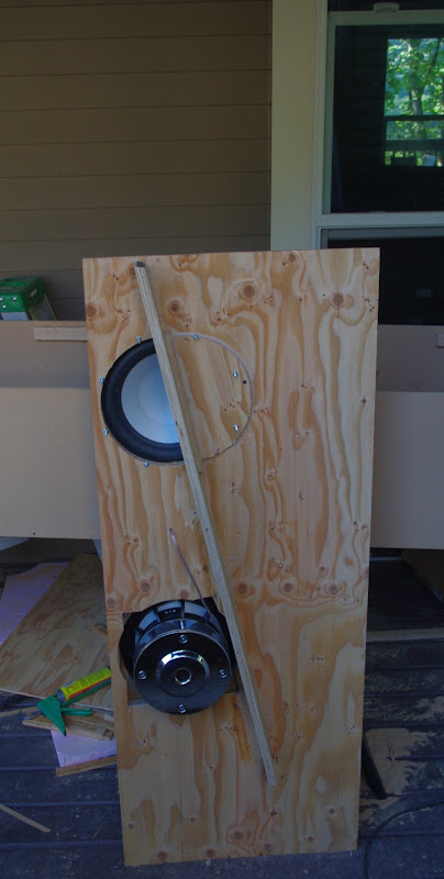

Here's some pics.
Here's a pic of the woofers. That horizontal piece of wood isn't just a brace, it also forms part of the horn path.

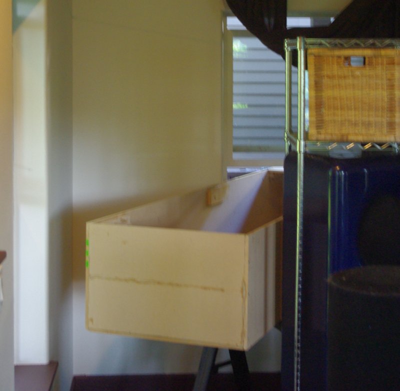

The limiting factor on the horn's size was the entrance to the house! I couldn't use the front door because there's a ninety degree bend, and the horn's too big to make it. So I built it so that it would fit through the window of the living room.
My Summas are about three feet tall, so this gives you some idea of how big this tapped horn is.
